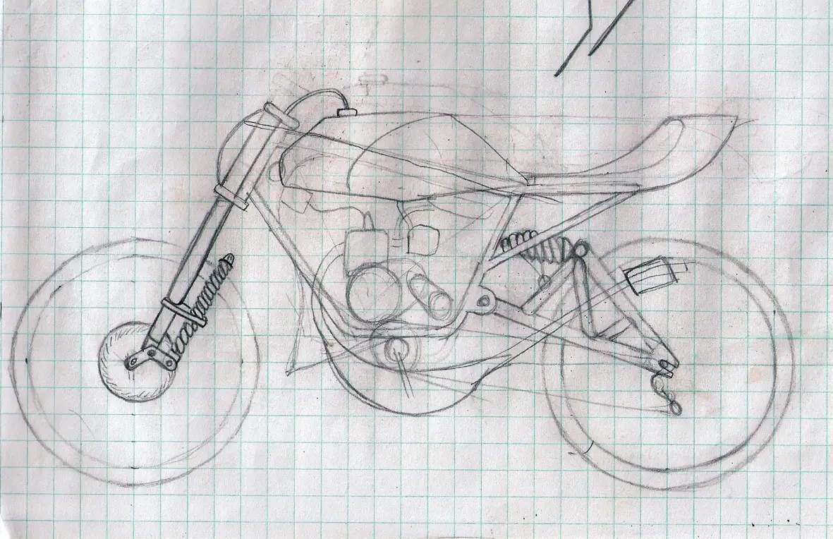

So ive been sketching out the design and working on the forks. My camera batteries just died, so ill post a pic of how the forks are coming along later tonight. Here is a sketch of what it should look like. Im still toying with the idea of using and old cruiser frame so it blends board track and street track.

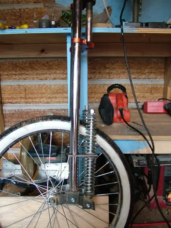

So iv gotten some work done on the springer. Still needs to have the plate where the springs rest welded up, but over all seem like its going to work well. Then ill be doing some cosmetic refining to make it looked more machined, kind of rat right now but will be just peachy when done.
