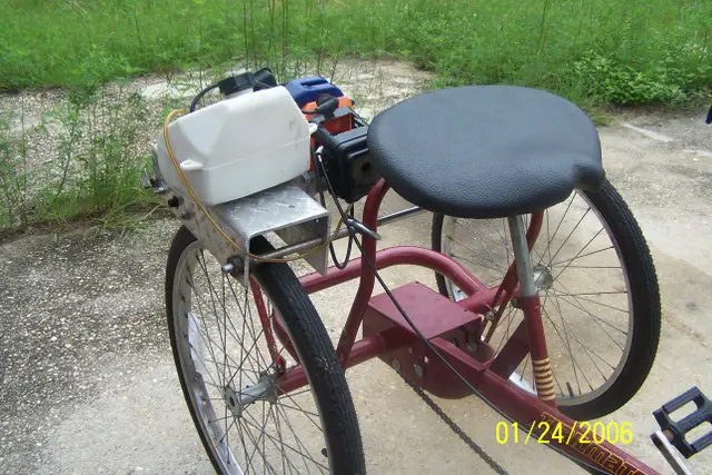

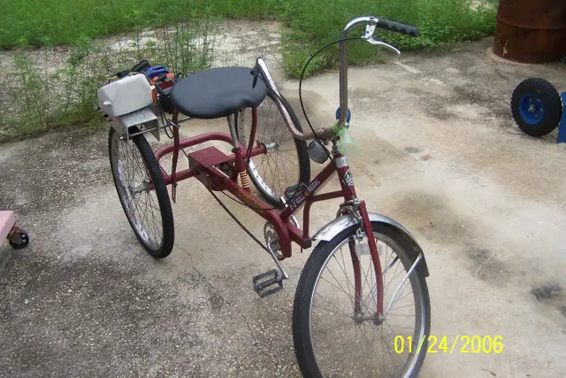

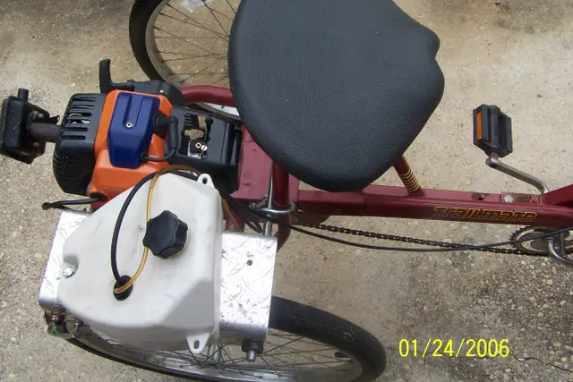

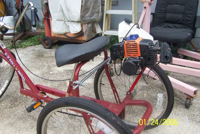

Fred, I Threw A Friction Drive Trike Together In A Hurry. I Started With Friction Drives. They Have Their Advantages And Are Mostly Trouble Free. I Never Had A Flat, But Did Not Ride A Lot Of Miles. I Made My Own Mounts Back Then. "bikemotorparts.com" Has A Scratch And Dent Sale. I Would Use 49cc Engine. A Titan 4 Stroke Would Bolt Up. I just clamped a 1/2" dura rod to seat post`s and used a coupe shaft collars to hold mount in place. it worked very well. hope this helps. i don`t think you lose much top speed with a friction drive. Ron .

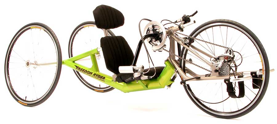

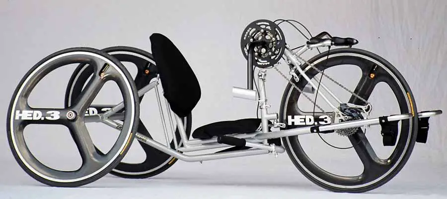

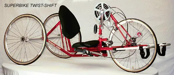

I too have thought about motorizing a trike, I think I found the one I would like to start with... Maybe dual electric hub motors?!
Those make my arms sore just looking at them...but what a cool motortrike any of them would make. I'd bet those are some high dollar machines. Keep us posted, please.
