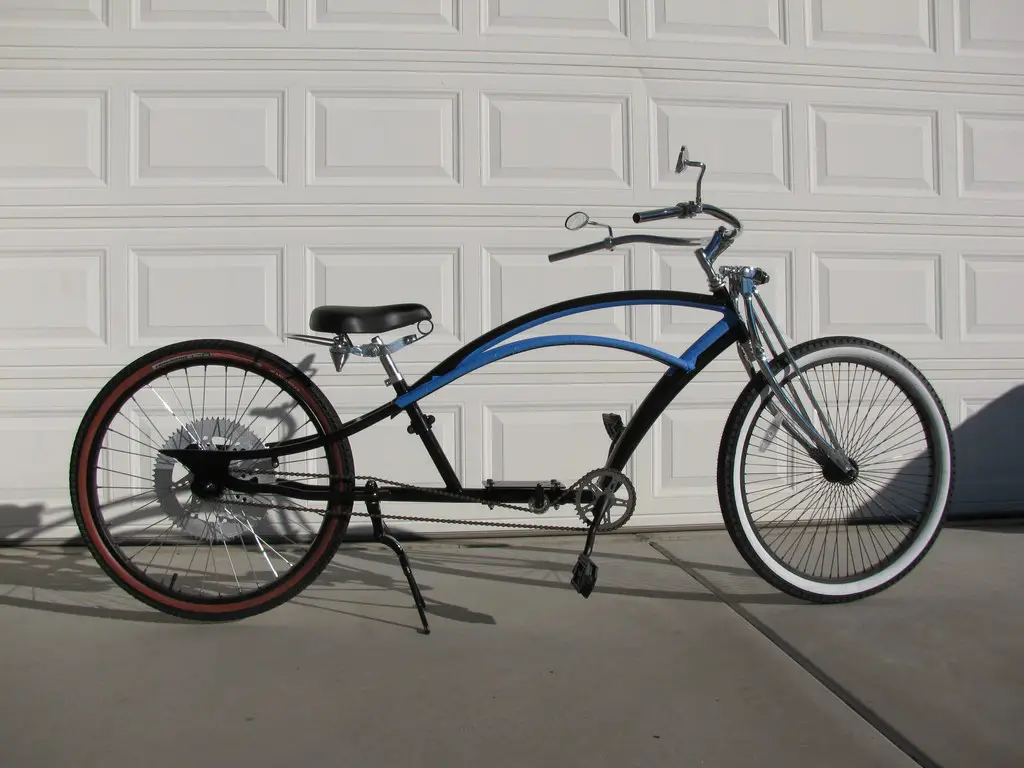

a few people have asked for pics of my not-finished-yet stretch
the bike is a Micargi Mustang GTS (x-mas present)
I am still mid build and am waiting for an in-frame tank---azvinnie (my son-in-law) is making it (his first time making one) the tape is to protect paint during tank fitting
I have a budget of 0$, so am making it with what I have available
(I sold a back wheel and other parts to finance the sprocket/adapter I got from Jim -- thanks Elmo)
I am doing a lot of measuring to get everything ready for the drive train swap from my Jaguar
(I need a bike Mon-Fri to take oldest grandkid to school, so I need to be up n running quickly)
1st pic is full side view showing whole bike

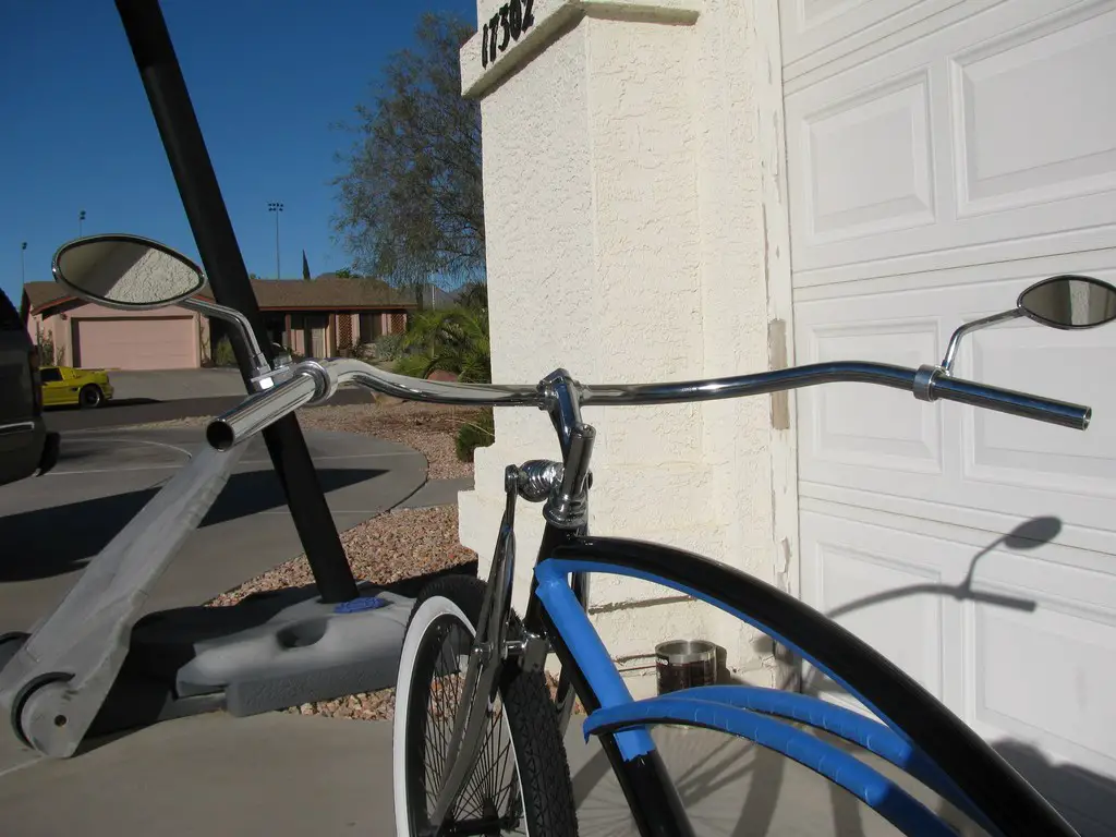

2nd pic showing Jim's sprocket (72T) and hd coaster wheel (12ga spokes)

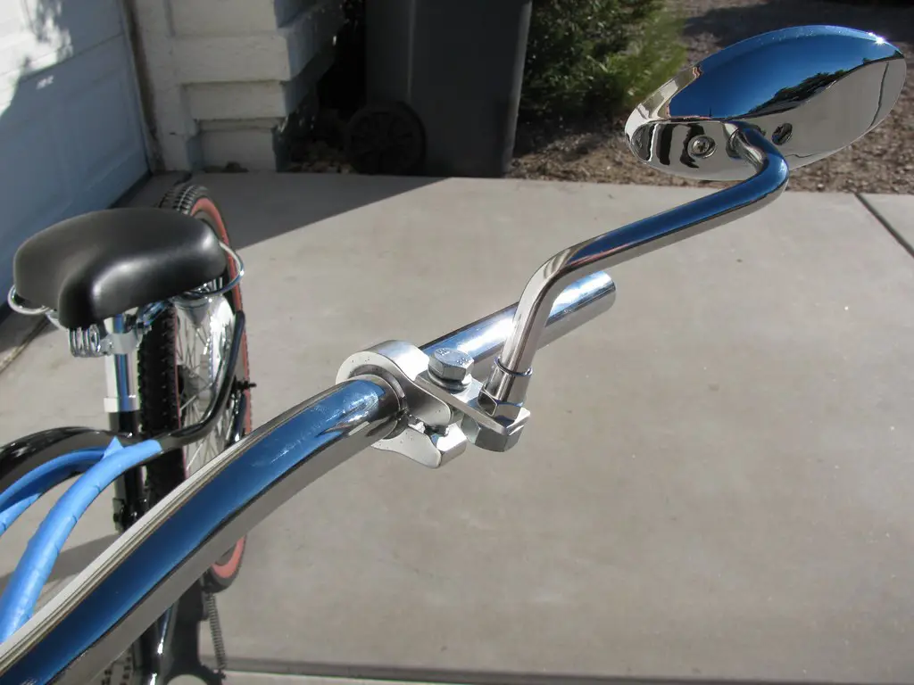

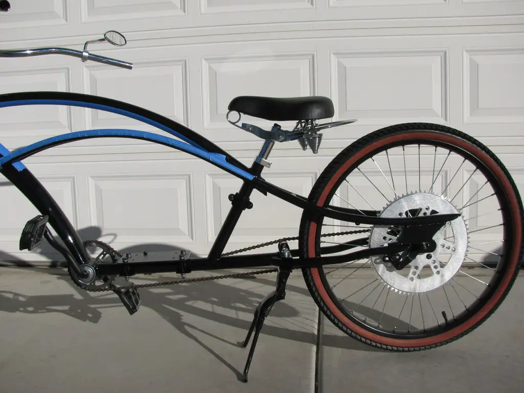

3rd + 4th pic are MC mirrors I got on the bay and the seat post clamps I used to mount the mirrors

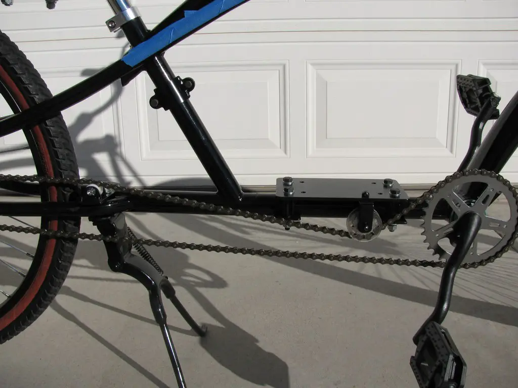

5th pic shows motor mount and pedal chain routing
I changed pedal sprocket to a 36T to make it easy to pedal with the girls/trailer, and routed chain under engine to lower the center of gravity (ie...better handling)
the motor mount is clamped to bottom tube with tensioner brackets and exhaust clamp saddles
the bracket on the seat post is to stabilize the engine/trans from side-to-side twist (bracket comes from an old seat post mounted rack)
