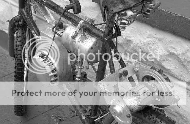

HI TO ALL, I DON`T SEE MUCH POSTED ABOUT FRICTION DRIVES. In 1951 the nabor and I built me a motor bike, 3/4 hp briggs & straton. I BOUGHT MY FIRST CYCLE IN 1955, 1936 HARLEY 80 CUBIC IN. FLATHEAD. I WASN`T AWARE HOW FAR THE MOTOR BIKES HAVE CAME UNTIL THE FIRST OF THIS MONTH. I ENJOY THE FORUM. VERY HELPFUL !! LATER GUYS, RON
