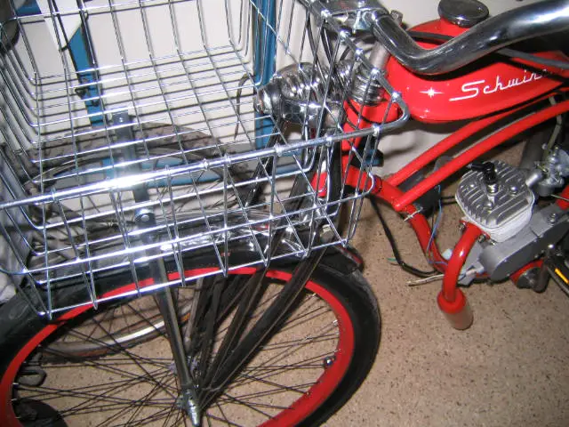

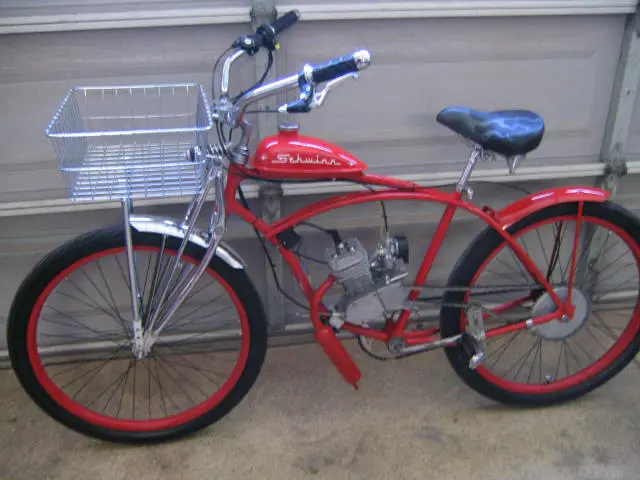

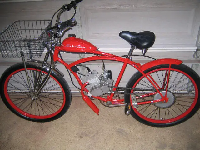

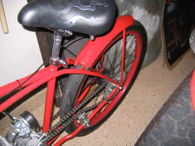

I am having hard time with picture downloads. So i hopefully attached pictures. Clueless to this system. Anyway. this is a 1980 schwinn cruiser frame. stock bottom crank and bearings, cheepo springer front end in good shape that I got with bike, nexus 3 speed hub with electra rims and flame pattern tires. Custom cut front and rear schwinn fenders. Custom made delron motor mounts. I sand blasted parts before shooting mars red auto paint. New bars, seat, basket, and hub shifter. 80cc motor kit. added shims on both sides of rear hub to help chain clear frame. replaced mounting studs with hardened. Am toying with 1.5v led lights in parallel for tail and running lights with 6v r/c car battery under seat to back up charging system. Not sure if i can hook up battery direct without it getting overcharged. Hey, if by seat gets hot, I guess i will figure it out.

Delron is like nylon, but harder. Its what the gears in a lot of cordless drills are made of. I got a 1 inch by 10 by 20inch sheet of it from when i worked in robottics. I cut a 1 by 1 1/4 strip. then cut two pieces and drilled them for studs. I needed more clearance from sprocket. I groved front mount to fit frame tube. added longer hardened studs. then drilled and tapped long 1/4 inch bolt thrue rear clamp, and tapped it into rear alloy mount for more support. replaced nuts with hardened, and doubled up on them. The delron wont reduce that much vibration, but hopefully enough to save studs and frame welds.
