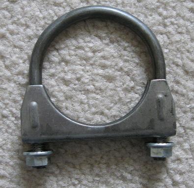

I am curious to know if anyone has had success using Exhaust Clamps to directly mount the front and rear of a 2-Stroke motor in your frame?
They come in all different sizes but probably would require to drill the clamp part to match the engines mounting areas..
Would it work? Any input,I'd appreciate it! Thanks

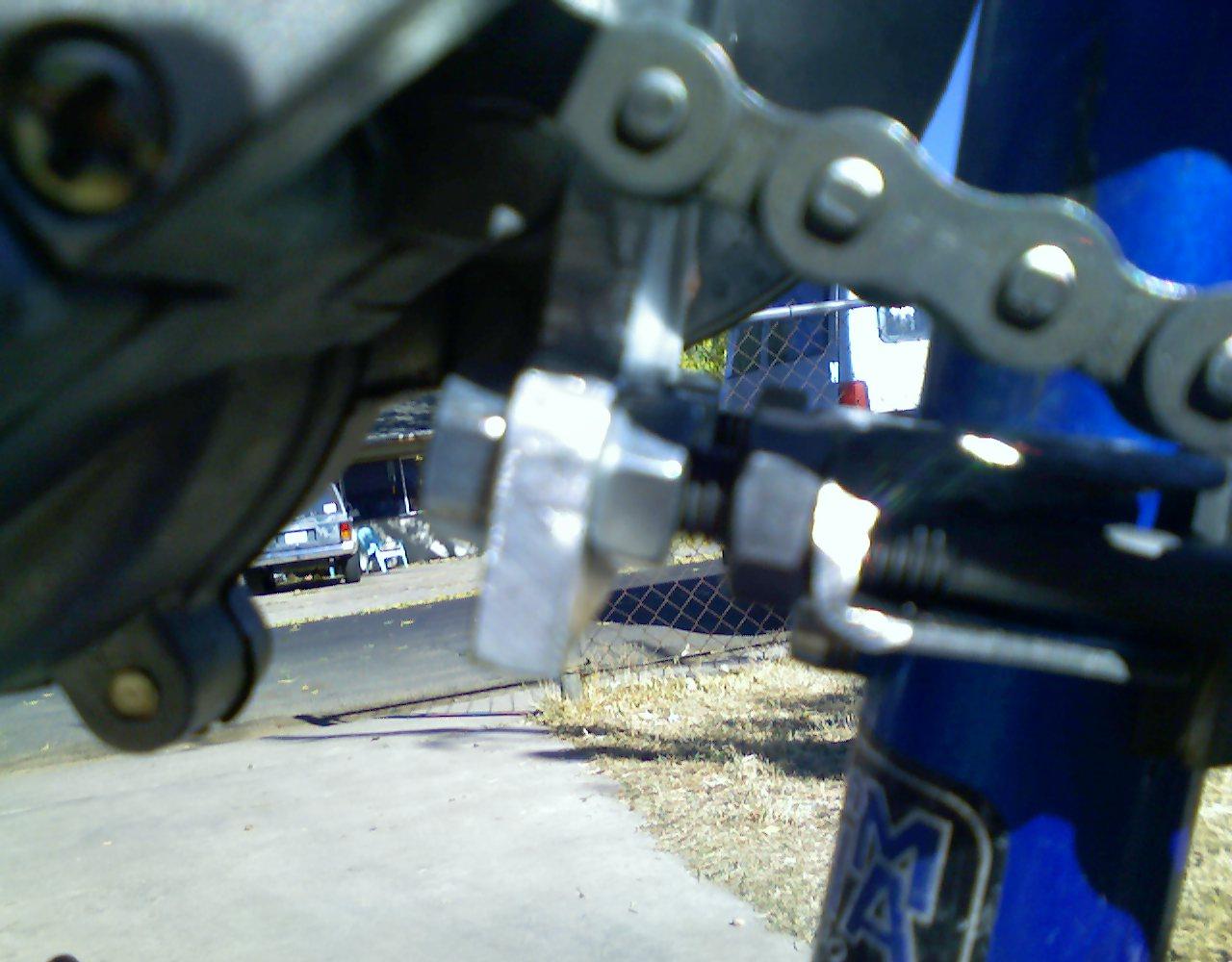

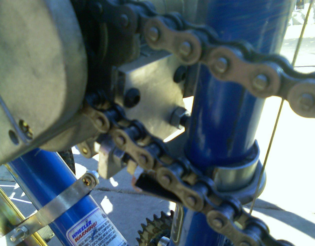

I made this mount with a muffler clamp and some high grade hardware into the engine. I have a couple hundred miles on it and no problems at all. Never even had to re torque and those are some miles on rough dirt roads and some air time!
I did use some steel to help distribute the presure to the seat post tube(chromo frame) and a piece of heater hose to help a little with vibration.
I also am a firm believer in eye protection!
I also avoid using my Dremel ,or any rotary tool for that matter, when ever possible, I made my cuts on this piece of thick aluminum with a sawsall (piece clamped to work table of course). Files and jig saws work just fine for finish shaping on aluminum and they dont create shrapnel so easy!-
