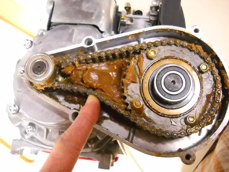

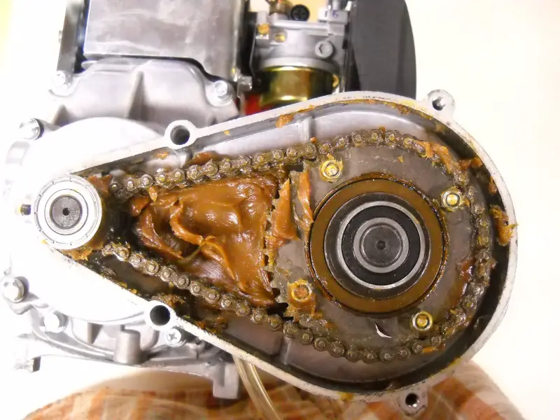

ok, so the $199 4stroke motorkit arrived today. good.
but here's what i'm facing:
once this chain loosens up, its going to start breaking teeth. not good. as you can see in the 2nd pic, its already on the loose side. and it hasnt been run yet.
someone told me theres a post or thread where someone has installed a spring loaded tensioner inside the casing.....does that sound familiar to anyone? i am unable to find it.
if you follow the tip of my finger to just under the top chain, thats the farthest forward of the casing anything to mount one can be drilled, before you get into other stuff.
i may be able to drill a slot (to adjust up or down) in the back, and run a regular roller bearing wheel

take out a link?

Problem is that Tsubaki, the strongest chain maker, rates their #25 chain at well under 2 hp. Doesn't it seem a little odd to drive a #41 chain w/ a little sewing machine chain. I mean I know your trading speed for torque and all but.... I have one of those w/ a cracked cover that anyone who wants to pay shipping for it can have. That is literally the only motorbicycle part I've ever been afraid to run!
http://www.ustsubaki.com/general_cd/...rs25-rs240.pdf
note that A,B and C are different lubrication systems if my memeory serves me correctly A is occasional lube B is oilbath and C is an oil lubing system that squirts or sprays oil onto the chain.
