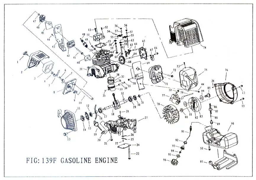

Is this the motor on your livefastmotor kit?
It ain't a 49 cc Huasheng, it's a copy of a Honda GX 31
http://livefastmotors.com/49cc-Chain...cycle-Kit.html
