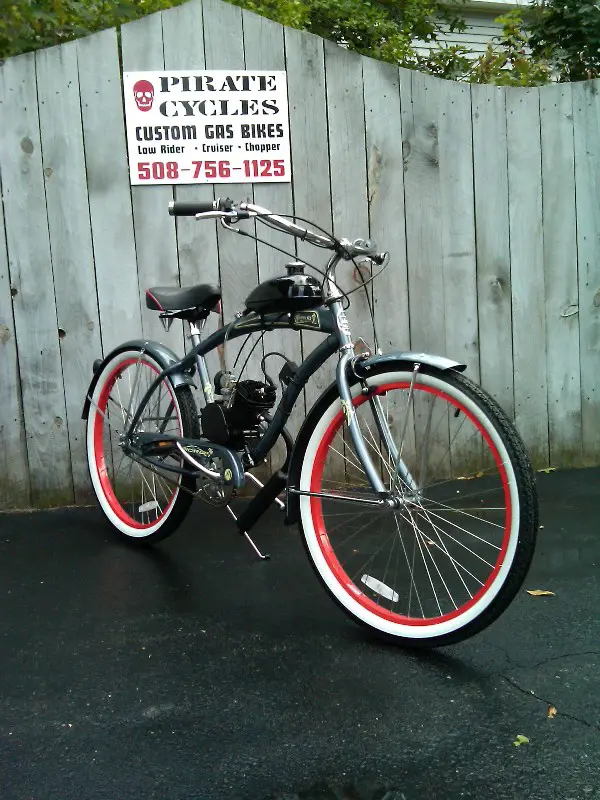

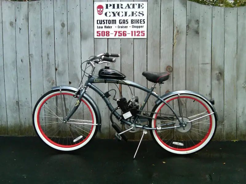

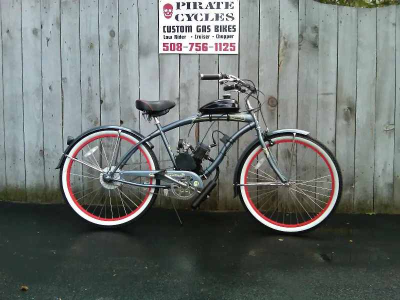

Xiodinc,
Heres that bike motorized for ya.. It is available in Green, Black, Grey, White, Silver, and Matte Black.
Unfortunately, you will need to do some mods to the front mount to get the Grubee Skyhawk to fit on this bikes larger down tube.
Another option is to purchase one of our our drilless front mounts to accommodate the difference in down tube to front mount size. You could make one if you have the proper tools as well.
The mounts on our PK motors are a bit larger and need no modifications. Thats what we used on the bike shown in the picture.
The kit supplied sprocket works as good as it does on this wheel.. Taco is just saying our adapter is designed for the micargi coaster brake wheel if you wanted to upgrade to it.

Good luck and let us know if we can help!
