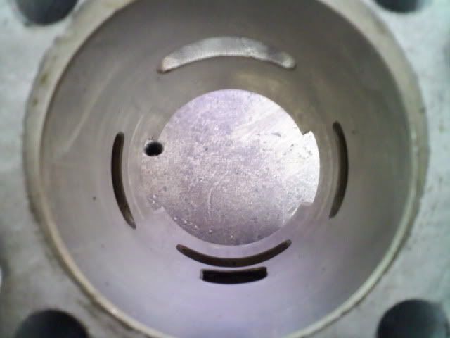

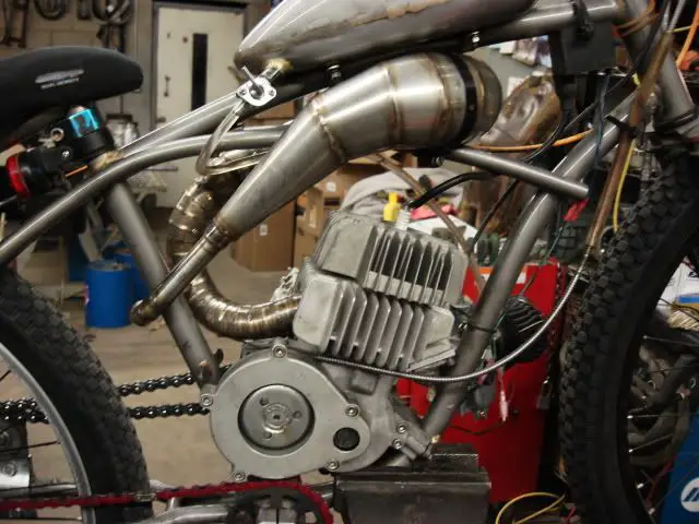

i thought i would start a new thread about cylinder kits that fit the chinese bottom end with modifications, and all of the associated tricks in assembly and tuning that i have personally tried, and maybe some advice on some things i haven't. i don't even know where to start, so there probably wont be any coherence unless you ask questions.
puch 65cc massive port kit
puch gilardoni 74cc cylinder reed kit

who knows? mine made 5 at the rear wheel.

so that franken crist motor you built each one would need a kustom pipe but i dont have a tig

so can you post more pics i think we all need to see more of that thing

puch 80cc metrakit large port kit
That would be my choice of cylinder Kit.
And the bore is the right Diameter.
What is the stud size and bolt pattern thats what i want to know.

REEDS! they are very important for a fixed gear bike, since you cant slip the clutch to get going. all the kits come with a piston, most of which have a 12mm wristpin, so you can smash that crappy chinese piston with a hammer. our motors have a 10mm, so your rod will need to be bushed and reamed to 12mm. you have quite a variety of moped pipes to choose from, some of which may work very well, but i build everything i can so i have no personal experience.
i still have stock timing and have no immediate plans to change it.
