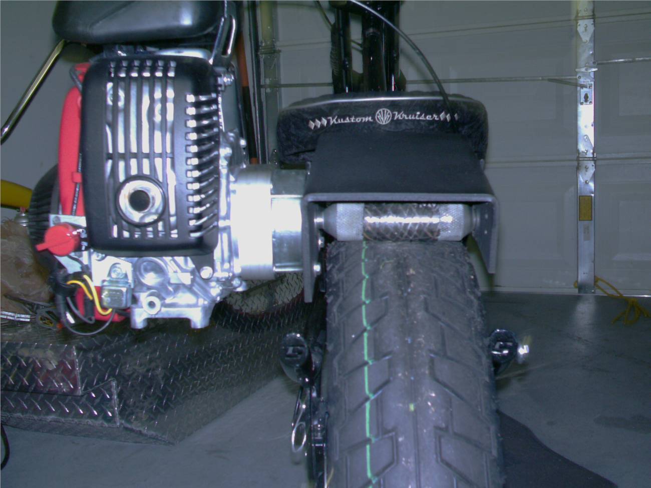

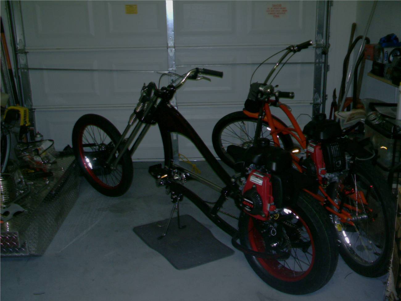

Hey, hows it goin! Here's what me and a couple of friends came up with for my rear fat boy tire & chain clearance problem for my Spoiler. It came out pretty good but the bike is heavy and I'm getting around 30 + mph. My friction drive KK Slick Daddy w/the same engine is 45 to 50 mph!:ride

They Look Great And Safe! After 35 Mph On Regular Bike My Test Drivers Get Nervous And Tense Up AND Sort Of Go Into A Bit Of Speed Wobble AND I NOTICED BAD PUCKER MARKS ON THE SEAT !! I GOT MY LARGE SOFA SEAT TODAY, WITH THE VENT SLOT DOWN THE MIDDLE, THEY WON`T FIND ANY MARKS FROM THIS MUG!
