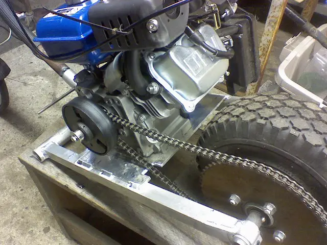

My HF went to this project after the Sun Atlas frame mount. My friend George had the tire and sprocket around his shop. #35 chain and a max torgue clutch. 29 MPH and it would climb at 20 mph until the fuel ran out. Great project don't know what your expectations are for speed but 30 is fast for a pusher, I'm on the slower side. Did I just say that.
