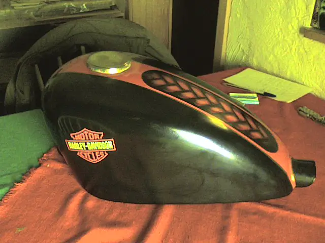

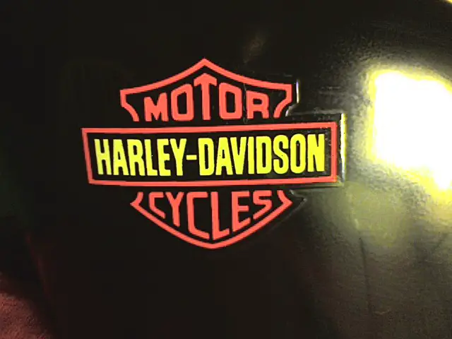

Putting my money where my mouth is.

I might give it a shot... but I planned on painting the tank black first... if the decal is transparent on a printer it probably won't work... guess its worth a shot. You painted the harley decals yourself kip? nice stuff... but im not skilled with a brush enough to even try doing that!

I would love to take credit, but no those are after market decals. I have made decals however but don't have pics to prove that. This was a beat up chopper tank that I refinished. I did the airbrush and paint work. The decals are under a couple coats of clear coat. I wanted to show that decals can be used to good effect.
