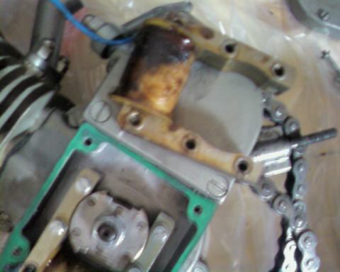

So right before i left for Syracuse, i rode my bike in pouring rain at night no light and she died
i only had one day to try and fix her cause i was living so i tried new fuel, spark plug and nothing
so i opened up the cover for the magneto and it was filled with water, not good. So i figured that must be it. When i checked for spark, it would spark randomly not consistent and then it stopped. So I;m in maine and just hunted down my motor, which was lost in a move and just replaced the magneto. Hopefully this will fix it
Thats what the old magneto looked like, and the new one is in

Beak,
You're probably on the right track. Electrical things and water typically don't get along. Replace the mag and let us know what happens. By the way; your old mag will probably be okay after it has had a chance to dry out as long as the wires are still soldered and no arcing took place that would cause a short or shunt. Keep it warm and dry and give it a try in a week or so. In addition you might want to consider sealing the magneto cover and the wire exit hole with a good silicone sealer. That will prevent a reoccurence.

yeah thanks tom
its been like 3 months since it originally happened, this is the first time ive had my motor since it happened. So it might not have been necessary to switch it, oh well i had a spare lying around. As soon as i can test it i;ll let you know

you going to throw the old mag coil away? I'd like to try rewinding it if you do. I'll pay for shipping PM me if you decide to toss it.
I have an extra mag coil but it works I don't want to destroy one that works.
It will give it up for mad scientist work.
