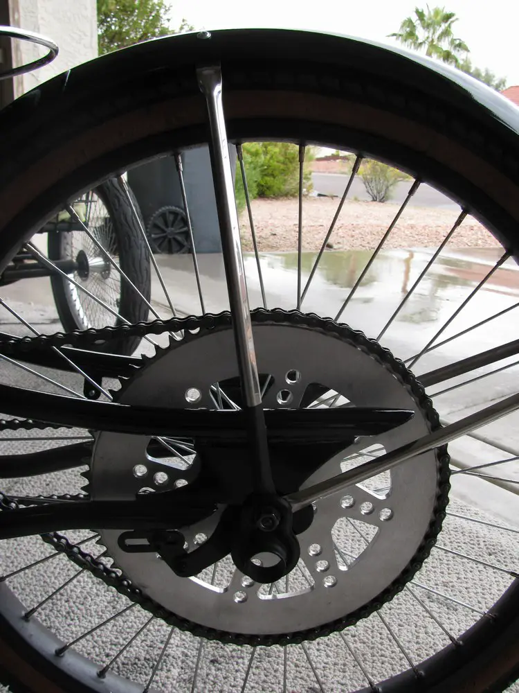

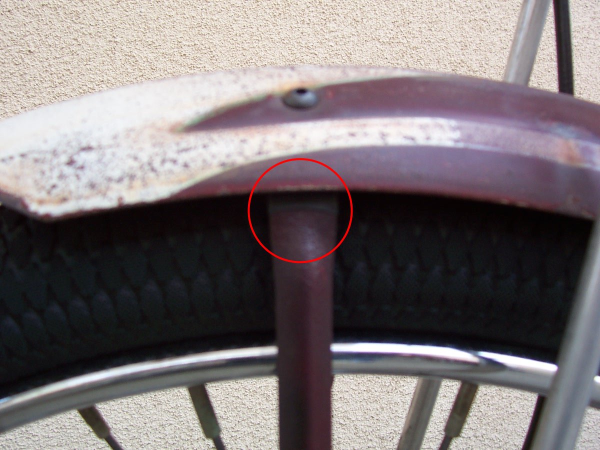

now that you have the fender struts off, slip some heat shrink tubing (usually 1/2" fits) on, and slide it up to the middle, and shrink it on there. (PIC 1) poke some holes for the bolts with a phillips screwdriver or something.
this gives you a rubberized, non-slip contact surface, and is probably the best tip for dampening the vibration.

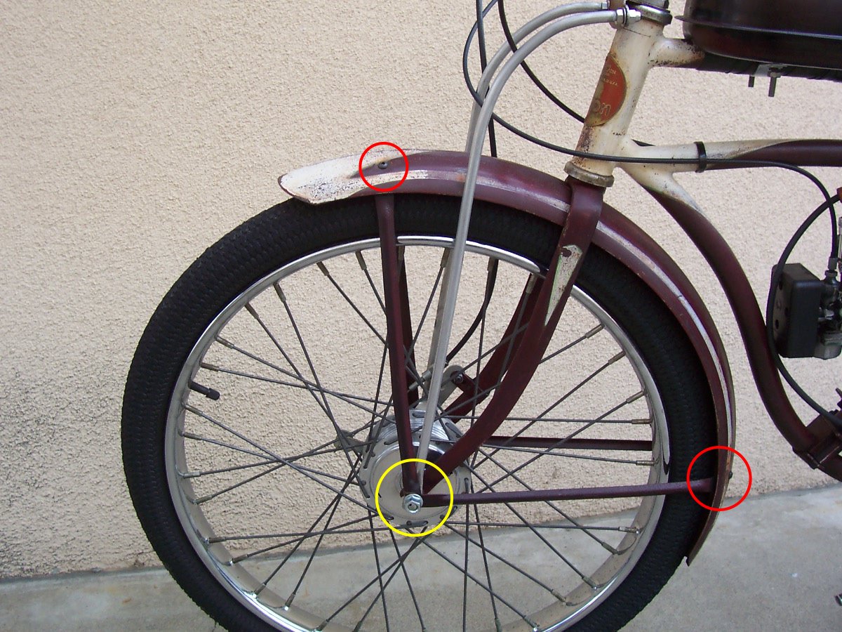

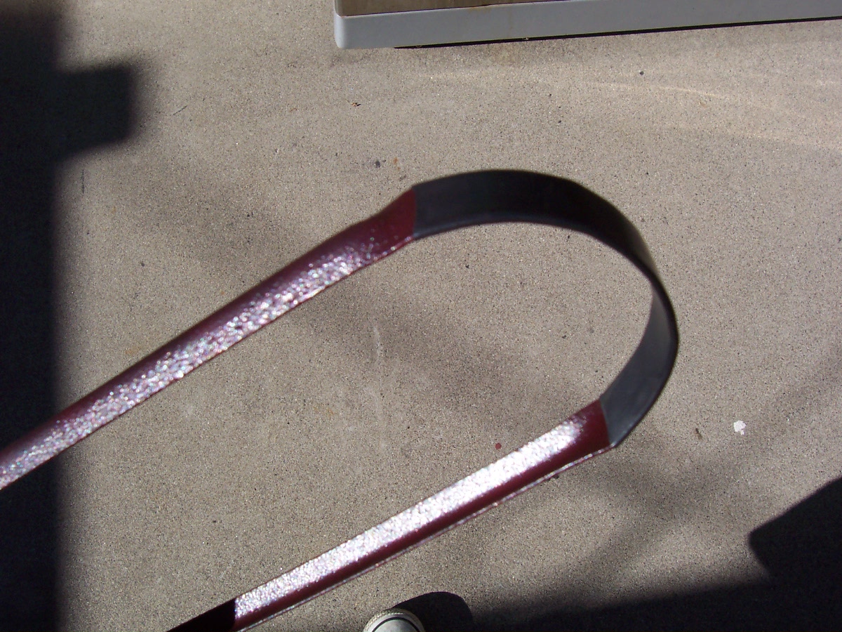

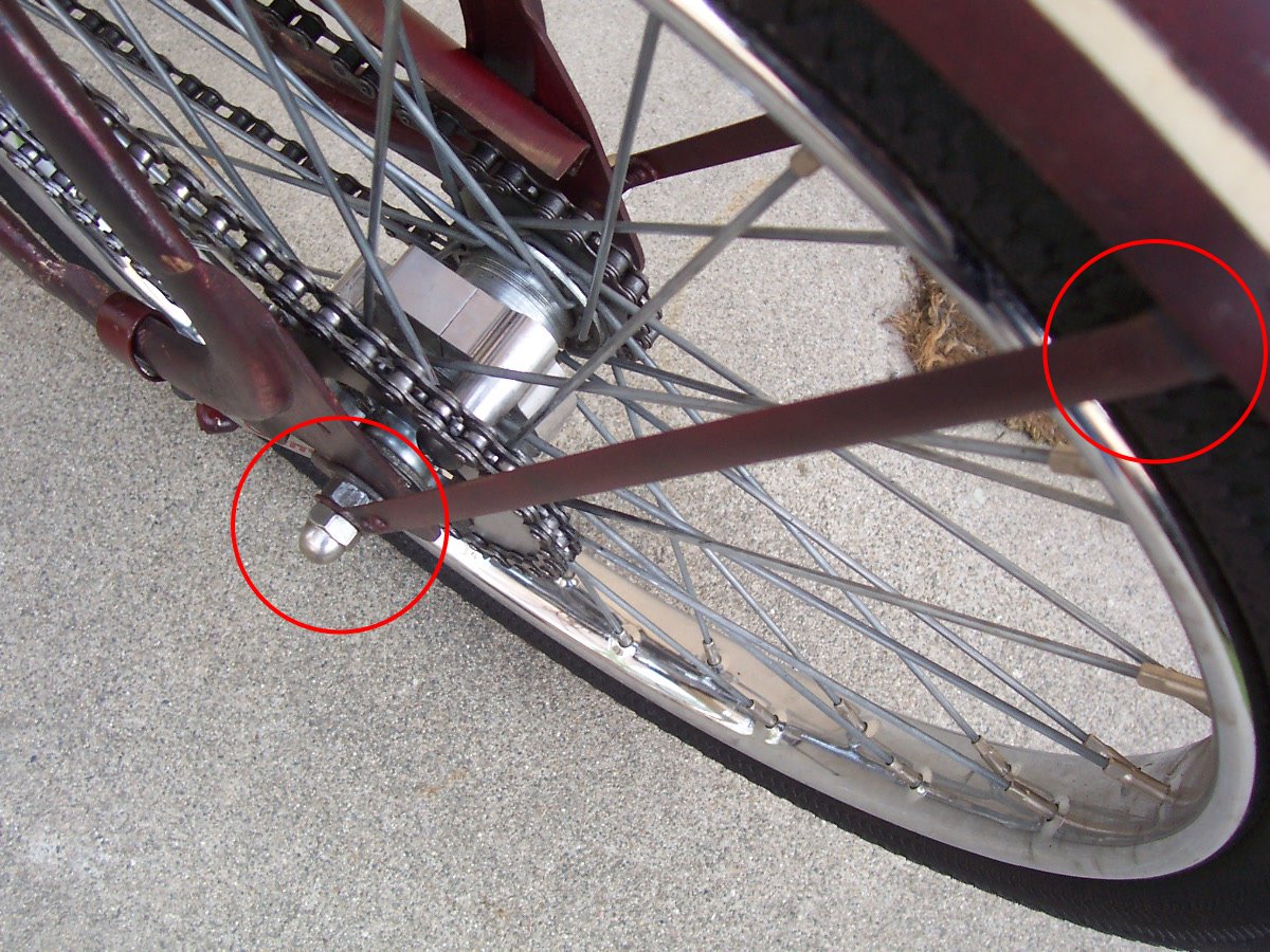

replace the struts with some good bolts, washers, and nylock lock nuts. i use black,grade 8 button head allen bolts, just because they look cool. (PIC 2 you can see the heat shrink sticking out, and PIC 3)

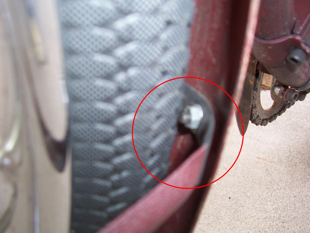

what's always bugged me about mounting fenders to the axles, is that the strut is so flimsy, it gets bent, chewed up, and there's a cheap piece of tin coming between the solid steel of my forks, and an axle nut. it just seems like a weak link to me. plus, old bikes like mine have strut rods (PIC 4) and having all this stuff held on by my axle nuts bugs me.

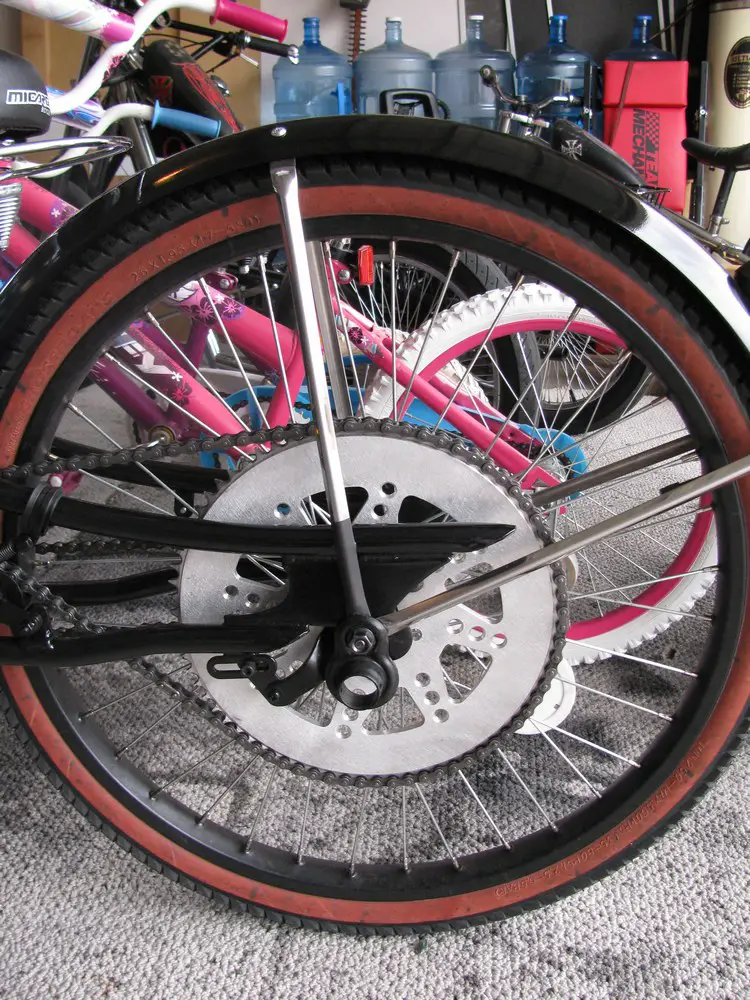

if your lucky, you have long enough axles, and you can do like i do (PIC 5.)

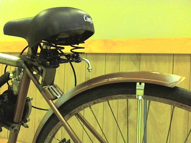

Great post and it reaffirms some thoughts I had arrived at on my own. Now I don't feel quite so unsure about implementing them. I am thinking about doing brazing rather than using nuts and bolts but the outcome is the same, no rivets. The one rivet on the back fender is already removed. Thanks for posting.
