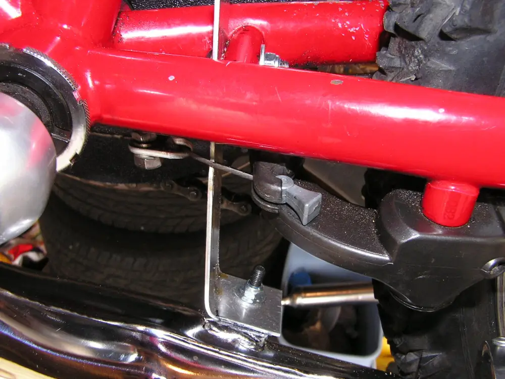

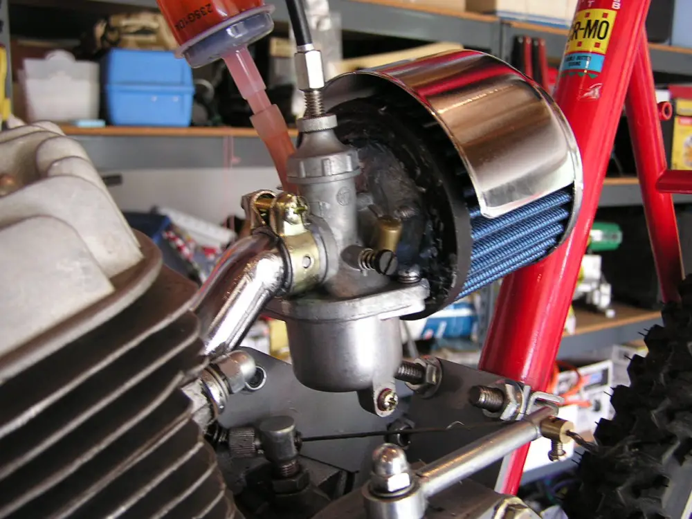

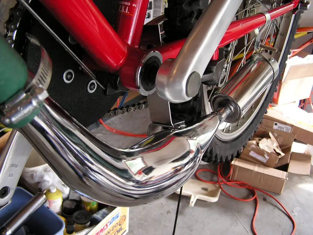

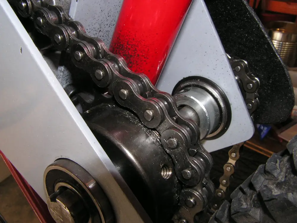

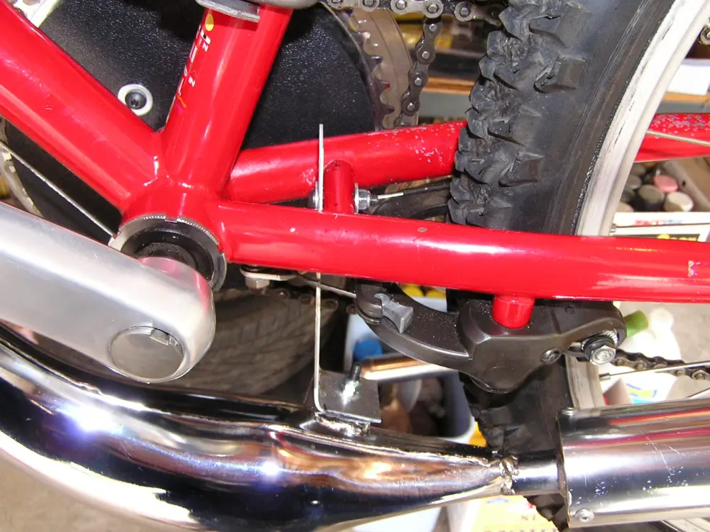

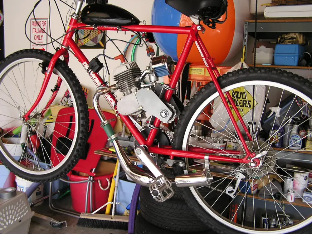

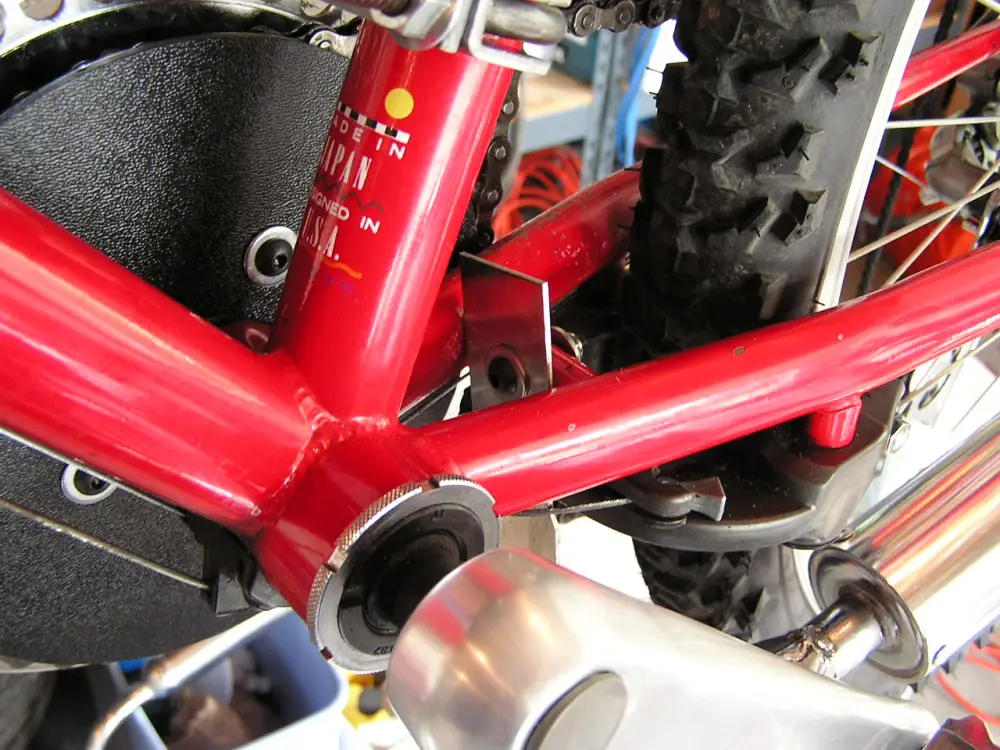

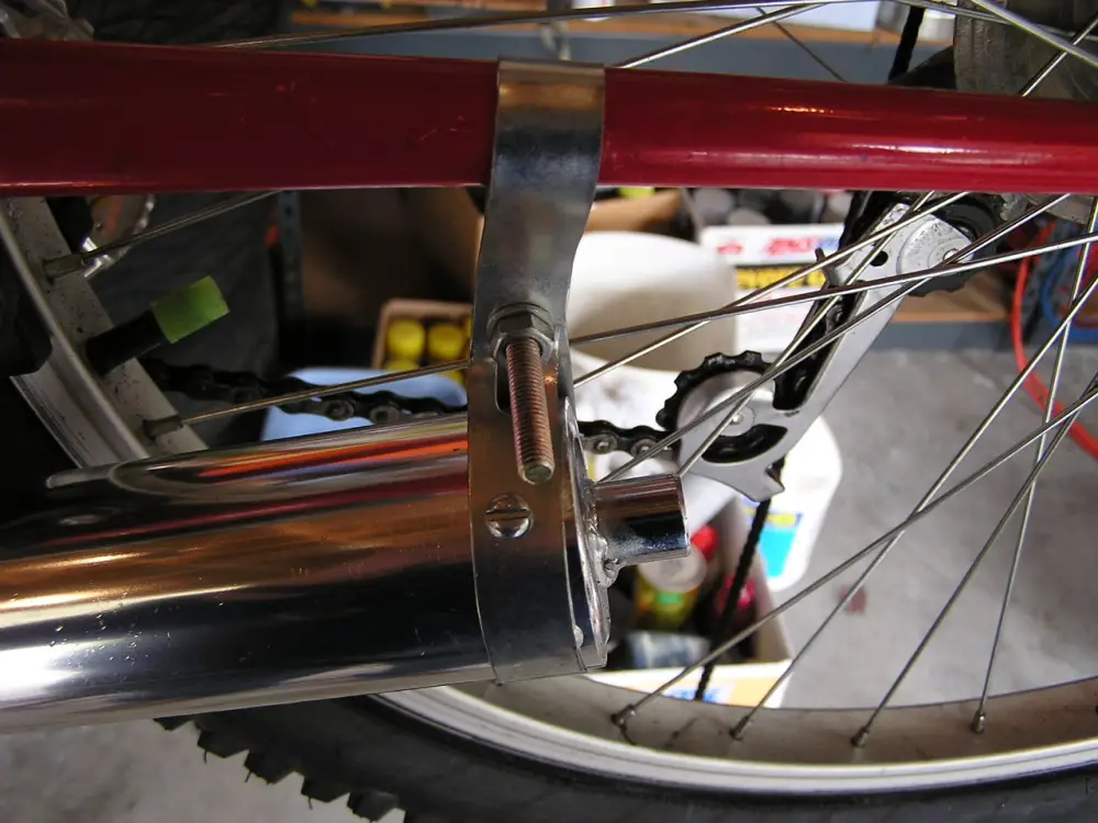

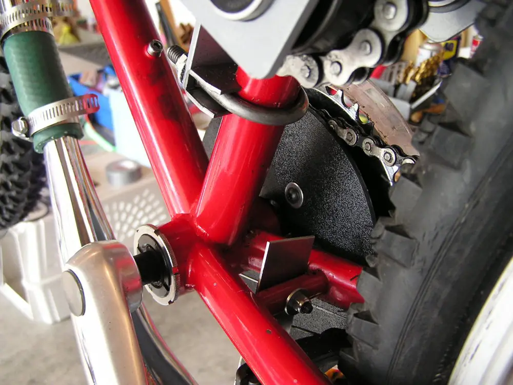

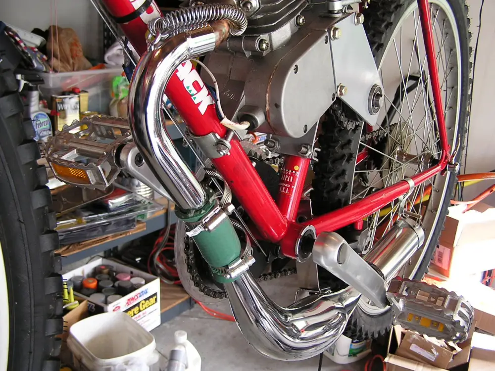

Took some shots today: (redid file upload)

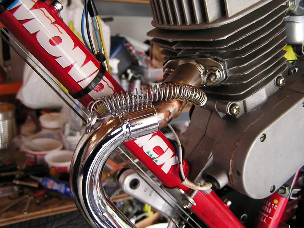

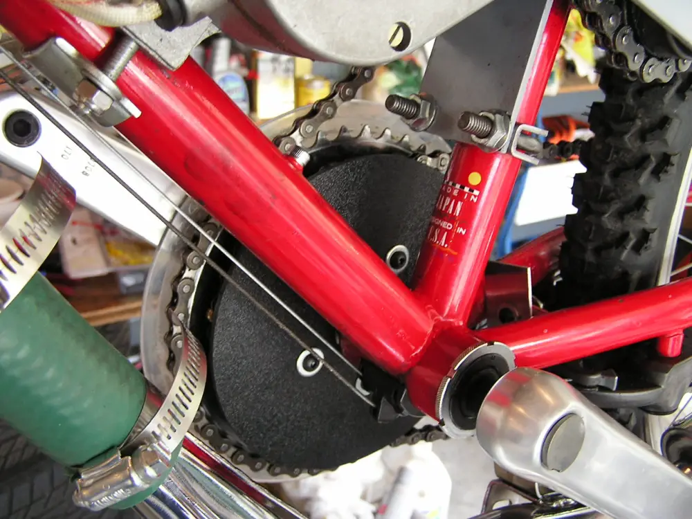

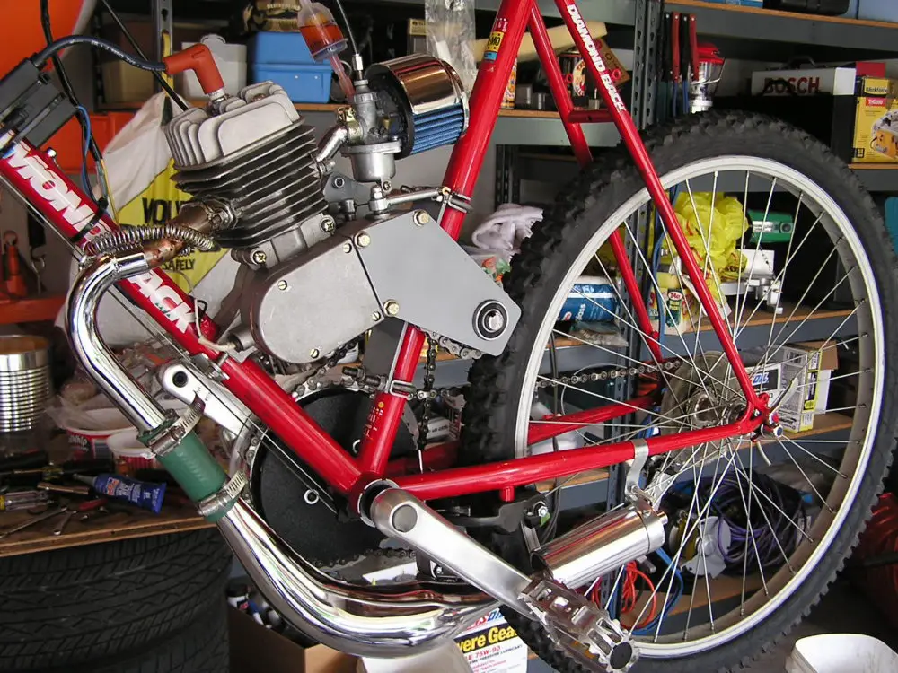

More photos:

slowly posting more frotos

Lookin Good Pablo! How's the pipe's performance? When does it hit?

It comes on right away....I had to reset the idle....even idles easier. I would say well worth the money.

that looks like the ancient Diamond Back Apex that i've been robbing for parts.

That's exactly what it is - ca 1988. Makes a strong MB.....I've be thrashing this thing.
I need to balance the wheels for this 40 mph stuff though.

give me the lowdown on that pipe dude!!!!!!!!!!!

You can get the pipe here or on ebay.
47cc Pocket bike Performance Pipe.
You need to cut one of the bends out and use a silicone coupler. Then all you need are a few copper fittings and you are good to go.
