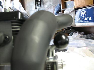

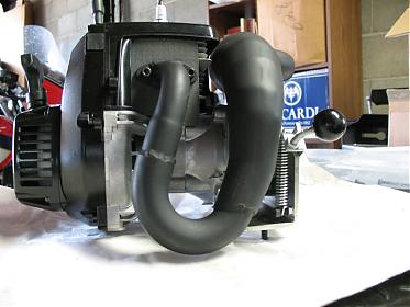

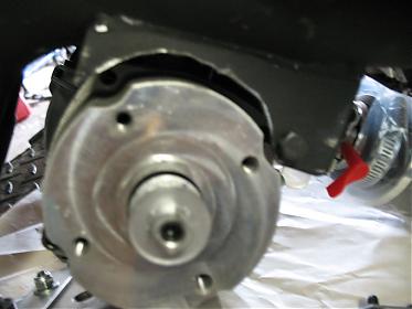

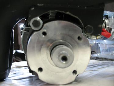

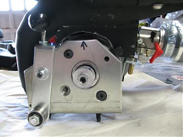

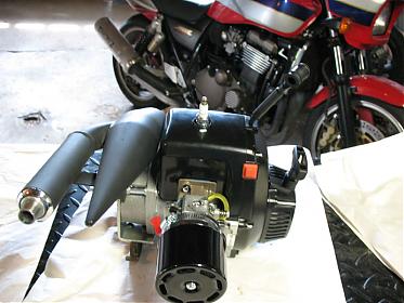

well, started assembly tody, and of course being at my day job, trying to hurry and having my head you know where, the first thing i did was stupid but i later saved it.
this first pic is the scribe for removing material to mount the DDM Dominator pipe. you will probably see 2 things wrong right away.
2nd pic is the silencer stinger installed in the pipe.
3rd pipe in mookup position, this is where i realized what a dope i am.
4th starting to get it working anyway. bracket bolts in place.
5th rear bracket bolt spacers, using long bolts from header kit.

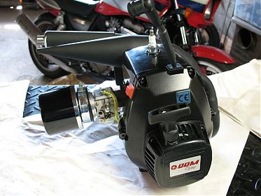

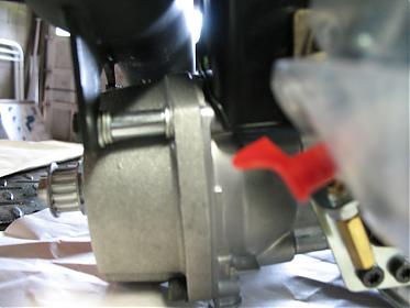

6th front bracket spacer, same bolt as rear.
7th tensioner/ mount plate w/ handle mod and full up
8th handle clearance full up
9th handle full down
10th handle full down again

11th business end
12th curb side
beyond that i test fit the upright bracket, every thing good there.
waiting for my tires t be mounted , will probably fire it up Monday night .
more pics and commentary to follow.

Any mistake that you catch is not a mistake but experience.
Looks very nice.

yeah, all that's needed is to remove 1/2" total verticle form the bottom of the bracket in a 'sliver moon" shape that is INSIDE both the bolt holes.
if done correctly, you can lay the pipe bracket against the front face of the GEBE drive unit, drop the bolts thru into the upper two top drive unit holes for refference and scribe the back of the bracket.
what i did was much more involved and totally stupid.
i bought the black pipe because it's cheaper knowing i was going to cut on it. now that i have it worked out i'm probably going to get a chrome one and sell this one to someone that's not as anal as i am.
thanks,
steve
