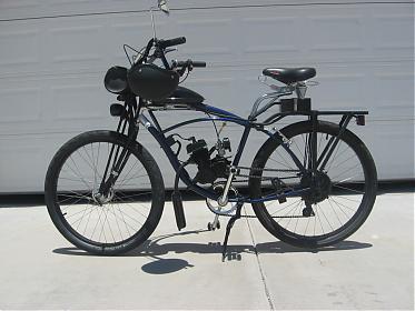

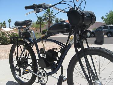

this is my Jaguar,
I hope you like it
I have done many upgrades to it
front wheel is a sturmey-archer X-FD drum brake hub, alexrims double-wall rim
back wheel is a formula disc hub laced to rhyno-lite double-wall rim (my LBS called it 'bombproof' )
handlebars, trimmed 2" (each side)
severe set-back seatpost (I am 6'1", it fits me perfect now)
triple sprung seat
black springers
old school 'newsboy' rack
kenda flames front & rear (26x2.125)
custom 12v lighting front n rear

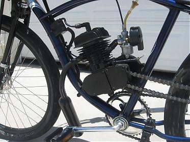

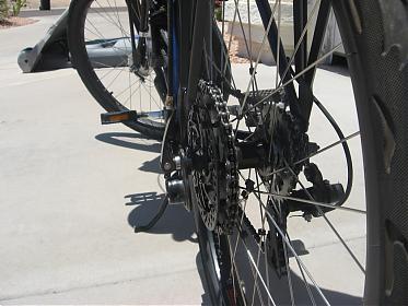

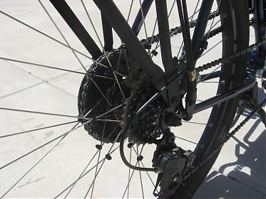

driveline - 70cc Livefast engine,custom bent exhaust (shoots it straight down,,,better for trailer passengers) rear sprocket is a 40 tooth with center cut out so I could mount it inside a rotor (see pics)

very cool!
this gives me some ideas of the potential of my newly acquired $25 Goodwill Jaguar :-)
do those springer forks improve the ride, or do they just look super cool?

they help a lot
with the setback post, I am more over the back wheel and the orig forks would bounce the front up !
now, all is good with my world
