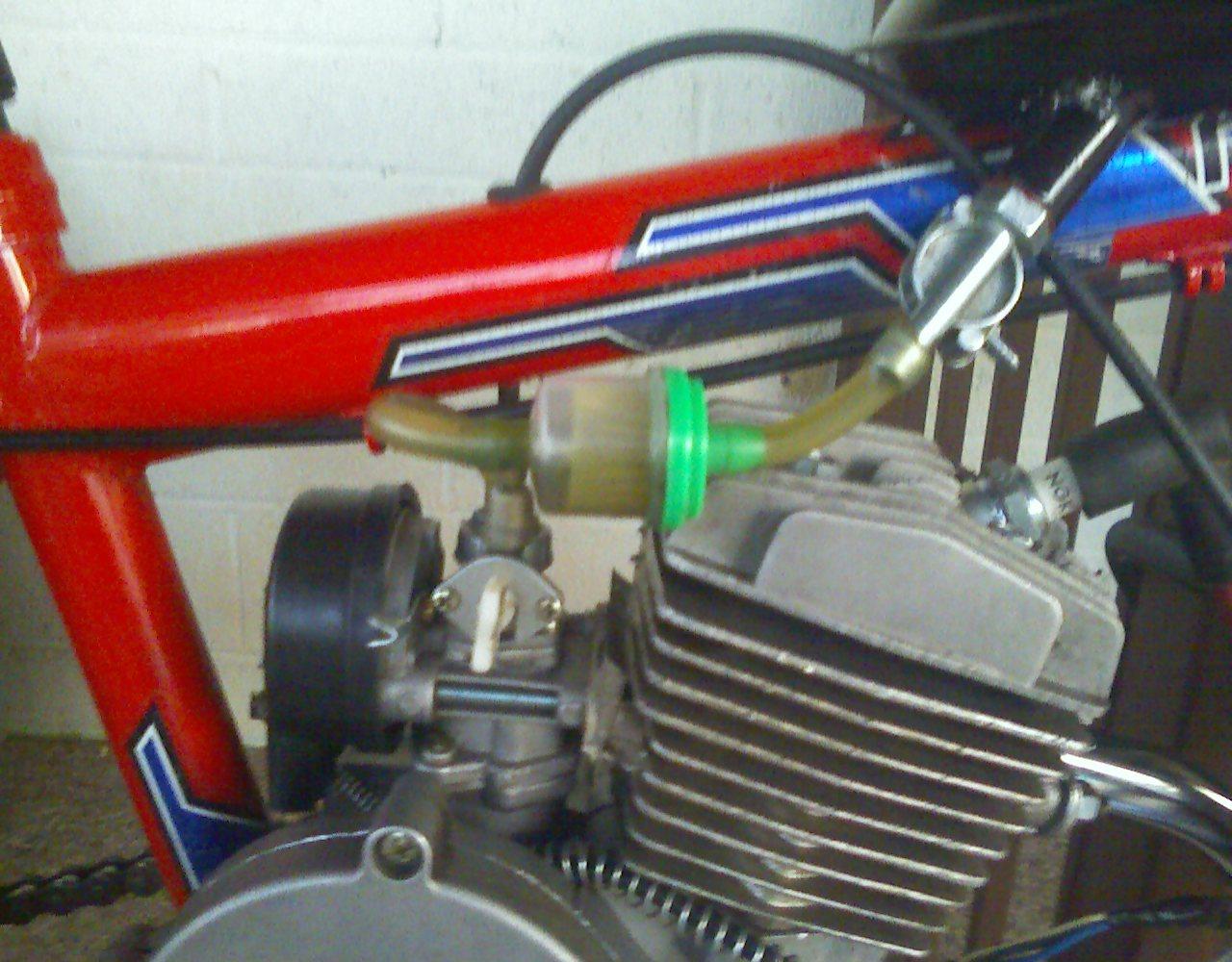

I had a similar problem with the clearance on my sons bike. The easy solution for me was to drill the frame. It just a 30 dollar bike off craigslist so no big deal. He also weighs 225 lbs and rides hard and after 100+ miles the bike is fine. I put the grommets in to help the cable from getting chewed on the metal and it works just fine. I would like to put a "noodle" in though. The offset intake was not an option for this carb as it would need a flange on both sides-this carb mounts directly to the cylinder. Its a good thing this engine has a slant head too otherwise it simply would not fit!
