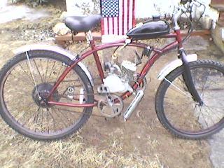

I just did this to my bike. My bike laggs alot of speed... my kit use to be really fast... (34 mph)
but I moved it over from my speed bike to a cruiser which is now hitting... I would guess 15 mph And would Idle Rediculously high... so i did the carb cleaner trick to find a leak.. and i spayed it near the manifold and my idle dropped some.. So I did the sealing trick and now my Idle is AWESOME.. I can hear the true sound of my new SBP expansion muffler. it sound great. But the speed problem persist.
it seems like its not getting enough fuel or something.. my sparkplug is burning tan and the clip is on the first notch on the needle. it has a drastic loss of speed and power then gains it back, then drops again.... dunno why. like i said its only toping out at about 15 mph or so...

its getting too much gas try going alittle less on fuel cock i did that too mine no more bogging or cut outs !!!

KLA63,
Holy crap... That was all it was this whole time...
I just went out and opened it only a quarter of a turn instead of half and BAM!!
I dont think I have ever gone that fast on one of these things...
SO SO Fun and scary lol, you were exactly right, and it didnt bogg at all.. it felt like unlimited power.. the only thing keeping me from going faster was the vibration lol. Thanks alot man. VW

Your Welcome !!!! like i said find where yours runs good and remember the postion i mark mine with a sharpie i make a black line on pet cock that i can see looking down!!!! and in the earlier post i gave you just cut up anold inner tube !!!rap around where your mounts are that should take care of some off the vibration!!!! you can also fill your handle bars with sand that will take some vib out of your hands as well..... glad i could help enjoy your ride!!!!! if you have any questions drop me a line !!! yankschewy@yahoo.com or gas bicycle motors Home

The fuel petcock is NOT a fuel metering device. If restricting the flow helps your performance then you have other problems. Start with the float/needle & seat inside the carburetor. Typically a float that is set too high will allow a flooding, or rich fuel mix (too much fuel to air). Check for trash in the orifice of the needle valve and make sure the needle seats fully and shuts off the fuel as it is designed to do. Raise the clip on the main jet needle. This controls how far the needle is pulled from the jet. The more it is raised, the richer the mixture. The petcock should be full open and the carburetor controls how much fuel is delivered to the engine.

been there done that it never worked !!!!!! this works and there is no problems!!!!! plug exellant awsome power !!!! that what works for me on some bikes so thats what do !!!!! none of these motors are the same !!!!! these are cheap carbs not much too them four notch needle !!!! i've been working on these alot so that s what i do !!!!!! it work for him too !!!! you don't need that much gas too run these little motors !!!!!!!!! i have one bike with over 15,000 on it still running like a rocket with pet cock at a certin postion!!!!!
