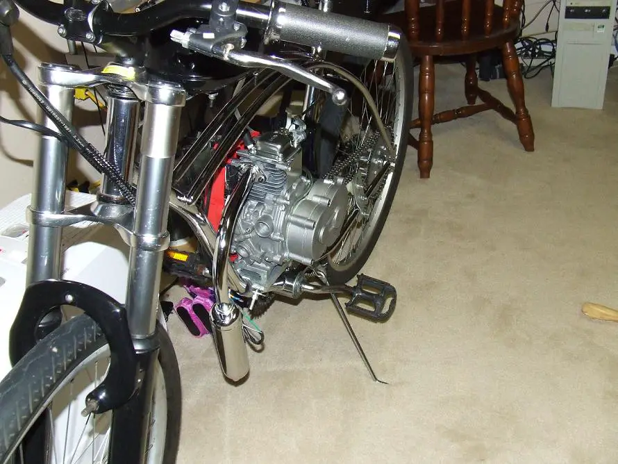

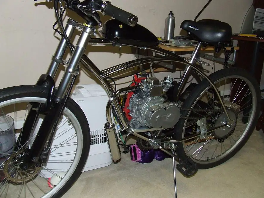

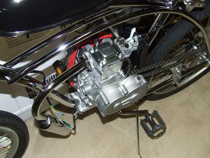

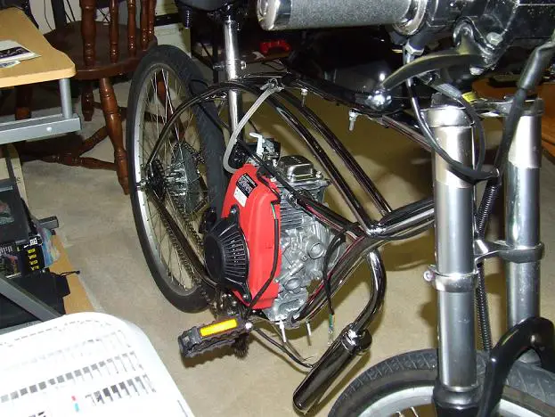

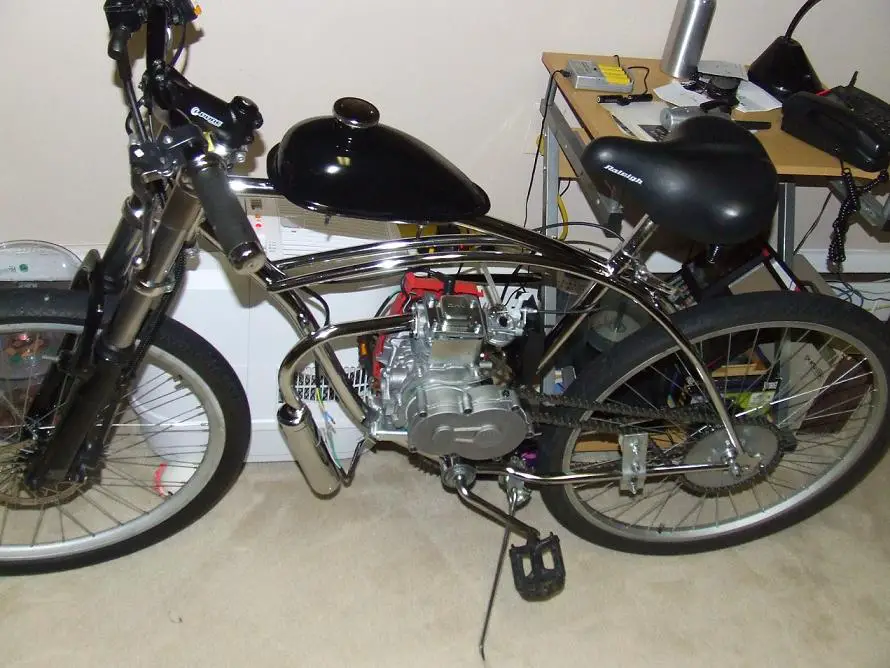

ok its finished. there have been good results with bearing grease. this thread will be for other fluids.
and my first test is transmission fluid. about half a cup.

ok third ride today transmission fluid works no slip. only time i get the gear noise is when im slowing down from high speed. even then its not much. only thing i would like to add is a vent tube on the gearbox it gets warm and i worry about pressure building and blowing a gasket.
fluid used atf automatic transmission fluid gm dexron 2 or ford mercon fluids
i think i found my motor starts on one pull. lots of fun to ride.
