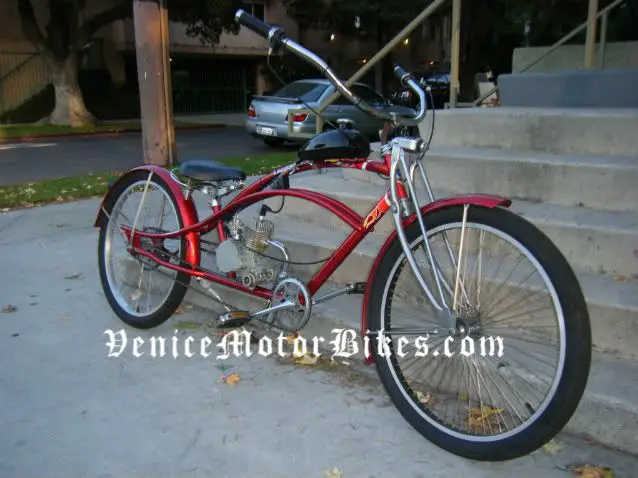

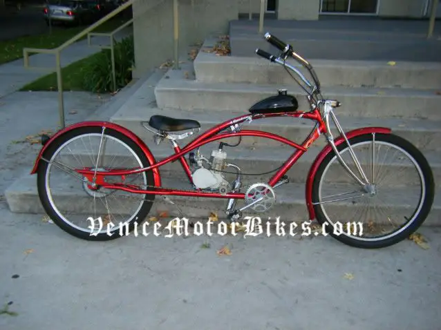

Here ya go...
You're gonna need longer cables, fuel line, a longer engine chain, a few extra links of BMX chain for the pedaling chain & a extra chain tensioner to make your pedaling chain go under the engine.
This bike had 68 spoke wheels which didn't work with the rear sprocket. (I had to switch to a 36 spoke rear wheel.)
You will also have to make the CDI wires longer...

Sounds like a good challange. Any chance of some close up pics of what you did with the chain tensioners. Getting the pedaling chain lower makes a lot of sense. Also did you keep the original grips?

Sorry, I can't get any new pics... The bike has gone on to it's new home.
I'm sure you can get the jist of it by looking real close at my pics...
