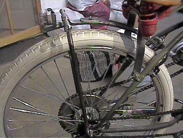

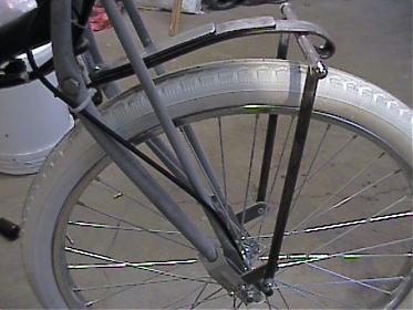

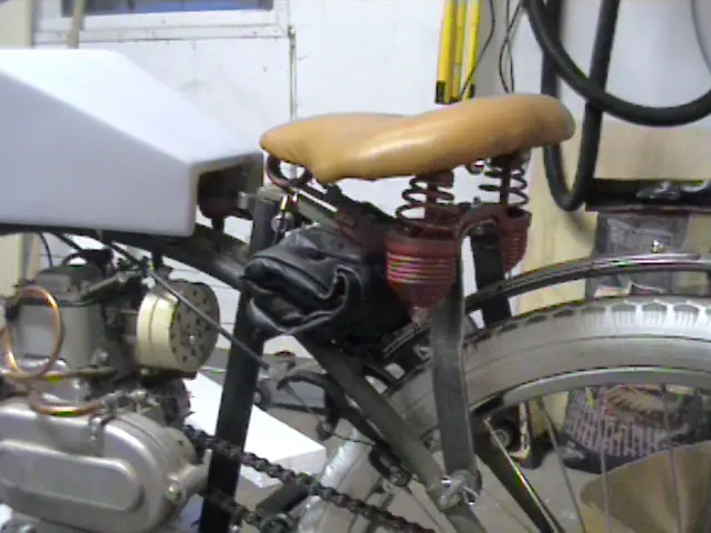

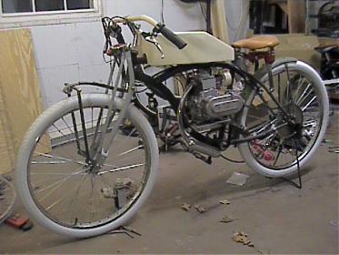

Here are some pics- it's still needs paint, but it's coming.

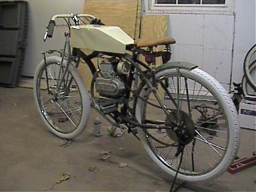

First, a couple of overall shots- the bike does not have that fender anymore- it has a rear leaf/fender shown later. Also, the tank is back in primer and i have added the headlight/speedo housing shown later.
Next, pics of the front and rear "leaf springs"- I have a springer front, but not using the leaves- these are just for looks and are my fenders.

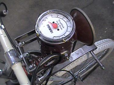

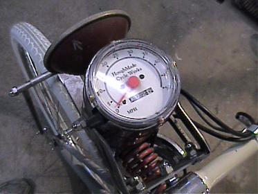

Here is the headlight/speedo housing- it is an old railroad lantern. The speedo is a standard bike speedo, but I scanned in the face, then made my own custom face on the 'puter and laminated it.

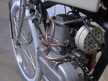

Next is my "oil" pump- motorcycles in the teens had "total loss" oiling systems that required the rider to pump oil into the engine every so often- Mine is a chrome frame pump with a plunger screwed on to look like a pump and copper attached at the end to just hold it in place and look like there is an oil line into the engine. It goes nowhere. It is mounted with a rifle scope mount- got it on clearance at the big "W".

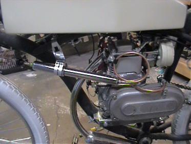

In the last pic, you can also see that I reversed the in/out control on the Grubee gearbox so that it is always in unless I pull the handle- rather than always out and only in if you pull the handle (that makes no sense). I have not touched the handle since.

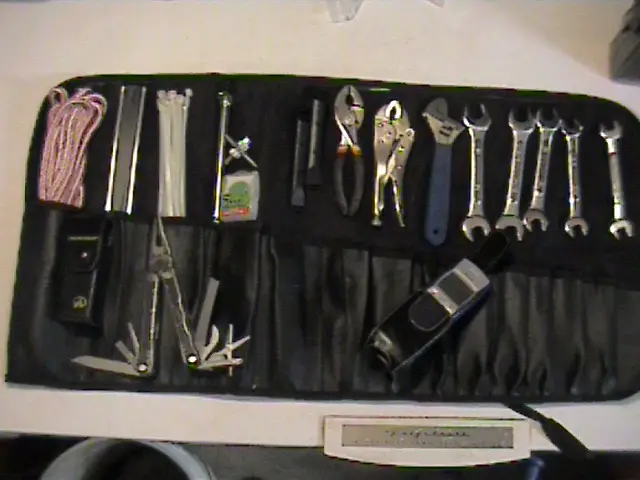

Thought I'd throw this in, pics of my "road kit" in a tool roll from Harbor Freight.
From left to right:
1) 10 feet of rope- you never know when you will have to suspend either end of your bike in the air
2) Electrical tape- to make it easier to travel, it is wrapped on a 1" wide piece of aluminum- 10 to 12 feet, very compact
3) Zip ties- long ones, you can make a long one short, doesn't work the other way.
4) Tire gauge, tube patches and valve tool.
5) Tire removal tools.
6) Small slip joint pliers.
7) Small vise grips (any number of uses).
8) Cresent wrench.
9) through 13) Combination wrenches (more sizes, less space), 14-15, 9/16-5/8, 12-13, 10-11, 8-9
Second row- on the belt, not in the roll:
14) Leatherman- don't get a cheap imitation. They are well worth the price and work well. A cheap one will convince you combination tools are worthless. They are not, but the cheap ones are.
15) Cell phone
Then you can see where the roll goes- attached with three mini bungees.
BTW- in the hollow area at the back of the "tank", a spare tube will be concealed in there.

that leafspring business is particularly cool. and i like the way you handled getting the seat further back. i could go on, but suffice it to say that that is a unique and impressive creation!
