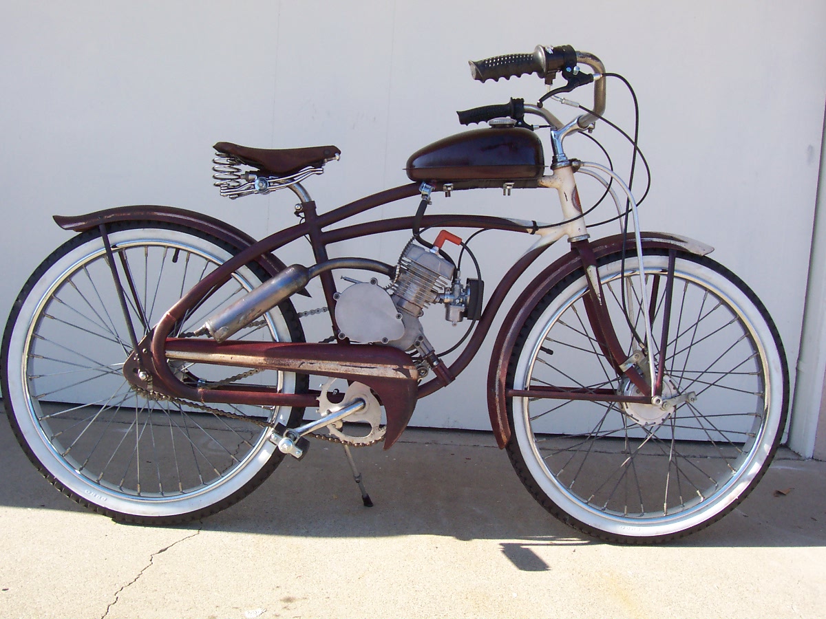

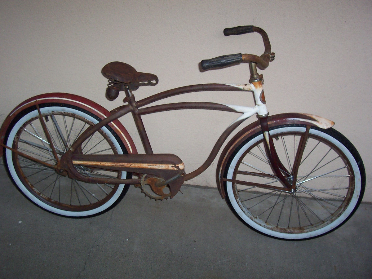

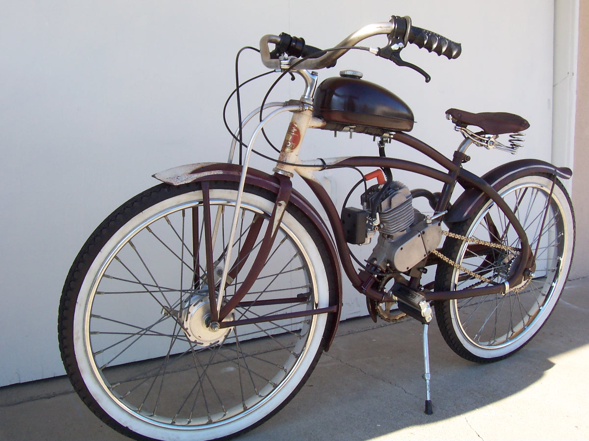

here's a before and after of my bike. just finished it today, and it rides super friggen awesome.
the build-up process is detailed here: http://motorbicycling.com/f38/rustor...off-13144.html
yeah, the motor's on backwards. that's part of the reason i'm making a new thread here. i'm gonna list the pros and cons, performance, etc... as i go along.
for now, i just got it running today, and besides the "hot foot," it works perfect.
i'll update this later. i need to ride it to the liquor store to get a soda, and that'll probably take me a few hours...

i just got back from my first ride, about 20 miles. this thing screams. when i say "it screams," i mean, i blew past a guy on a 50cc scooter, and he couldn't catch up with me. i was riding down Newport Blvd, a 45mph zone, with traffic. keeping up with them no problem. and i still haven't completely opened it up yet.
don't worry, i'll post proof when i can get a buddy to pace me with a video camera.
there's NO four stroking or sputtering at all. none. not even once.
my set-up is:
66cc Grubee Starfire GT4 reversed.
you have to spin the jug and the piston, and match the transfer ports on the case. i also smoothed them all out as far as i could into the jug, and very carefully smoothed the burs at the cylinder ports.
the head and the jug were both lapped on a glass table, probably lost a millimeter on each to increase compression.
the intake manifold was cut down so the carb would clear the frame, which also gives a performance increase by having a smoother, shorter path for the fuel mixture. i also match ported the intake manifold to the jug as much as i could.
the exhaust pipe was straightened and ported, and the baffle and it's internals have been left alone.
the NT carb has been cleaned and polished inside and out, and the burrs and step downs have been smoothed and polished. air cleaner is still stock.
NGK BH6S plug, with filed tip, gapped to .025
solid inner wire plug cable and new boot.
Opti-2 oil at 60-1 ratio
the motor is brand new, and i'm not baby-ing it at all for break in. (if this develops any more power after break in, it's gonna be really scary...)
30 tooth sprocket on 24" wheels.
i'm 135lbs, and can ride this bike off the line without pedaling (but i do anyway.)
the bike itself is a little squirrelly, due to it's smaller size, but i think it has to do a lot with the crappy Duro tires. they came with the bike, i normally hate whitewalls, but they look pretty good on this one. another problem with them, is the whitewalls aren't straight, which gives the illusion of the wheels being bent while they're spinning.
more later...
