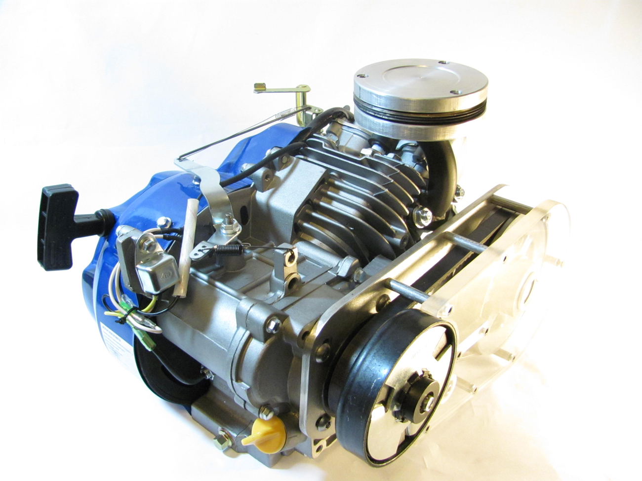

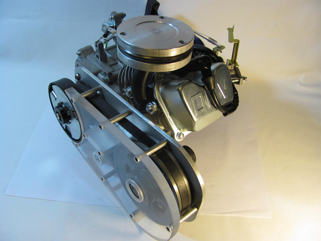

Old 12-24-2009, 12:05 PM
tyrslider's Avatar
Location: RainCity
Posts: 970
Talking Prototype Pics Leaked!

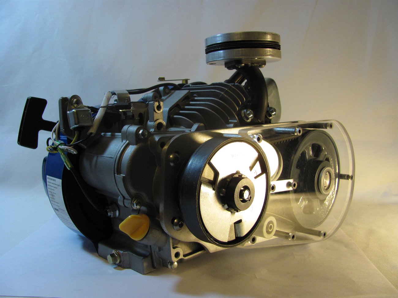

Dan and I have completed the 1st phase of our belt drive system i.e. they are built and ready for testing. The prototype "ShellyBelly Whisper Drive" will begin testing just after the holidays!
ID:	18031   Click image for larger version

Old 12-24-2009, 03:58 PM
glacknoid's Avatar
glacknoid glacknoid is offline
Join Date: Oct 2008
Location: robbinsdale MN
Posts: 183
Default Re: New in frame 4 stroke kit in development!
Looks top notch, I love that you actually showed some sneak peaks. I hate when stuff is kept a mystery, can't wait to see it developed, tested and eventually see a video demo. Again, it looks very professionally done
Old 12-26-2009, 10:39 AM
john_the_great's Avatar
john_the_great john_the_great is offline
Join Date: Oct 2009
Location: California
Posts: 191
Is that the 2.5hp lifan? what motor is it? Its good to see gearbox development for the bigger four strokes
Old 12-26-2009, 11:52 AM
tyrslider's Avatar
Location: RainCity
Posts: 970
The motor in the pic is a 2.5hp 98cc Lifan motor sold under the name "Power Pro". The 2.5 hp 79cc Lifan motor sold by Harbor Freight under the "Greyhound" moniker is the other that we speak of.
These motors are known to be of the highest quality available. They're very affordable and accessable to most everyone.
Thanks, Evan

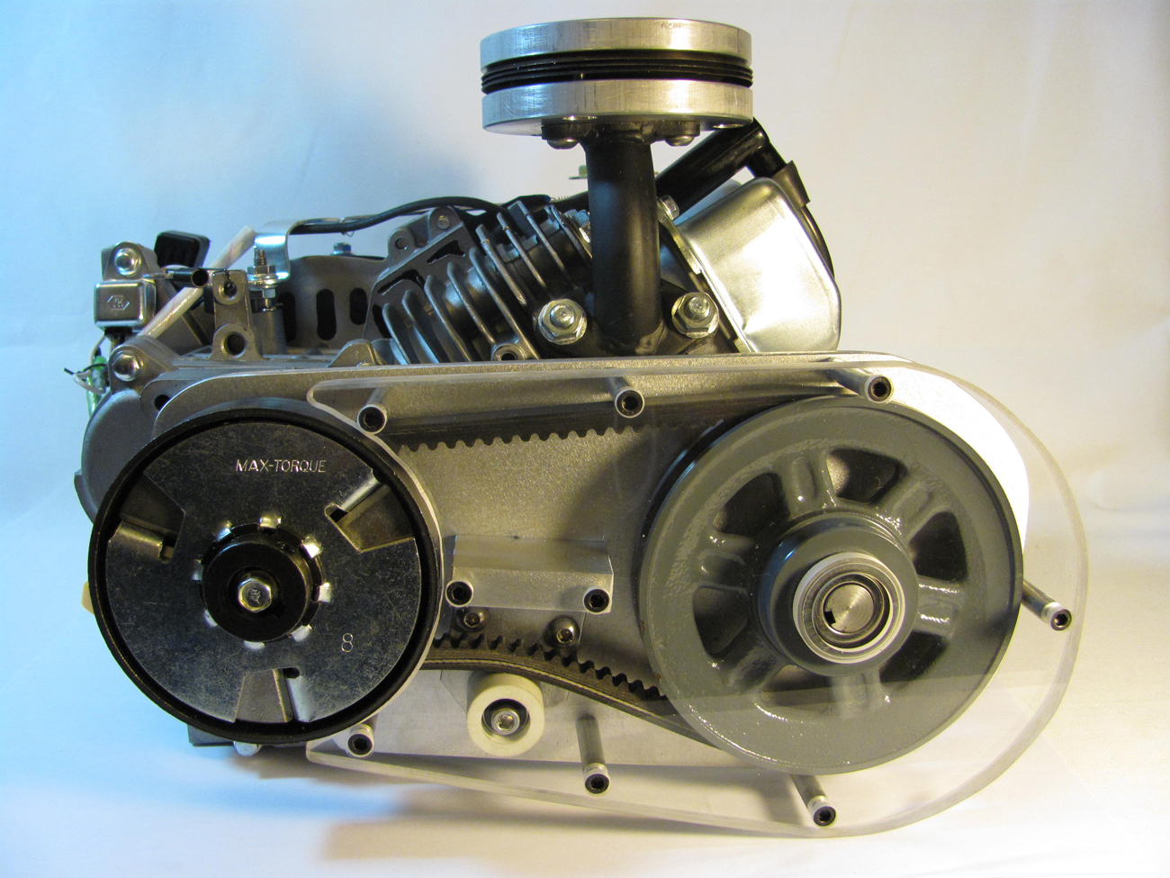

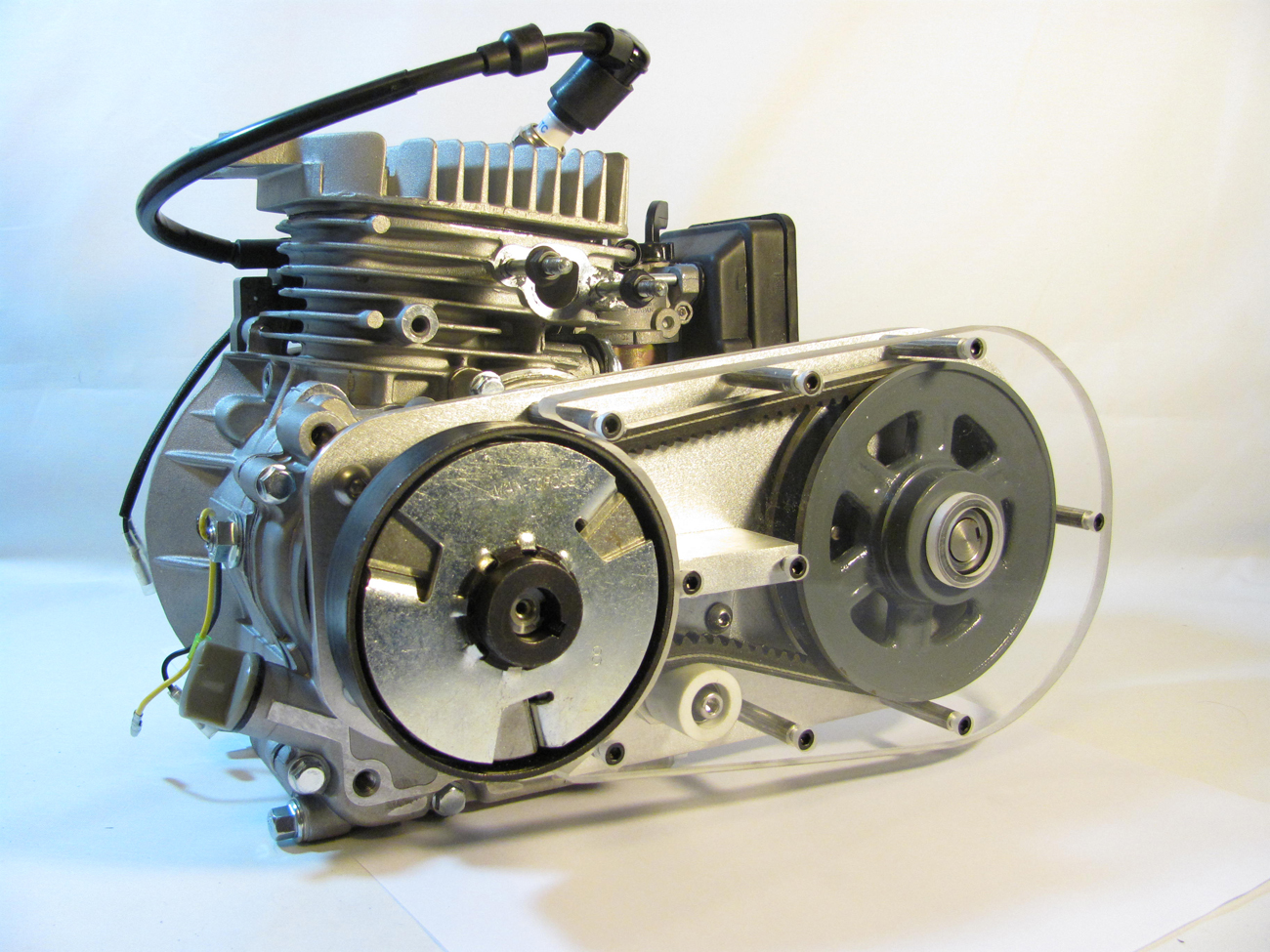

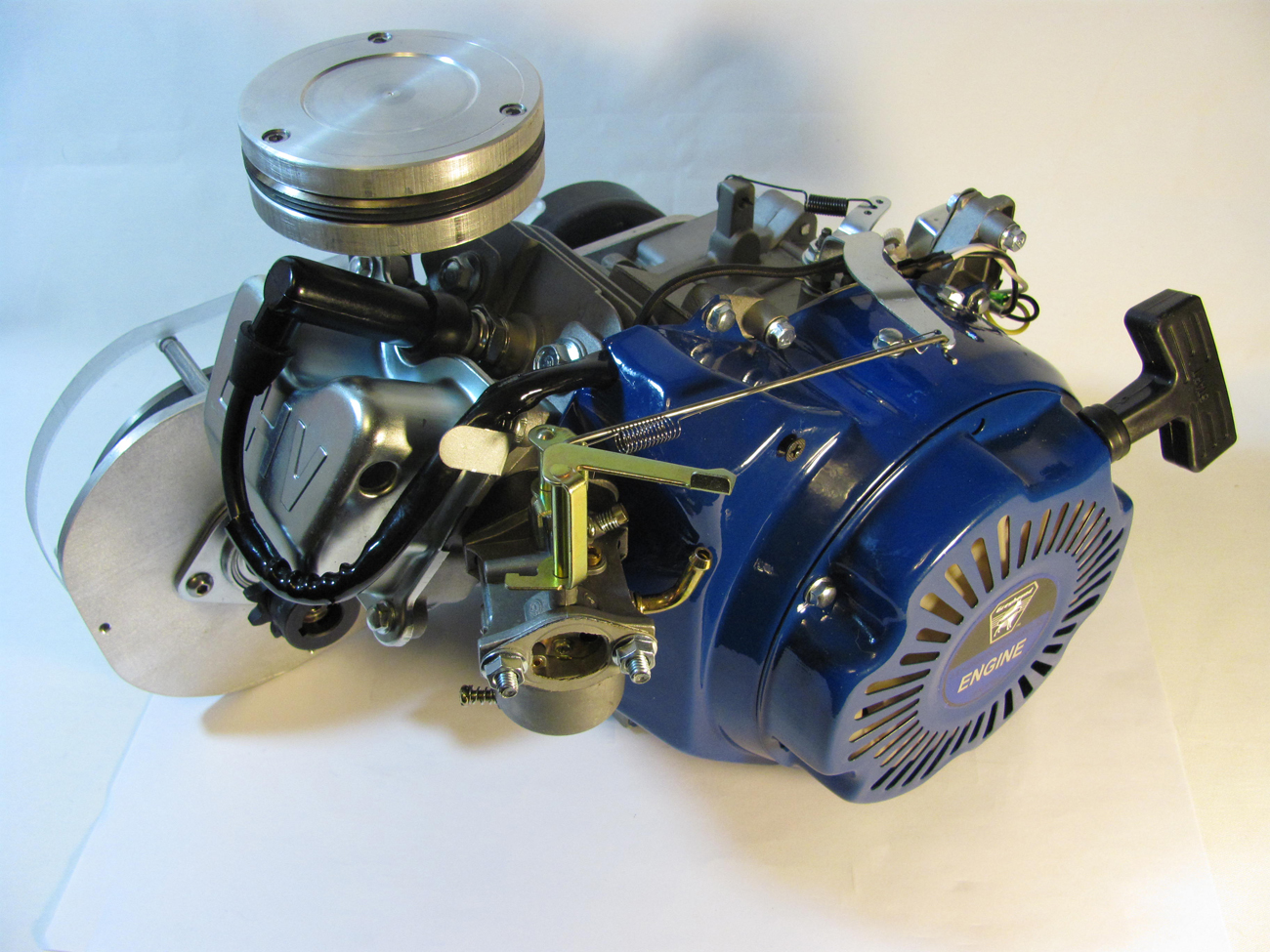

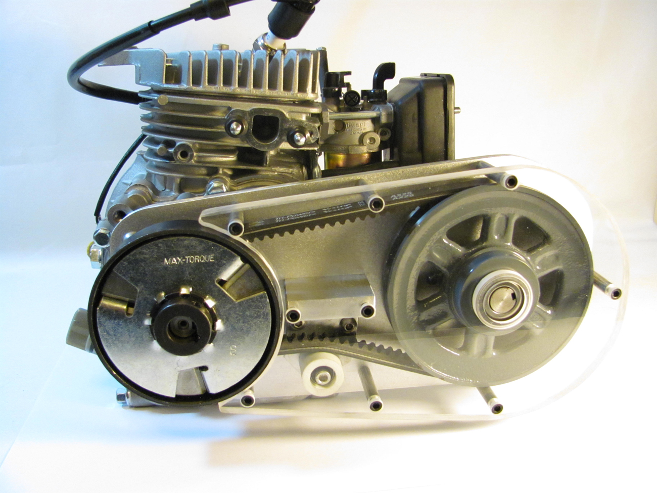

Old 12-27-2009, 11:27 PM
tyrslider's Avatar
Location: RainCity
Posts: 970
Default GasolinePunk!
Harbor Freight 79cc GasolinePunk Motor W/ Whisper Drive!
