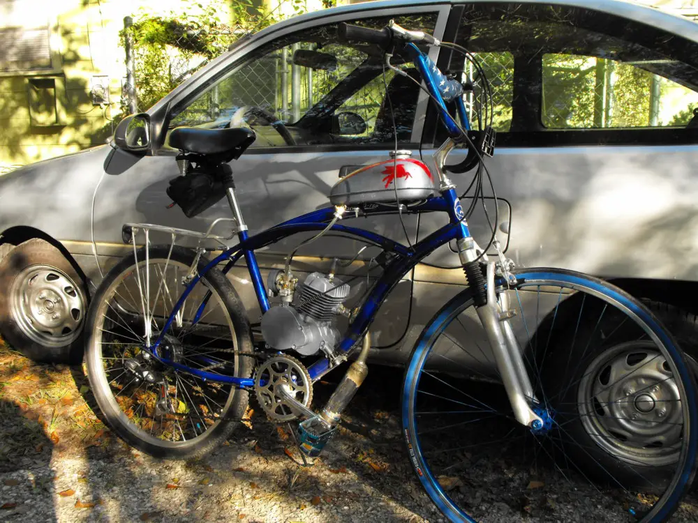

A 36 tooth sprocket definitely ups the speed- but also (and I'm always harping here) TIRES!!! Most mountain bikes have dog tires- knobby 1.95 width or 2.225 Heavy and sluggish- too much rolling resistence!
You see bike racers with narrow tires- that's for weight and roll- we have a very small natural motor- less than a horsepower, and our 2 cycles haven't much power either- they do respond to the tenets of racing and touring bicycles.
get some smooth tread street tires- 1.75 or 1.50 and a smaller sprocket (at your weight 36 should be NO PROBLEM if you aren't mountain climbing- if you want to ride trails you have to sacrifice street speed. That's the diff between a dirt bike and a street cruiser in the motorcycle world.
Before the motor kicks over, you'll notice the difference peddling. Plus you'll find the vibration MUCH less and the ride more comfortable- 1.75 are not popular and a lot of shops sell them for ten and twelve dollars- and you can still use your old tubes.
