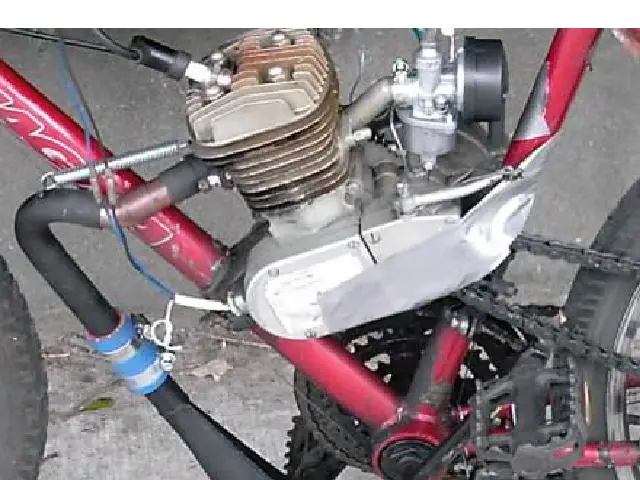

I cant really think of a way to mount my chaingaurd without getting in the way of the chain. Can anyone shed some light on my situation?:
http://i8.photobucket.com/albums/a11/socmo/chain.jpg

there is a small tab on the front of the chain guard it attaches to the one long bolt on the clutch lever
cover where the long screws sticks out use a washer,lock washer, and 10mm nut.
the other end of the chain guard might need to be trimmed with tin snips or use a dremel cut off wheel to get it to fit. You will need to drill a hole for the back mount in the chain guard. there should be a strap with the engine kit that you can bend around the rear frame of the bike to strap the rear part of the chain guard. You will want to do the strap first getting to the shape you like then using the strap that is now shaped into a U shaped clamp line up the rear chain guard and drill a 1/4" dia hole using the strap as a guide for the hole. you will then put a bolt through the strap and chain guard use a washer and lock washer under the nut on the bolt.
this guard had to have some of the guard trimmed off the back end to fit.

I've only had 2 installs over the past year and a half that the chain guard actually fit well. If it doesn't fit right...it's just one more thing to cause trouble!
Normans description of "how-to-do-it" is correct. But don't fight it...if it won't go...pitch it.
