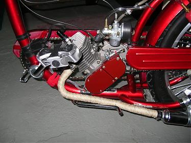

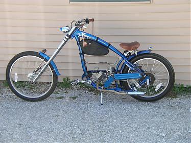

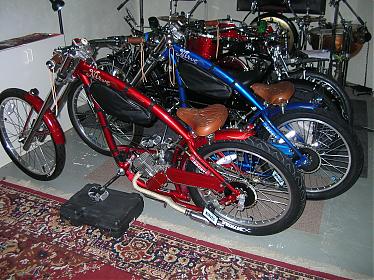

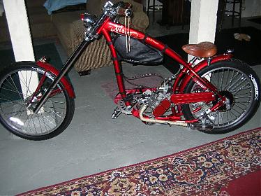

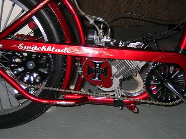

Here are a couple of Nirve Switchblade choppers that I was able to build as a winter project. My wife and I have been riding alot and they are both broke-in now.
The fuel tanks are in the top tube as well as a vent and the fuel shut-offs. The biggest challenges here were engine placement (Spooky Tooth 80cc), and getting the chains to clear the 3" back tire. The front wheels were relaced with a Sturmey Archer front hub brake and the rear got 12 guage spokes. They were alot of work to build, but alot of fun to ride!!

The back wheel was alot of work. It was relaced with 12 guage spokes. Ditch the chain from the kit and get yourself a narrower chain KMC510 BMX works great. Next, I got the Clamshell Sprocket Adapter available at Livefast Motors(from Jim). That kit has a nifty spacer that goes on behind your coaster brake arm. I used 2 of the spacers to gain enough clearance which means you may have to buy 2 kits. You also will need to buy a sprocket from Livefast, as the one that comes with most engine kits does not work well with the sprocket adapter without elongated the mounting holes. I then had to use an additional 1/2" spacing between that adapter and the sprocket to clear the tire. What works very nice there are the rubber spacers that do come with your engine kits. The holes in the rubber spacers do not line up exactly with the new sprocket but can be forced/made to work. Now you will find that the mounting bolts for your new sprocket(mine is 40 tooth) are too short and M6 long bolts are pretty hard to find. Fastenal is a good source but may have to be ordered. I bored out my adapter and retapped to accept 1/4" hardened steel bolts. Once that's all put together you should be clearing the tire , or at least close. The frame will have to be tweaked about 1/2" to get the whole assembly to fit between the dropouts and a medium thick washer on each side between the axle and frame will let both chains clear the frame nicely. You can also dish the wheel a little one way or the other for final adjustments. Now you may be wishing for a longer axle! I had to put one on the blue chopper to get enough axle to hook a pull-along trailer to it. The red bike is fine without it. Sorry I have not been around here for awhile, but these choppers are so fun!! We put alot of miles on this summer. So there you have it, it can be done. Alot of monkey business, but I did whatever to keep the 3" tire on there. It would be ALOT easier to use a smaller tire, but not as cool! If you have any more questions just ask. I will be keeping a closer eye on here now that we are coming into winter.

Does anyone know if its possible to mount the motor on a slight angle to stop the chain from hitting the 3 inch rear tire (basicaly angling the chain precisely to the sprocket, clearing the tire and frame) if not angle perhaps offset the motor mount)

Don't know exactly what you mean, but yeah, they are angled front to back. Usually about 60 degrees forward or so that when mounted the float bowl of the carb. is level when riding. Sometimes you might have to move the engine slightly to th left of center when looking from above (like in some motorcycles). Yes you want to "present" the best opening position for the drive sprocket, so the chain has a good entrance & exit. It also helps if you move the rear sprocket out a little if possible. Hope this helps. Walter F.
