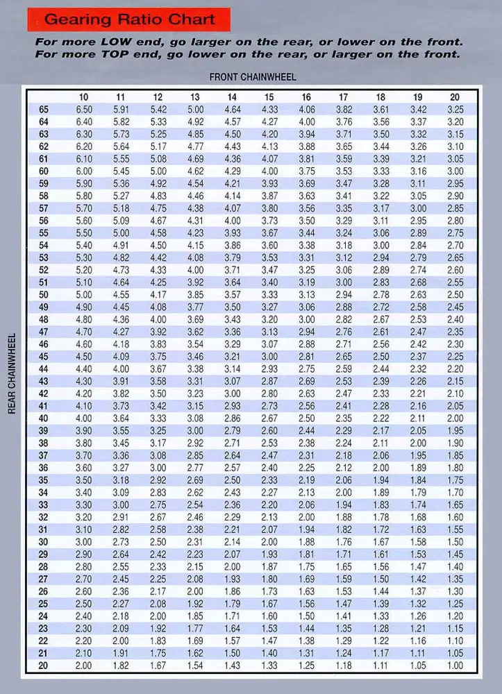

Sprocket Size Chart.

Larger rear sprocket =slower top speed/faster acceleration/pulls more weight/goes up hills better
smaller rear sprocket =Higher top speed/med acceleration/pulls less weight/goes up hills slower
my stock 44t sprocket takes off fast and tops out around 30mph or so and can go up hills good.
a 36t sprocket should give you a higher top speed and lower rpms out of your engine which will make your engine work less and it will make less noise,but will take off slower than with the larger one.

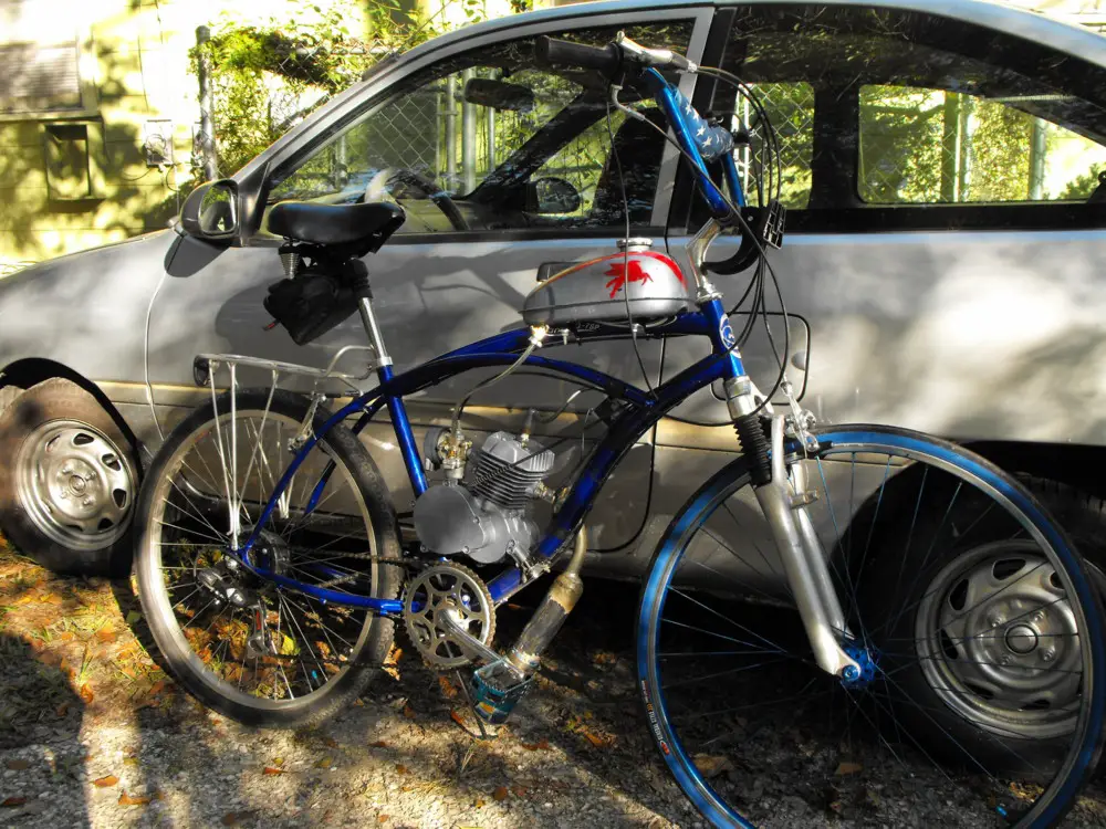

A smaller rear sprocket is a larger gear
while a smaller front sprocket is a smaller gear
a larger gear means a faster speed but less accelleration getting there
while a smaller gear bogs down less on hills
So there's no set answers- it's all dependent on the total weight it's pulling, the motor's (or riders) power, and the conditions of hilly or flat, smooth or rough
I have a 36 which works pretty well with smooth narrow tires, but I usually give it a little pedal assist when taking off, and it will bog down slightly on a steep very long hill-
I have no problems on the flat- I just got a kit that packed a 41, so I think the trend is going generally a bit smaller than 44.
Big wheels keep on turning!
