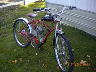

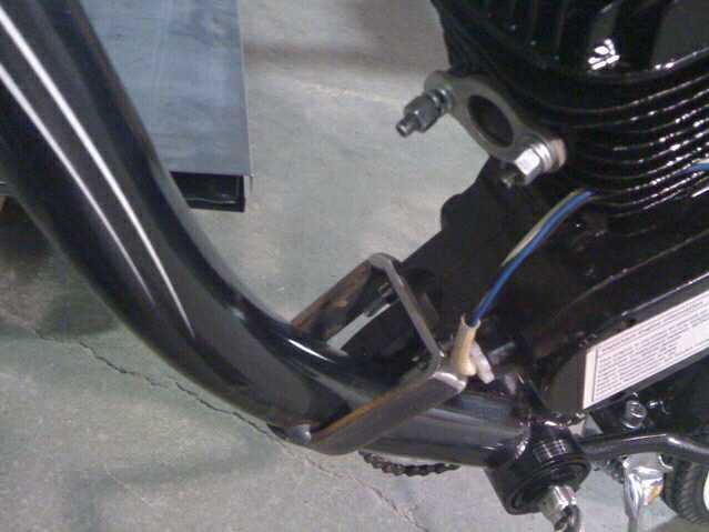

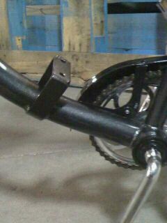

a few pictures of my front motor mount on my schwinn Del Mar. the back mount fit perfect and this looked like a good fix. the saddle bracket is welded on 3 sides of each side.
i found a perfect match in a spray bomb at wal-mart. it turned out pretty good i think.

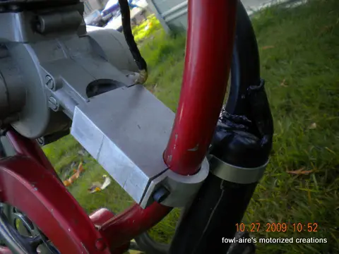

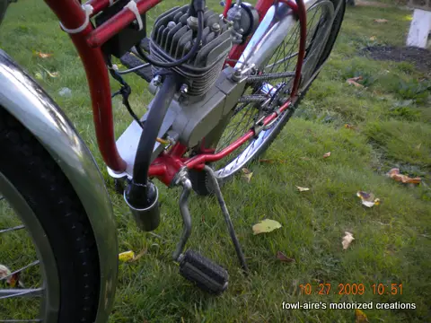

ID:	17711nice work I took a slightly different aproach to mount chinese motor on old schwinn cruisers.My mount required no drilling and offer a very nice solid mount.

I have an old Schwinn Panther to which I am about to install a motor. I like your mount, can you tell me how you made it?
Thanks,
Casey
Old 02-24-2010, 05:01 PM
Cabinfever1977's Avatar
Join Date: Mar 2009
Location: Upstate,NY
Posts: 2,292
Default Re: schwinn custom motor mounts
I think he used a solid block of aluminum, but you could also use 2 rear mount blocks together.
