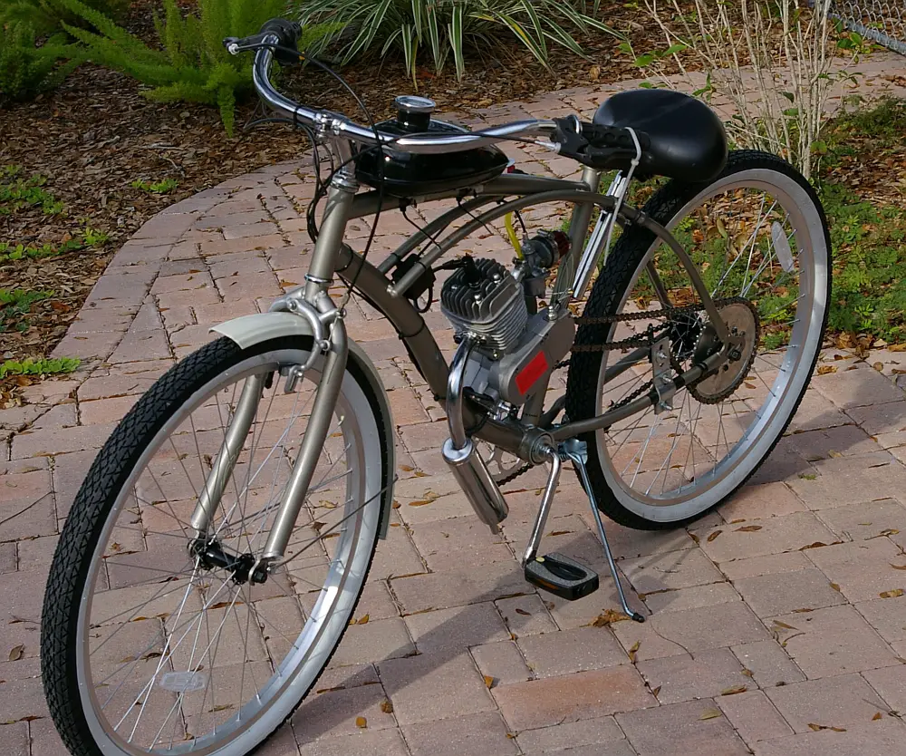

Old 12-01-2009, 06:57 PM
Doktor Puttz's Avatar
Doktor Puttz Doktor Puttz is offline
Join Date: Nov 2009
Location: Florida
Posts: 22
Default Re: Board Tracker or 1910s replica? Dunno...
Gassed up and road tested...coupla tweaks and it's good!

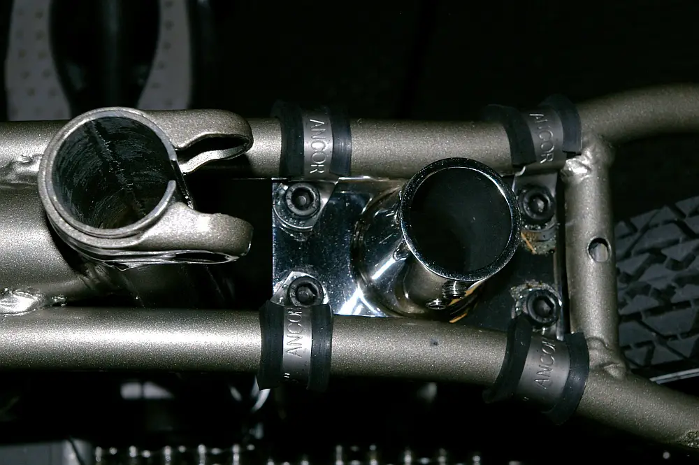

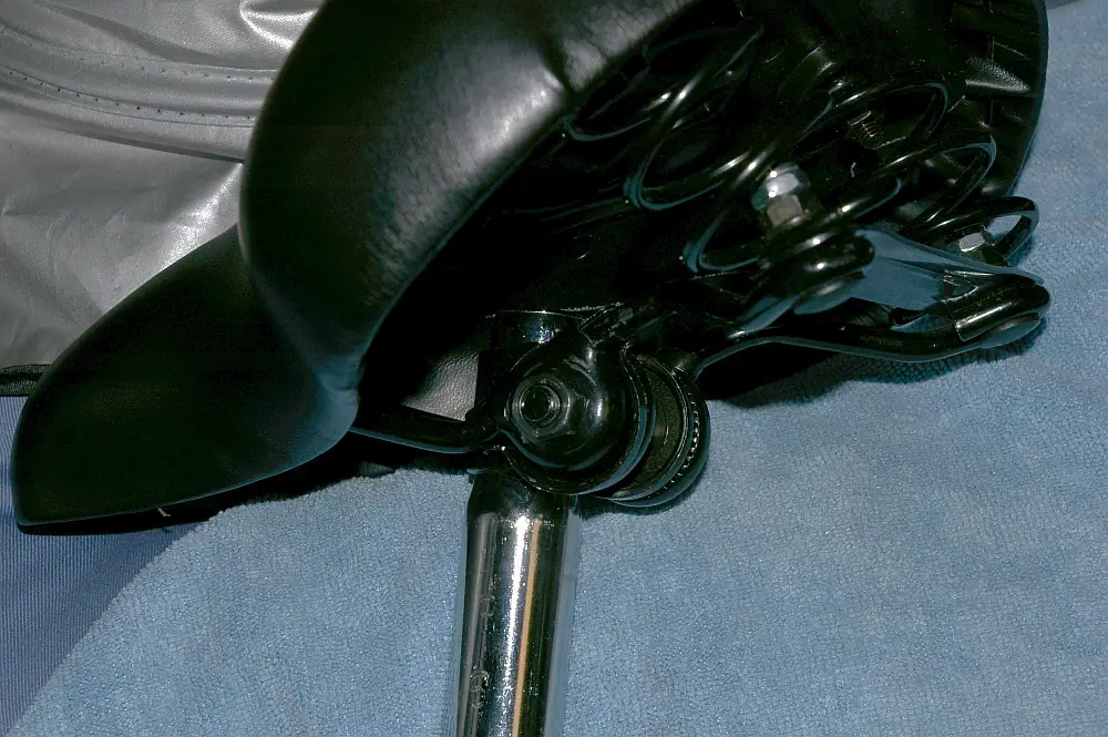

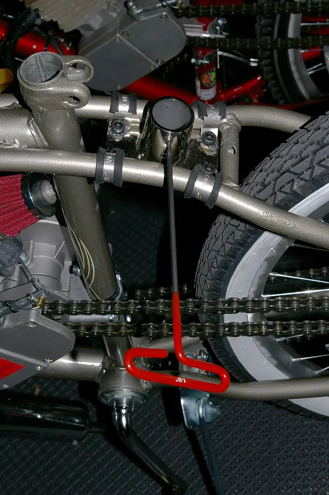

Old 12-02-2009, 11:35 AM
Join Date: Nov 2009
Location: Florida
Posts: 22
Well...being a Florida guy, I went to West Marine!
First pic: Flipped the clamps on the seat mount to make the seat sit lower on the post.
2nd pic: Used a 1" boat rail straight socket mount. Works with the frame angle just right. (You can also get them in 60-degree tilt.) Held in place with 4 heavy duty stainless rubber sheathed clamp/clips (Ancor Marine), high grade bolts and globs of threadlock.
3d pic: Seat post held in place by 2 socket set screws on the rail mount. I figgered if they will hold you hangin' over the boat rail in a gale, it'll hold my lardazz on the bumps. So far, ees good.
Doc
