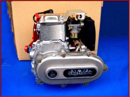

"Hoot."- theses are the cheapest and least durable. There have been numerous threads describing complete failures after a short period. There are Three types, a linear gear, helical gear and an updated version that uses a chain. The chain version is supposed to be much better.

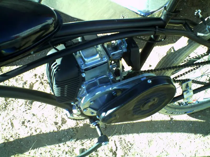

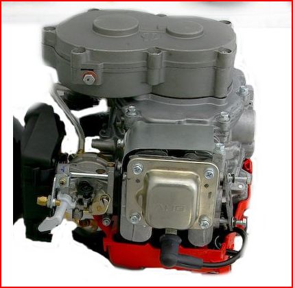

Grubee Stage III and II gear box- These are better that the Hoot but are noisy and the engagers break. It is a gear mesh and the box is filled with oil which some say causes more friction.

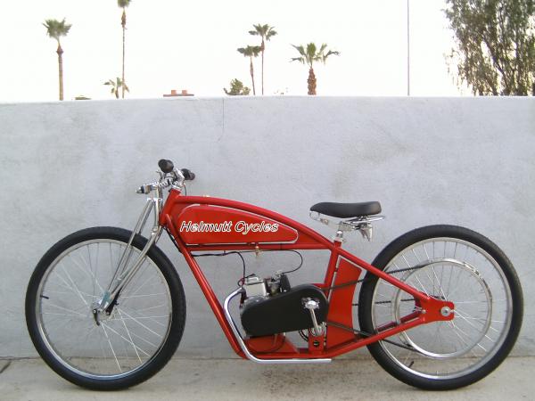

Grubee G4. This is the latest Grubee gearbox. Its belt driven and available with and without an engager. There have been some bad reviews about this box being too wide and the freewheel breaking. From member "Blow By U motors": First of all, it is my personal opinion that the 4G T Belt Drive engine kits are the most reliable V mount 4 strokes Kits out there. There are pros and cons for both engines, Honda GXH-50 is of course Japaneese high quality and offeres more tourque that the Clone but the Honda is not built for installing in bicycles at all. If you use original equiped Honda you will have to take the engine apart and remove the govenor plus the carb will not except a throttle without modification. The best way to deal with that is to buy a Huasheng carb for $40 and your problem is solved. Except for the price most Honda`s sell for $400 or more un like the Huashend 142F-cc 49cc engine the prices start at $170. The Huasheng engine unlike the Honda is ready to go right out of the box and the only down fall of this little screaming deamon is that is made with Chineesium metal and that means be carefull of how tight you turn them bolts. Huasheng engine is by far the best value and I have heard reports of over 50,000 miles and still going strong. If your going to have a problem with this engine it will be right away not later on and they come with a 6 to 7 month warranty and that is more than enough time find any problems. Now when it come to the two different 4G Tramsmissions tappered shaft Huashend plus Huasheng also has five eights shaft and Honda five eights shaft and in this case the advantage gose to the Huasheng tappered shaft because the clutch bell has a bearing. Now the Honda on the other hand has a brass bushing called a cc bushing that requires soaking the bushing in oil for 24 hrs, it is very brittle and easily damaged. Trans for the Honda also comes with a problem matic clutch that requires special tuning, ie; springs and washers but once this is dialed in the clutch engages right off idle. Unlike the Huasheng Tappered shaft the clutch dose not start engageing untill 2100 RPM.
There is one more thing that gose in the Honda`s favor with the 4G trans and Honda as a the pair are three quarters of an inch more narrow that the standard 4G with the Huasheng tappered shaft engine enables you to use the one piece wide crank with the Honda of which is more narrow than the 3 piece wide crank that comes with the standard 4G kit. I will say this about the 4G T Belt Drive engine kit with the Huasheng engine and that is this I have sold more than 200 of thses kits and I have only had to deal with shipping damage. Also this is the kits that I use in all my high end custom built bikes. BUT it dose not matter what engine you use with the 4G T Belt Drive transmission you are going to get a winner.

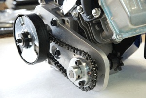

EZM Q-matic - claim to fame is that its all american. the box was designed by member "Quenton Guenther." The claim is that its the best box on the market but you have to pay for it. It's quite expensive. The EZM 'Q-Matic' is a automatic with a max-torque made centrifugal clutch. The EZM 'Silent-Drive' is a manual version. Both are a belt drive primary and chain secondary design (the manual is easily converted to a belt secondary. At this time, the manual 'Silent-Drive' is only available with a kit. The auto 'Q-Matic' is available in kit form or as a stand alone replacement for Honda GXH50, and HuaSheng 142f as well as a few other 4cycle engines with a 5/8" drive shaft. The drive is only 2" from the mounting flange of the engine. EZ Motorbike of Lebanon: Welcome to EZ Motorbike of Lebanon

"Hoot."- Seems like theses are the most available but also the cheapest and least durable. There have been numerous threads describing complete failures after a short period. There are two types, first version is a gear mesh and an updated version uses a chain
Grubee G4. This is the latest Grubee gearbox. Its belt driven and available with and without an engager. There have been some bad reviews about this box being too wide and the freewheel breaking. Regardless I'm planing on buying the box from Spooky Tooth cycles when they get them in. Roland is a good guy I'm sure he'll help me out if it breaks.
EZM Q-matic - claim to fame is that its all american. the box was designed by "Quenton Guenther." The claim is that its the best box on the market but you have to pay for it. It's quite expensive. I think EZ MOTORBIKE COMPANY makes two types, one with a manual clutch and one with a centrifugal, not sure which is which. Helmutt cycles is using this box with a belt drive http://motorbicycling.com/f37/ezm-q-...ted-12773.html
the EZM 'Q-Matic' is a automatic with a max-torque made centrifugal clutch
the EZM 'Silent-Drive' is a manual version
both are a belt drive primary and chain secondary design (although, as mentioned, the manual is easily converted to a belt secondary)
I forgot to mention...
at this time, the manual 'Silent-Drive' is only available with a kit
the auto 'Q-Matic' is available in kit form or as a stand alone replacement for Honda GXH50, and HuaSheng 142f as well as a few other 4cycle engines with a 5/8" drive shaft

Hoot comes in linear gear and helical gear so actually there ar 3 types not 2. Other than that it looks like a very accurate assesment if 4 stroke drive trains.
