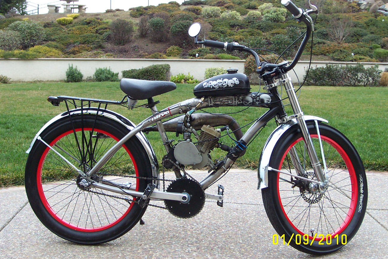

Glad to see someone using the jackshaft assembly!
The distance of the top sprocket of your jackshaft assembly should be 1/8" further from the frame than the lower sprocket. Most try to set them up the same distance usually doesn't work. Also try loosening the small top gear of the assembly and pull in the clutch
and roll the bike backwards 3 or 4 times ensuring the chain does not fall off then tighten the gear down. Keep both chains with little slack as possible. I been using one daily 6 or more miles to & from work for over a year. Also I changed the outside gear to 48t which works much better than the 42t that came with the kit.
