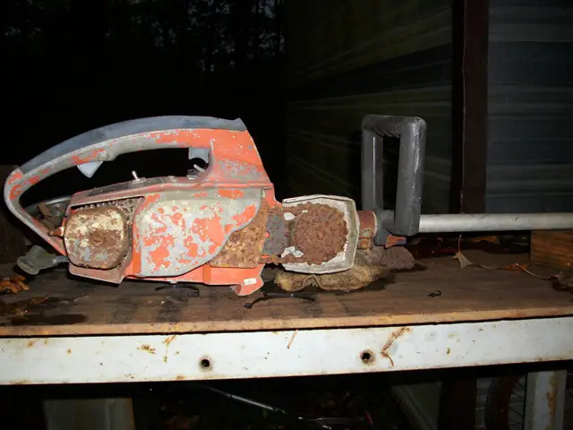

Use one of these and get the advantages of both. ha ha It is an old homelite.
Elmo
Elmo
