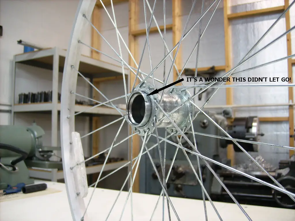

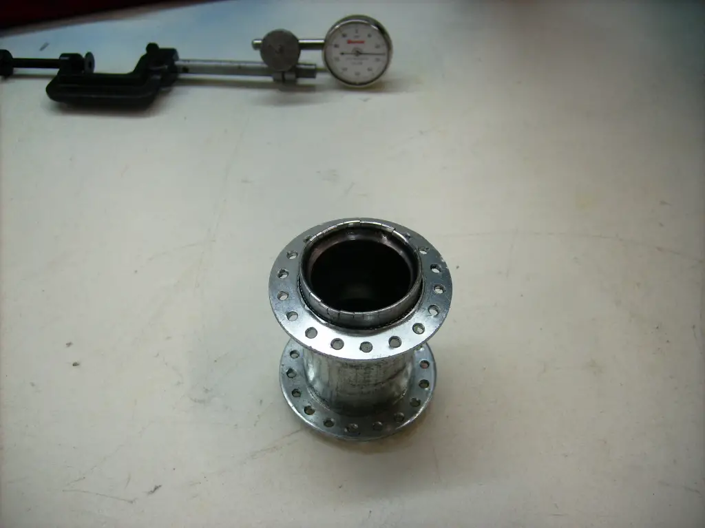

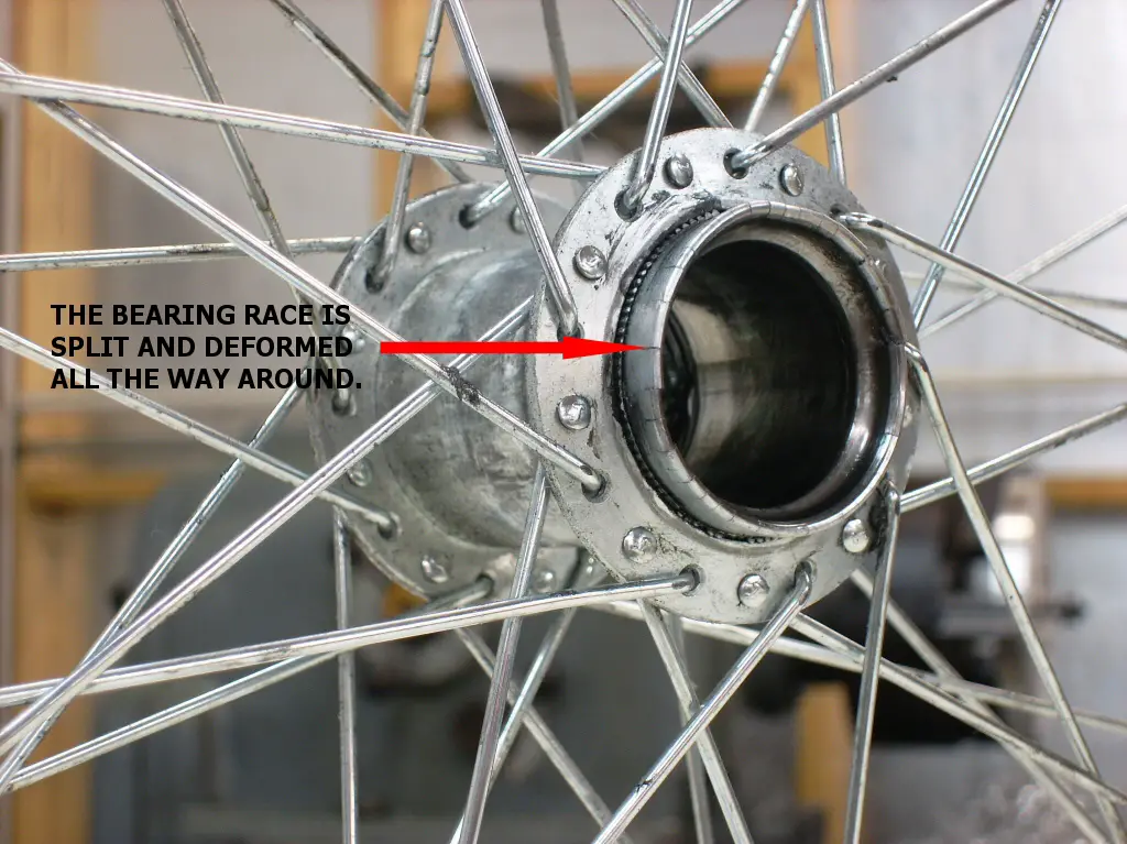

Part way through the second tank of fuel, and the rear wheel is loose again!!! I pulled it completely apart this time and found that the rear hub had split at the bearing race!
No curb jumping...no Dukes of hazzard...no Evil Knievel stunts...just easy break-in riding.

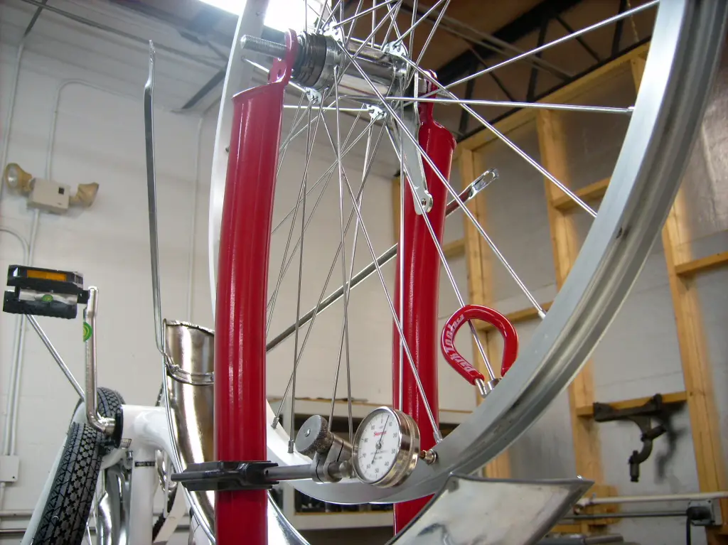

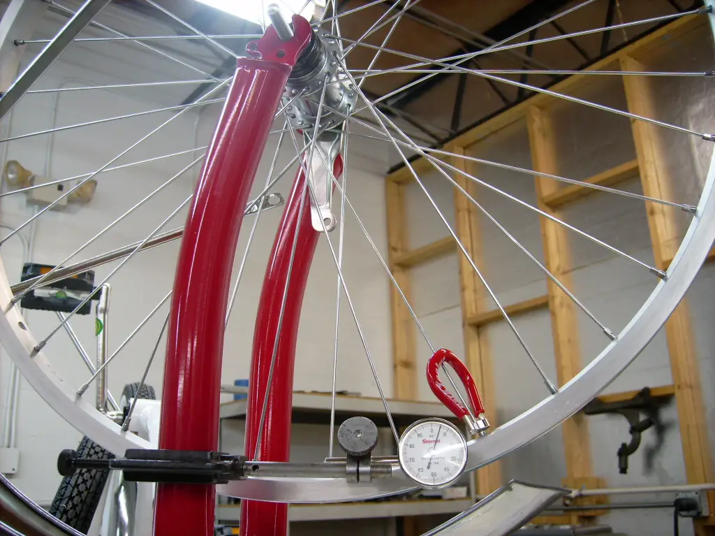

We went to the LBS and bought a new Shimano CB-110E hub, ($25.00), and re-laced the wheel. I put the other bike on the bench upside down and removed the front wheel so that I could use the forks as a truing stand. Yes I know the dial indicator is over-kill but it makes truing a breeze. It took about an hour and a half to disassemble the old wheel and re-lace the rim and spokes to the new hub. We saved $45.00, so it was worth it. btw...the CB-110 has a far superior brake.

Looks like the same wheel that the Huffy comes with and mine split too except mine had one long crack that went halfway around the race.
