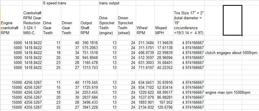

heres some math i did to try and maximize my mpg at the clutch engagement point of 5000rpm in top gear at ~40mph. look at the top speed in 6th gear at 15000rpm.. 120mph kinda crazy dont know if id ever go that fast but i might try it atleast once -Justin

Old 11-23-2009, 09:50 PM
DOC BOLM's Avatar
DOC BOLM DOC BOLM is offline
Join Date: Aug 2008
Location: Mississippi
Posts: 681
Default Re: Switching Teams... And not like that..
WHY do you want to go 100 on a moped.I own 6 mopeds,honda,kenetic,sachs.I dont want to go over 30 on them.They are very squirrelly at 35mph.But good luck with your build.H.D.
