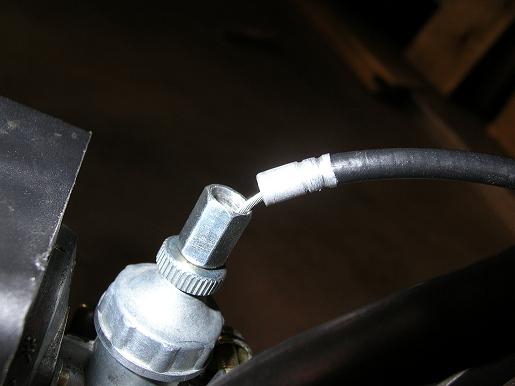

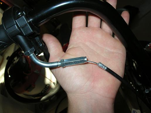

I was messing with it again and I think i got somewhere. I think
The first two pictures is what the cable looks like. How do I tighten it so It doesnt come out of the throttle housing when I twist the throttle.

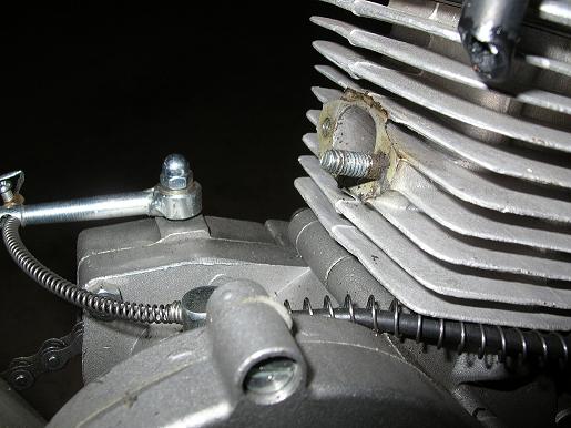

In the thrid picture, Is that where the slide is supposed to be when the throttle is not engaged??

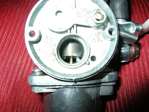

And the fourth picture. I took off the intake manifold and one of the rods didnt come out with the nut. How do I get it the rod out? or are the rods supposed to stay in the cylinder and I unscrewed the other rod by accident??

sounds like you have your throttle (twist handle part) assembled wrong, it has a stop built in, if you dont get it back together right the cable will be to long. The stud (threaded part)for the intake is supposed to stay in

It should go down until it bottoms or very close to the brass jet just below it, there is pin inside the carb barrel that aligns with a slot in the slide, do you have it right, if you have it right the slide should move freely,make sure its not sticking

In the third picture..thats how far it goes down. Is that normal??? and yeah everything is aligned up right..its smooth and doesnt stick.

It should go down further, It looks like the cable end is stopping it from going all the way down, it should be up in a slot on the bottom of slide

the rods are suposed to stay in.
