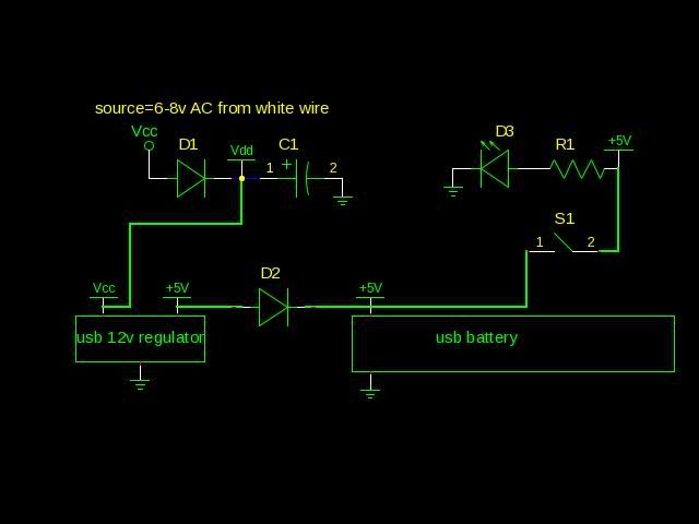

any news on this? I've been thinking about doing something similar. perhaps more people can chime in. Do you have a diagram?

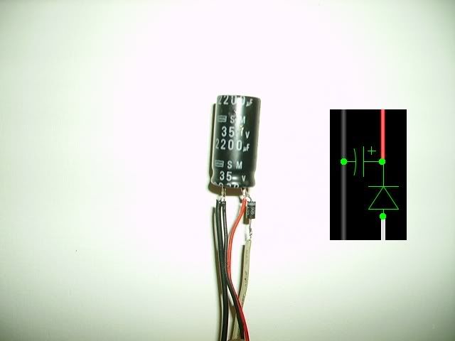

Full circuit is pretty straightforward if you are not afraid of a soldering iron and wiring up LEDs.
But anybody can just use the flashlight on a usb extension cord as a bullet light.

Can you post something easier to understand for us 'wiring diagram dummies'?

White wire through diode to positive lead of capacitor (negative of cap to ground). Positive lead of capacitor to 12V in of USB reg. 5V output of USB reg. through resistor to anode of LED. Cathode of LED to ground. Throw a switch in there to turn the lights off.
If your spark plug runs off the negative phase of magneto, should work fine.

I'm not sure why you need resistor and capacitor in there flashlights don't have em. Otherwise this is a series circuit with 2 sources regulated by the usb adapter (step down transformer). What's Vcc?

Get unregulated DC 5-10v to the red wire from magneto white wire through this.
Capacitor minimum of 16v, larger mf the better and bigger diode the better for least resistance.

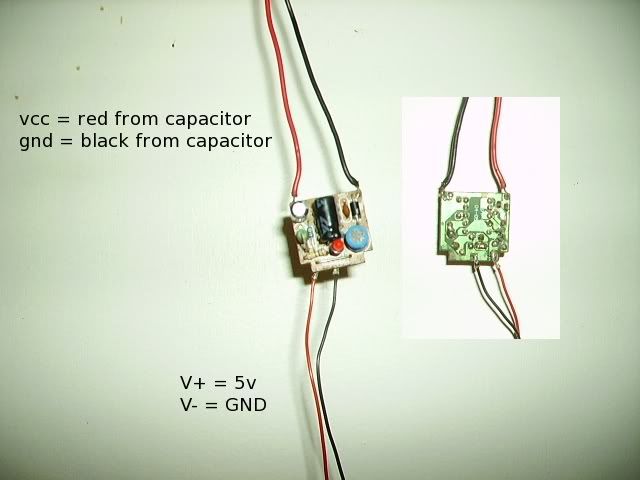

And here is the regulator scrounged from a cheap $5 ipod car plug.
