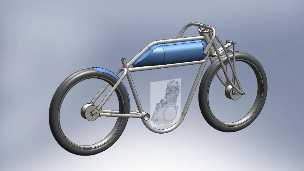

I'm starting to design a street legal vintage style board track racer. Time is hard to come by these days and the wife thinks I'm insane to even start a project like this, but I don't care if it takes me three years to finish it. For me most of the fun is in the building, the riding is simply the cherry on top. I'm starting to nail down proportions in Solidworks so it looks the way I want prior to bending any pipe. This is the easy part for me. The pace of the build will be painfully slow, I'm sure.
I'd really like to use 28" tires - I simply prefer their proportions to a 55" wheelbase, but with all this talk of clinchers coming off the rims due to low pressure I'm a little... hesitant. We'll see.
I have a Lifan 153FMG 100cc engine on order. It's small and has plenty of fins - maybe not the most authentic look, but I'm sure it'll do. Electrics for lighting and a clutch are a nice bonus.

Welcome and from what I can see on your solidworks drawing, nice start. I draw mostly in Autocad and the guy sitting next to me here at work is a solidworks guy. We were looking at your tank and have all the pieces figured out easily enough except for the front piece that looks pretty dished and may have to be hand formed. Hard to tell exactly from the rear 3/4 view, though. Anyway, the entire bike looks really nice. I am curious about the Lifan engine. You mention a clutch, but then what about a transmission? Keep us updated on the solidworks drawings until you start your build.

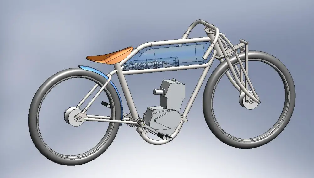

I made sure the tank would be easily welded together without much hand work. The front is made up of three flat sections that will be rolled with a 4" radius.

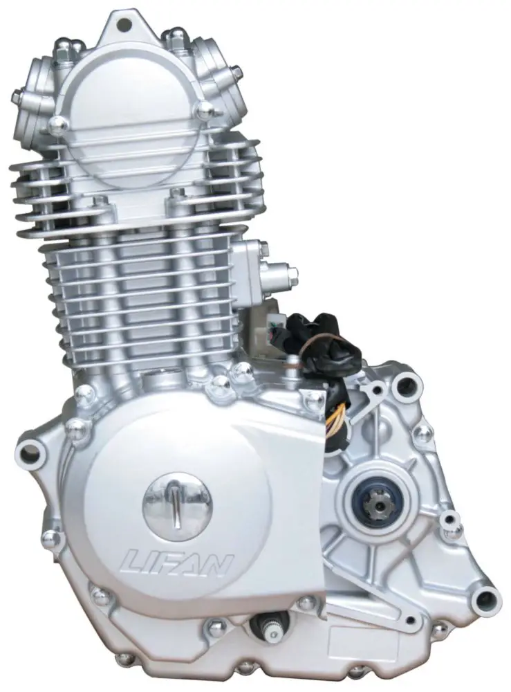

The Lifan 153FMG is a conventional motorcycle dirt/street engine with a kick start and 4 speed.

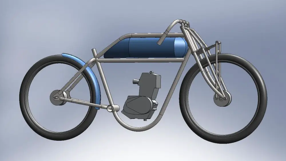

A little more progress. I've been tweaking the geometry for proper trail and rake numbers as well as a more proportioned look - the tank used to look a little large. Since this will be a street ridden machine, I couldn't bare the thought of dealing with pounded kidneys thanks to a hard tail. One rear shock from a standard twin shocked motorcycle should fit the bill. I'm also bent on being able to pedal and pedal start the engine. I've incorporated a hollow jack shaft with one way needle bearings inside of it for the pedal crank.
