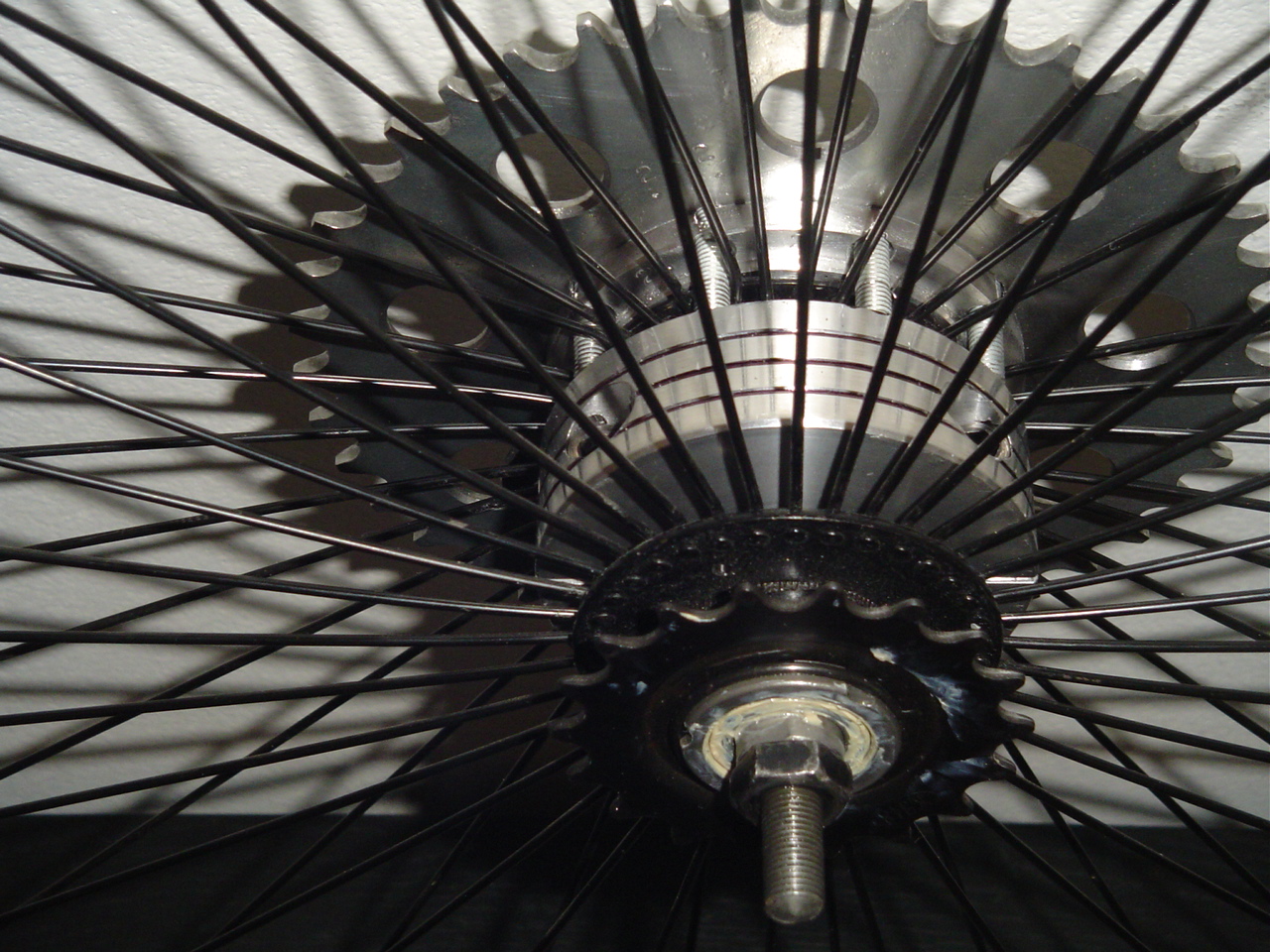

Wayne is right, math is the thing here since 68 is devisable by nothing as far as a hole pattern. I machined an adaptor to work but it was really time consuming, and you can see by the picture I still had to actually bend a couple spokes to clear the bolt pattern.
The old 36 spoke wheel is the best way to go although I will admit the 68's and 72's are pretty cool looking.
