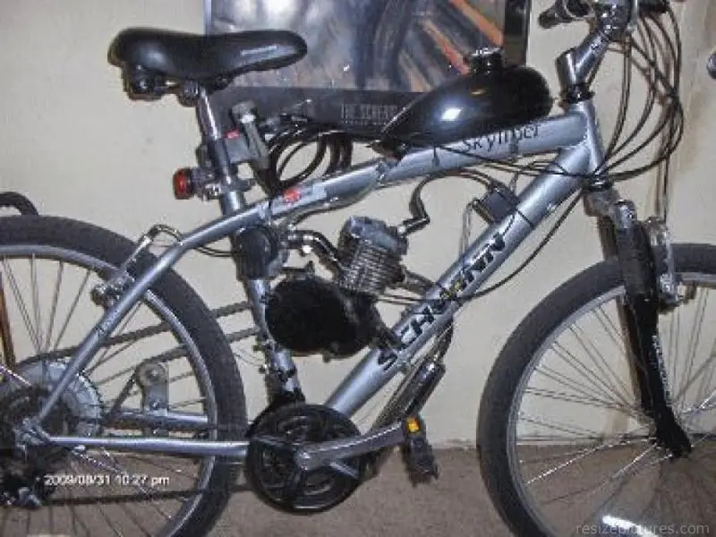

There are a number of successful aluminum bikes here. The Schwinn Point Beach is a good example. Many builders have had very good luck with the aluminum frames so don't be scared off by hearsay regarding their quality and strength. They might not take the abuse that a steel frame will but if you use common sense in your riding you'll be okay.

I concur with Tom.....my bike is an aluminum frame...solid as a rock and also bear in mind they resist corrosion ( you live in Maui ). And like Tom says just don't be doing anything on it that might cause issues with you or the bike.

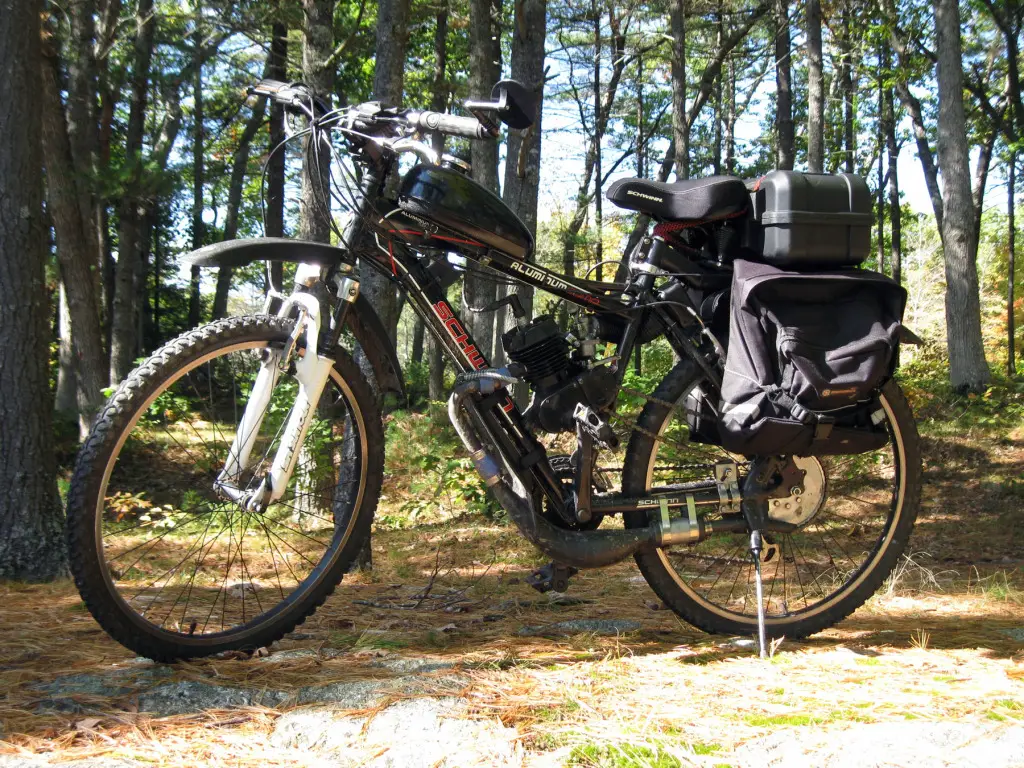

'Nother aluminum bike here
It's held up to my abuses far better than I anticipated, which is pretty impressive as I had high hopes to begin with lol I trail ride it a lot and ride every day, rain or shine - I even had a buddy wreck, sending the bike cartwheeling down the pavement and the frame was fine (wheels & handlebars were toast tho).
There is one thing to look out for with a motorized aluminum bike however and that's chafe. Because of the constant engine vibration, any unguarded contact points will wear quickly. You'll just need to pay a little more attention to where & how you route your cables and anything/everything that's attached to your frame should be snug & secure.
Which isn't such a bad idea anyway
