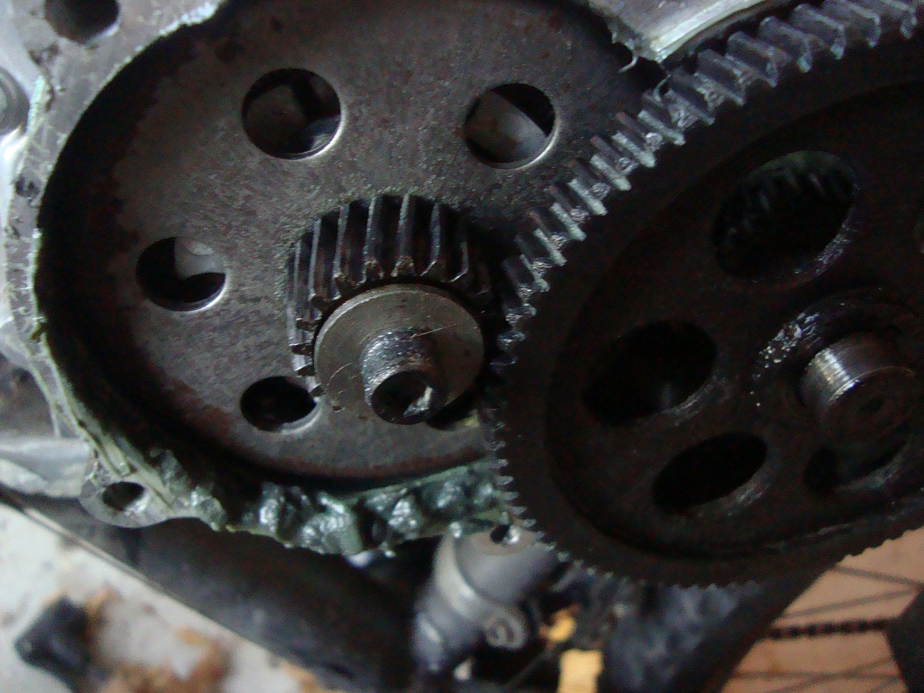

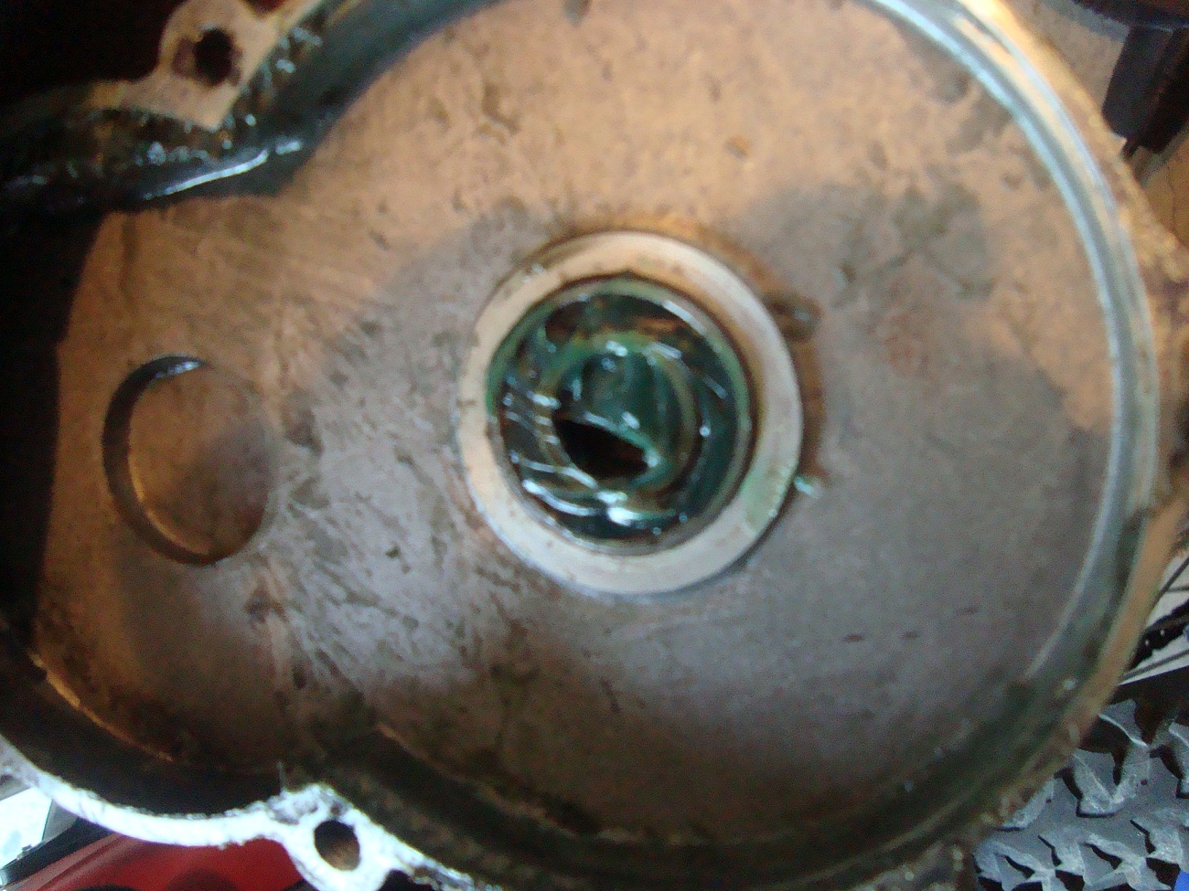

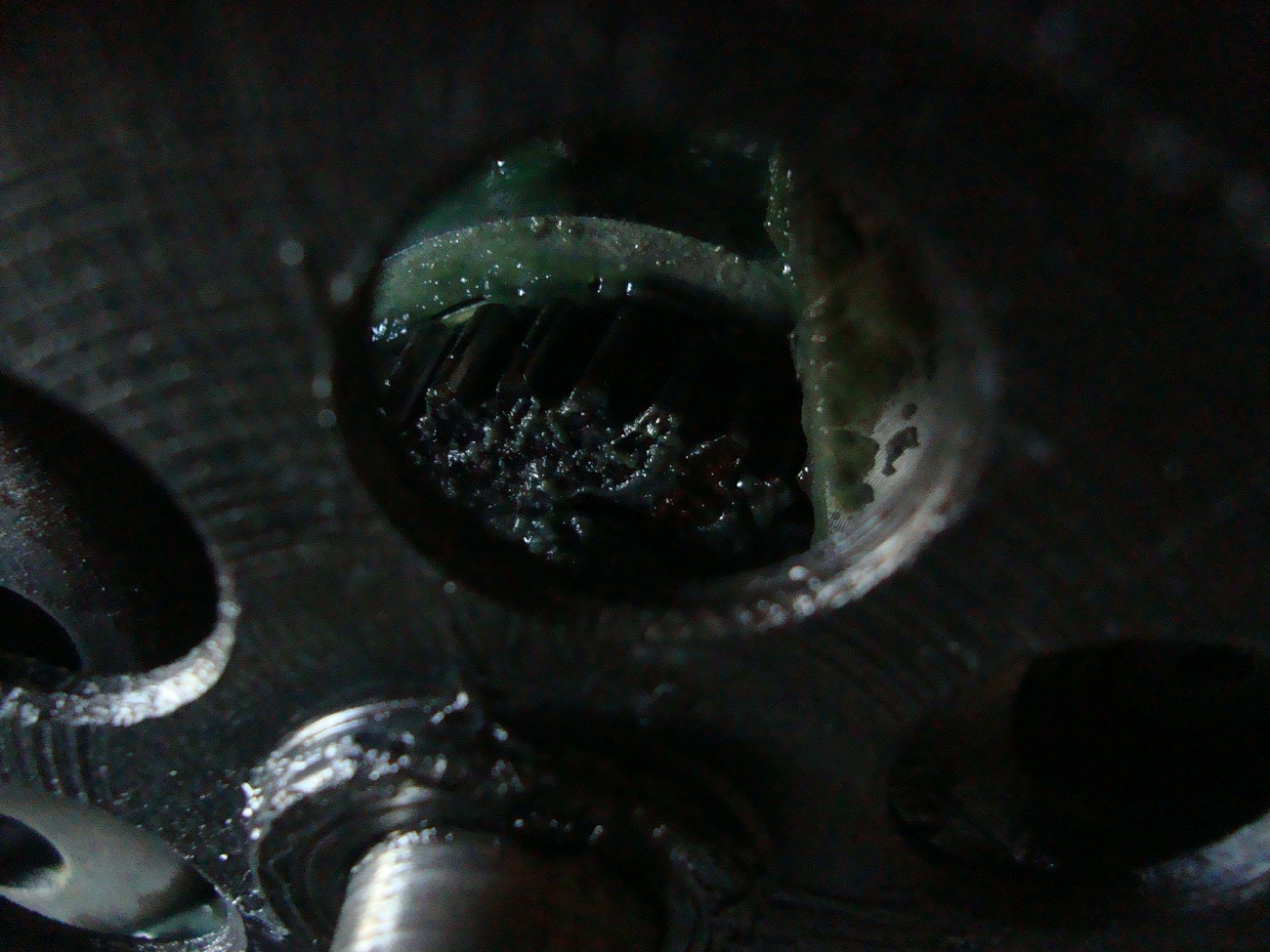

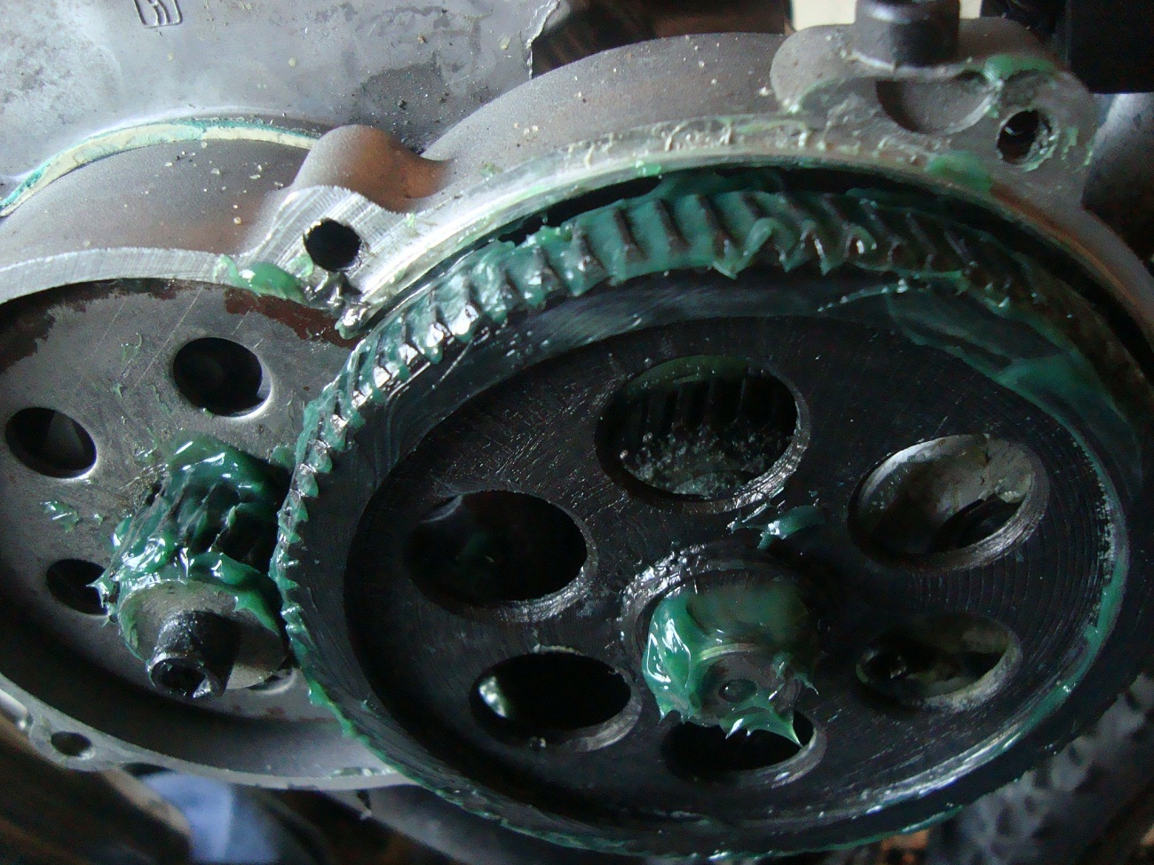

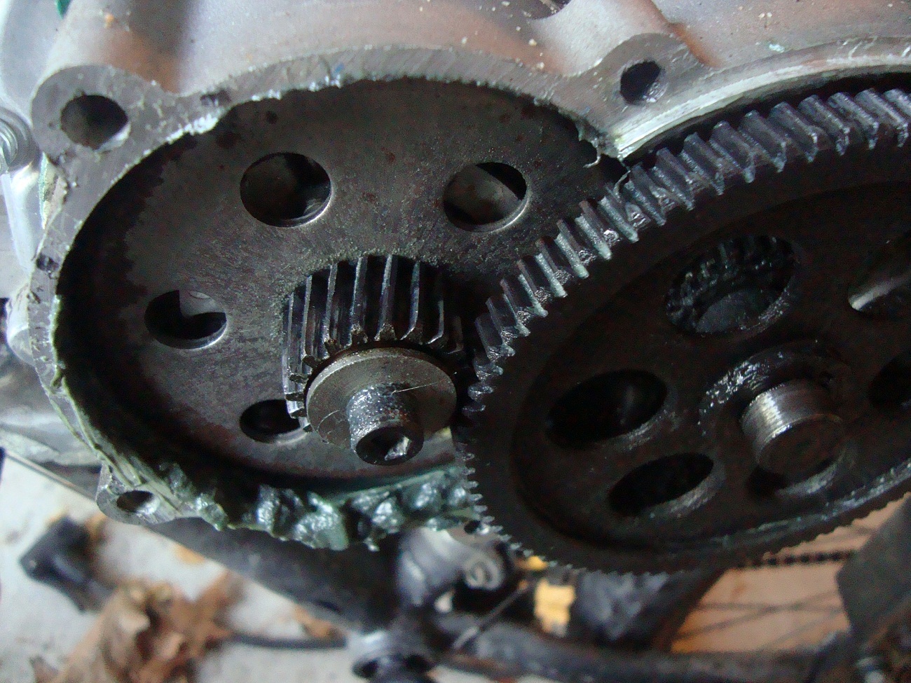

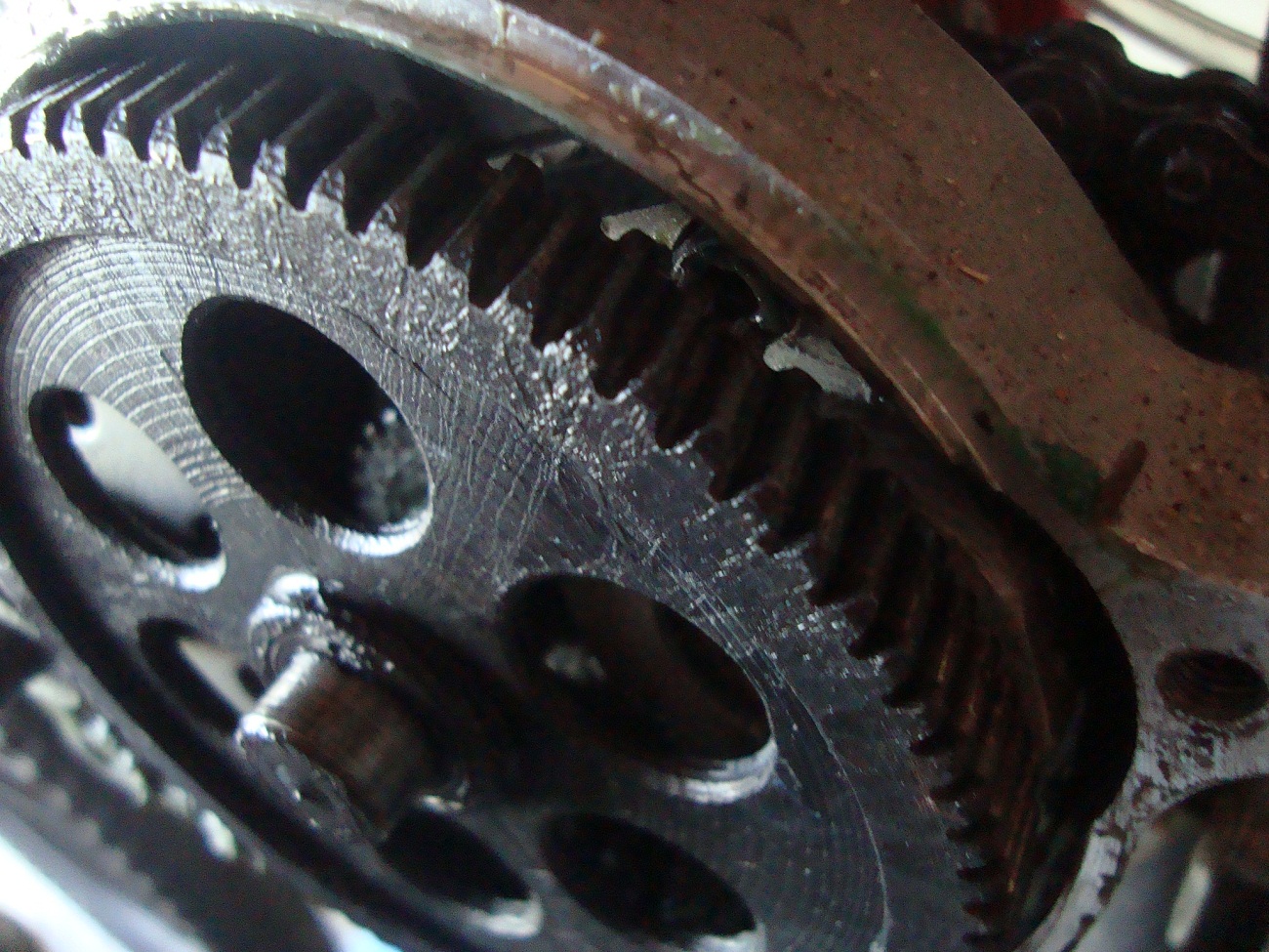

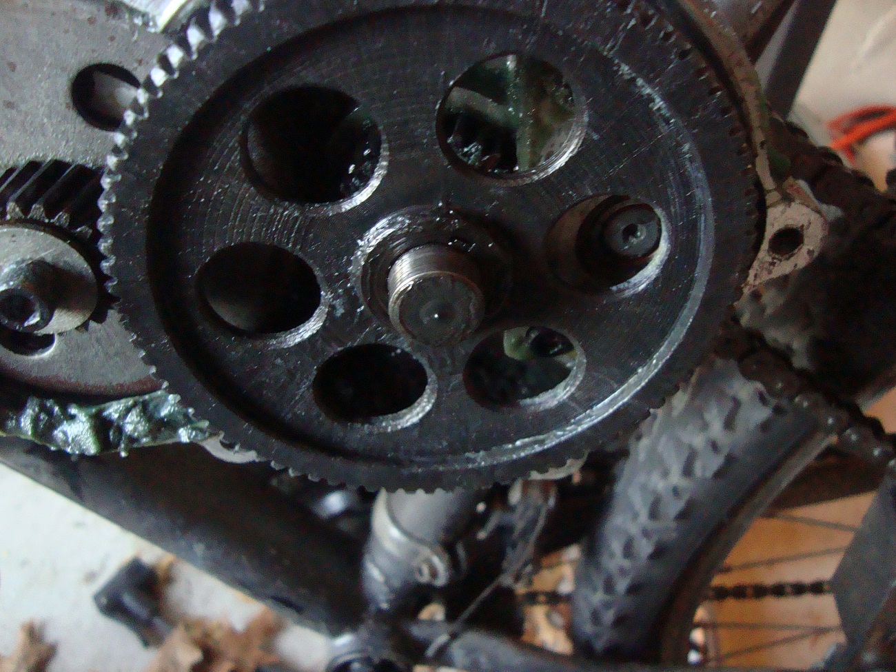

so far my hoot has about 600kms on it, im guessing thats pretty good, im still paranoid it will blow up at any moment but as far as i can see i dont see anything that can go wrong(besides stripping gear teeth, or the clutch etc.)
anyways, i experimented with diferent oils and greases, i found that white lithium grease broke down into a liquid and made the clutch slip, i have a few pictures i would like to show you, i greased my gearbox 2 days ago, and this is what it looks like after about 150kms of riding,

as you can see the grease is almost completely off the gears, but i see no visible wear on the teeth at all, they look perfect,

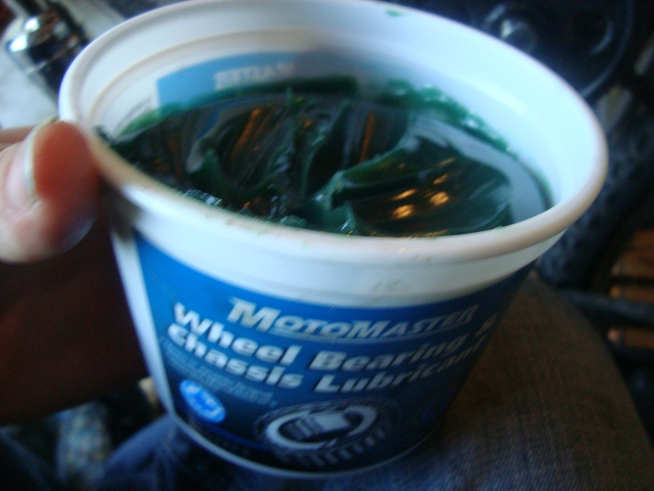

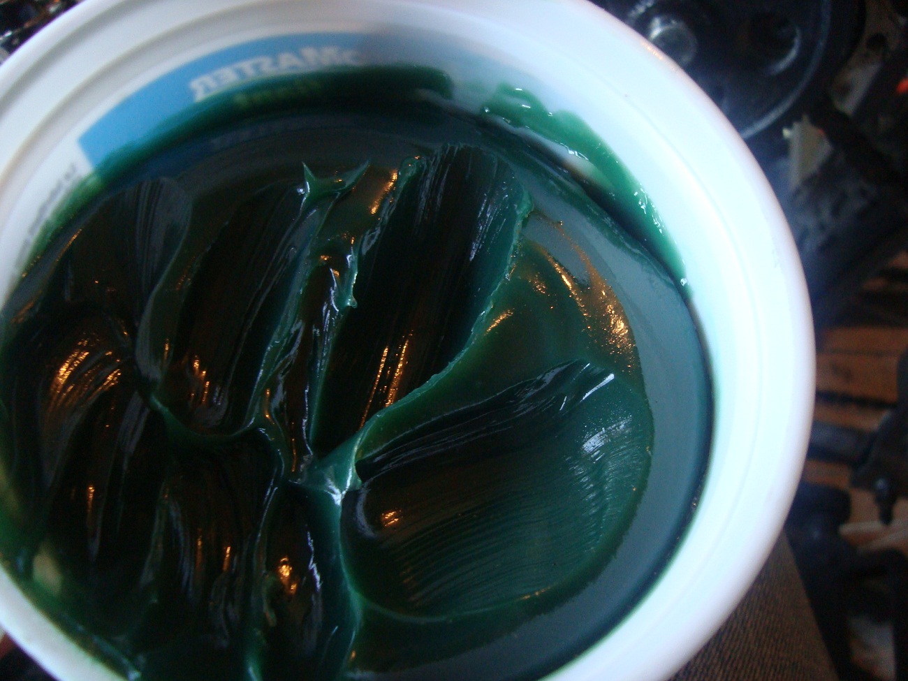

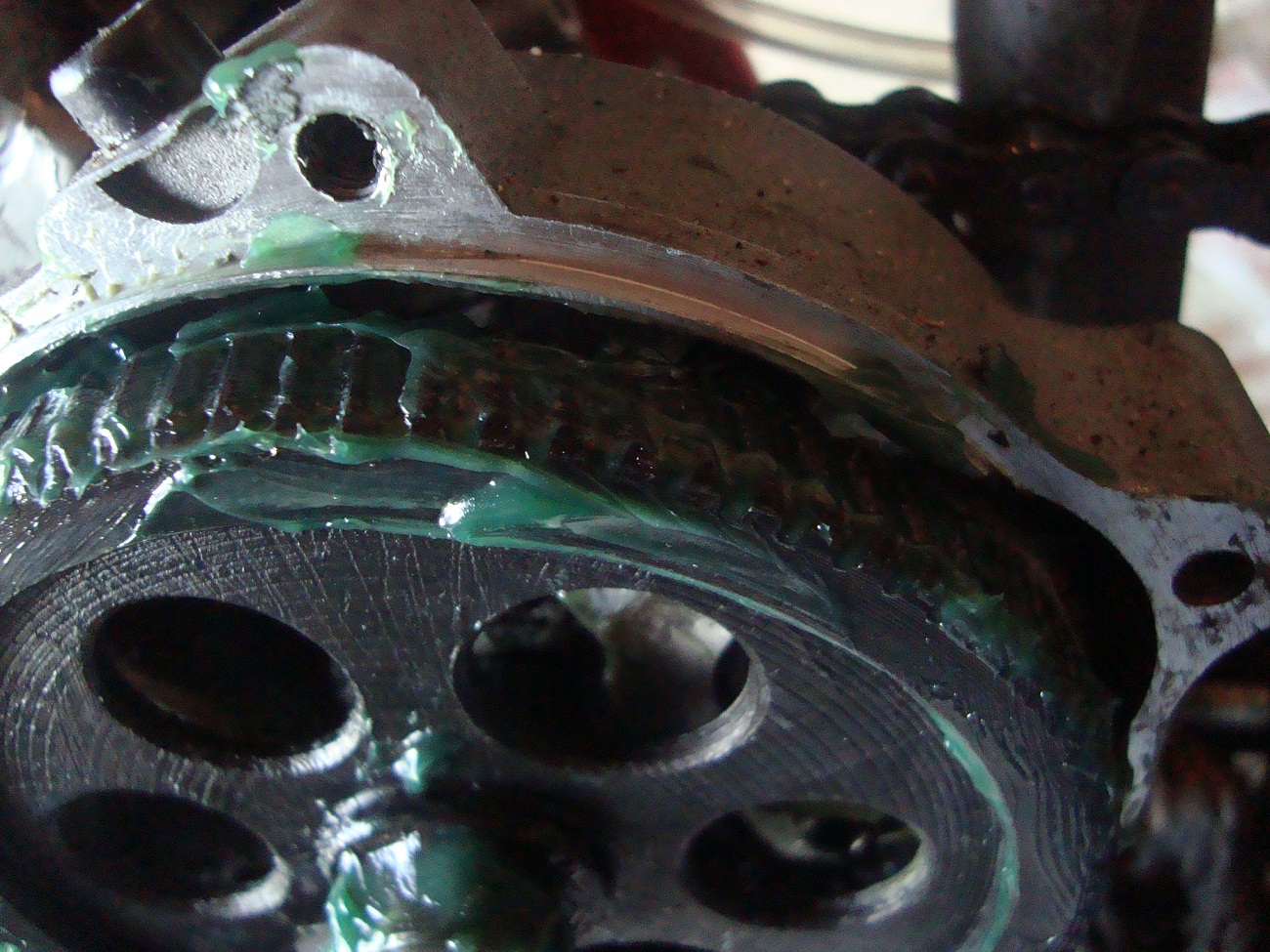

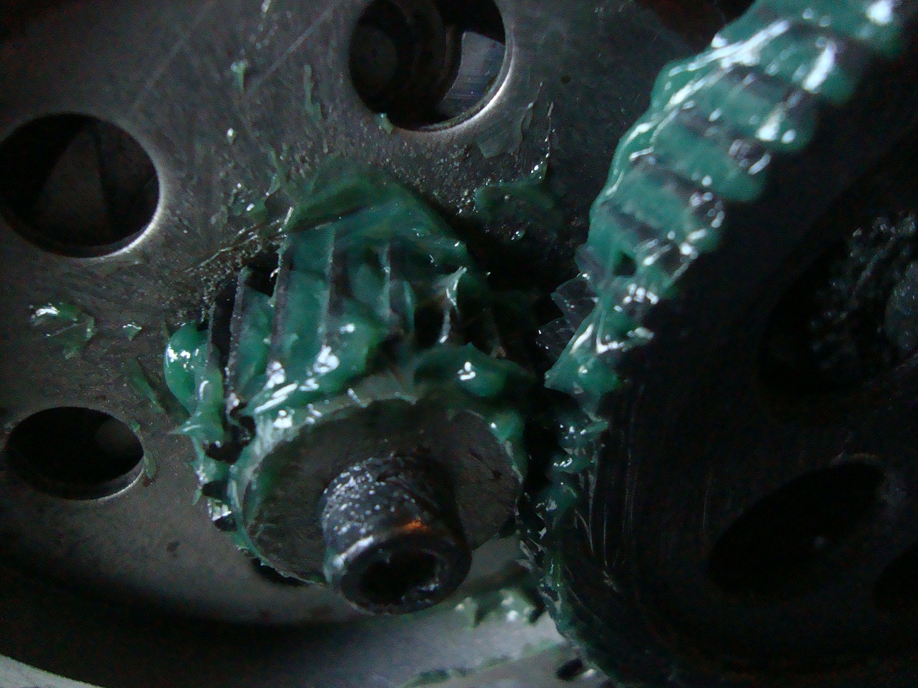

now this is how i grease it, i grease it every 2 days of heavy riding, or once a week if its lite duty riding, all in all it takes 15 minutes and i kinda enjoy working on it, here are pictures of the grease im using and my greasing methods

there was one more picture but i left it out, i grease the bearings in the cover,
anyways this is my method and it has been working so far, i am still saving to buy a better gearbox but for now this thing has to last! thanks and i hope you can implement this yourselves, who knows, maybe this is all the hoot needed?(lol i wish!)

I'm thinking if it has lasted past the initial "destruction period" for these, it may well keep on going and going an going...10000kms is just where I would consider a reasonable amount of mileage for such a set up.

Default Re: my hoot gearbox survival method!!
Excellent grease - use it all over the farm and on all of the bikes including the old old ones.
If there is no thrust bushing on the larger gear wheel you might want to add a thin wave washer on the outside stub shaft of the intermediate gear so it can not walk into the outside casing.
actually there is a bearing in the case, and the big gears shaft rests on it, here this is the pic i left out earlier, i grease the bearing there every 2 days also,
