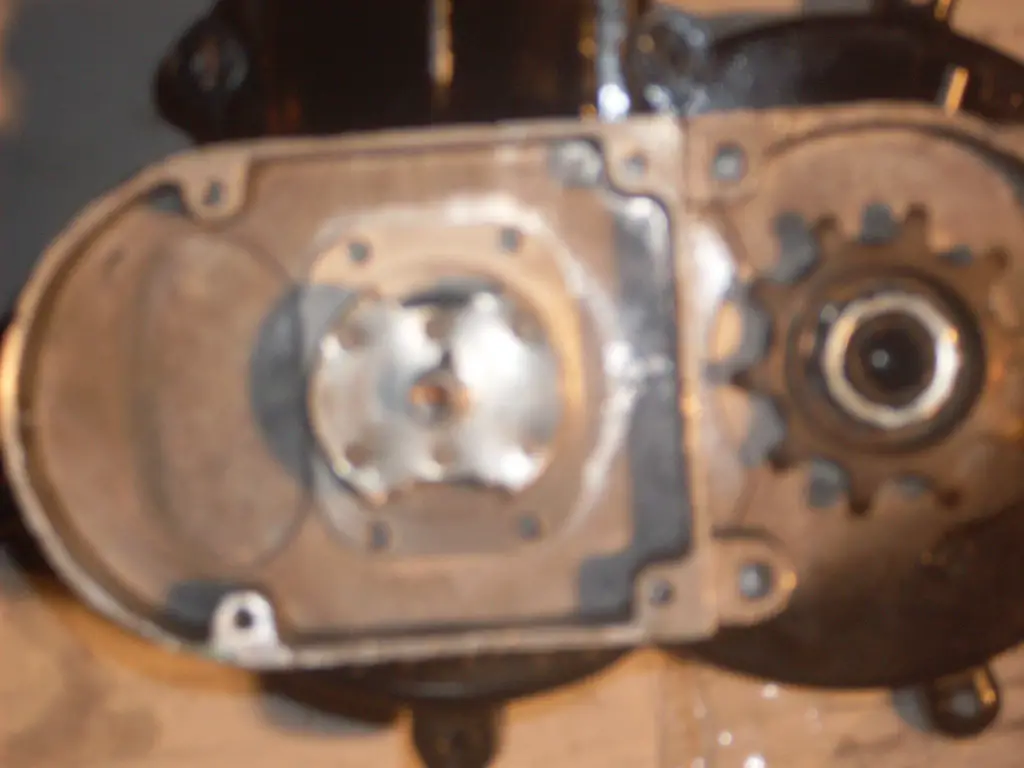

Yes Yes Yes
If you take the nut off the magnet.
Rotate the engine so the keyway in the magnet is at 12:00 o clock.
The keyway should lean toward sprocket.
It is cut on an angle.
The pic is a little blurry but you can see the keyway.
