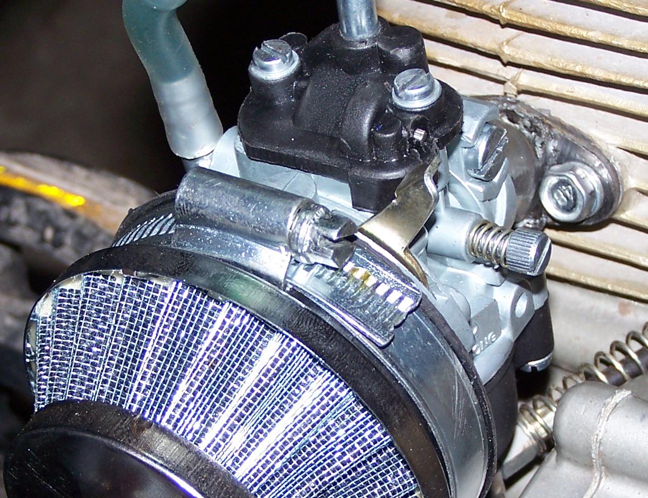

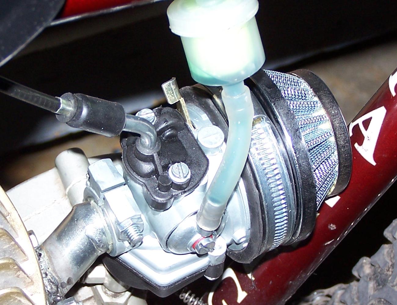

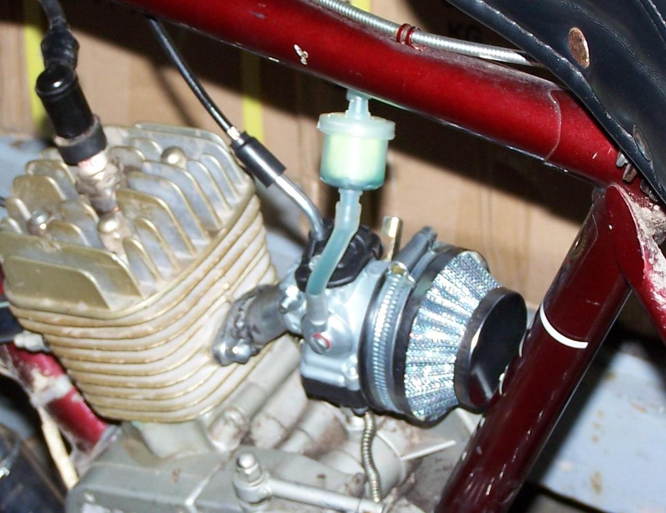

Hey guys I finished the conversion and install of a pocket bike carb on my bike today. all is running smooth with a slight difference in power, any tips on a way for me to get the most out of it?

It doesn't look like it's any more complicated (or different) to tune than a stock HT carb...

It doesn't, does it. I got in a shipment of these to try out, but I have not had much expereince with carbs, so I thought I would ask.

if yours is running better, then you berrer check your jetting. mine runs like a bag of **** and is lean lean lean.....

I would check for air leaks on that welded manifold it looks a bit suspect

Does it have any adjustment screws? Air bleed, or mixture type?
I does look different than the stock carb, but I can really tell what's going on there from the photos.

How many jets, or circuits does it have?

its a flatslide carb, with a single main jet that the pilot and idle circuits run off.
so, i dont imagine you can really drill it out, becaue you would have to in turn drill the pilo and idle holes as well. 3 holes, one jet.
i took it off. CNS is the way to go
