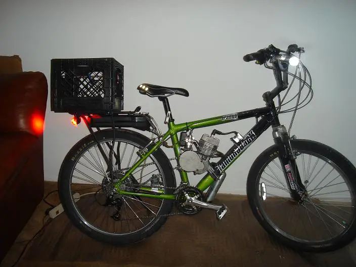

This Bike was donate to me by a co-worker after he found out the frame on other bike broke.
Result of front motor that was appeared tight but still managed to vibrate thru.
It was a very tight fit but with an hour or so of dremel work.
Had to widen the mouth of motor mounts.
I took my older motor port matched the intake and exhaust,
cleaned the carbon off the piston and ring.
Removed the cyl base gasket replaced with hi temp silicone.
Sanded the head down a few thousands on glass to keep it flat.
New style Carb for the 66.
I have to say I like the front suspension over the solid.
This is my daily driver and the old bike had close to 3500 miles before the frame went.
But the old motor is running better than every with the jug maintenance and the
slight mods I made thanks to the many that have shared.
Just enjoying the miles,
Homer

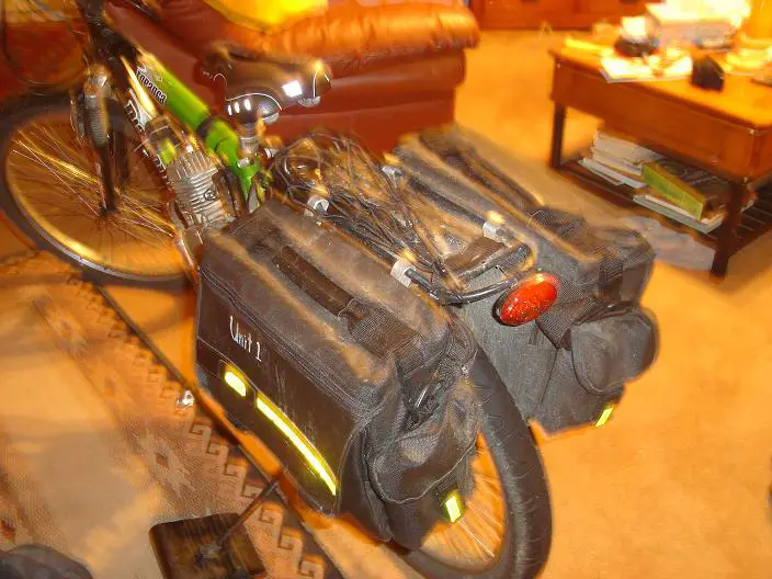

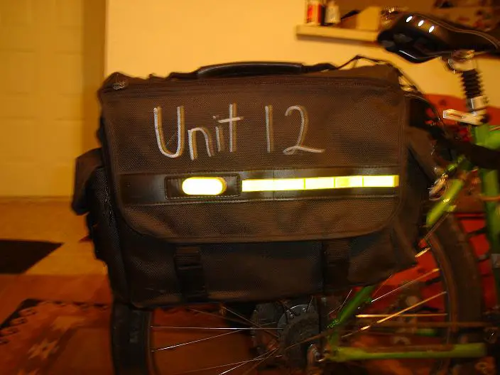

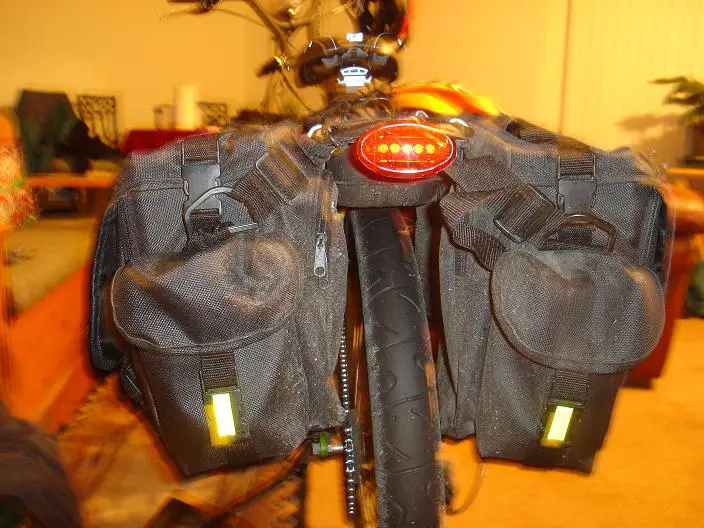

Added a few saddle bags to the rear rack. I picked up a set of sanyo camcorder bags, built an aluminum frame inside with hanger to attach them to the rack. I used a soldering iron to punch holes threw the nylon to keep it from tearing at the holes and attached the frame and hangers.
I gave up on the milk crate it was just to hard to swing my leg over.
Homer

[QUOTE=Homer;143650]Added a few saddle bags to the rear rack. I picked up a set of sanyo camcorder bags, built an aluminum frame inside with hanger to attach them to the rack. I used a soldering iron to punch holes threw the nylon to keep it from tearing at the holes and attached the frame and hangers.
Homer[/QUOTE
I like it...functional and yet looks nice. What kind of tire is that. Been trying to find one.
