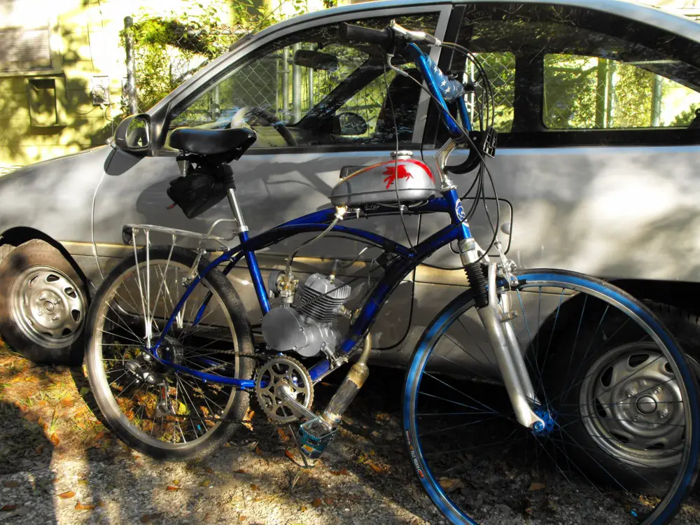

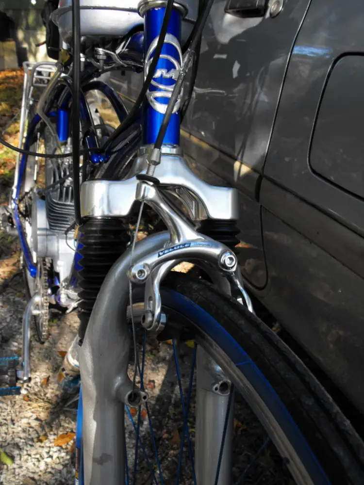

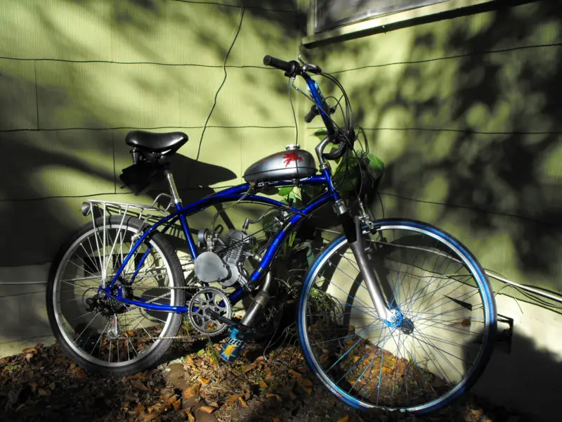

A few small holes drilled through the air cleaner cover helps air flow w/out exposing engine too much. A 36 sprocket bigger gear helps the cruise speed- that wide open throttle seems to be elusive for most people not changing carbs around- the new NTS carb at spooky and pistonbikes is promising, and cheaper than the "racing carb"
Got a HUGE surge just changing tires from heavy knobby cruiser tires to smooth 26 x 1.75- only 10 dollars each too, and the even put a 27 " wheel on the front- the rolling resistence is INCREDIBLY less, and the weight is too.
