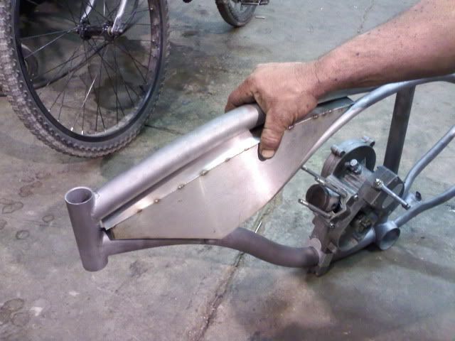

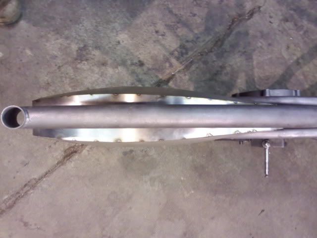

i have been tacking this thing together for carl as he builds each piece. he's been cutting each piece from an 18ga stainless condensate pan he found. the pieces fit so nice that i can purge the tank and fusion weld it.

looks clean, how are you gonna attach it to the tube?

i have no idea. maybe some brass straps or something. it's up to carl though. he also wants to mount the coil in there somewhere.

Foureasy, check this site Bung King

he'll probably machine something out of brass
