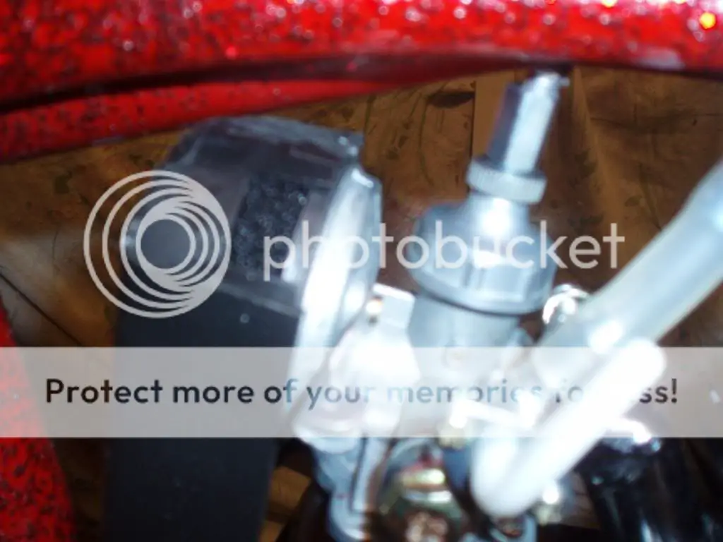

Originally Posted by DonnnN View Post
And also you should not ride your bike without an air filter you wouldn't know what could get sucked in and kill your engine.. Some of the guys here can help you fix that problem with the air fliter not clearing your frame..
This is what I did, talk about a tight fit and you can always do yours where you need it smaller, just a idea
