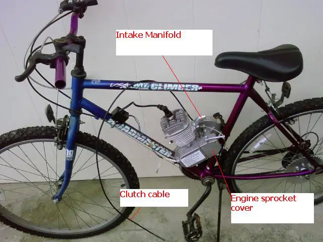

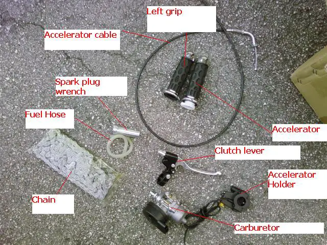

So I'm pretty new to this whole scene. I dont have much of a mechanical background and I got my kit yesterday from Dax. The kit didnt come with an instruction manual so I used the installation guide at thatsdax.com.
I was able to:
1. Do the wheel thing
2. mount the engine
3. put the sparkplug in the engine
4. connect the black tube to the spark plug and mount the little box thing
5. connect the blue to blue and black to black
I was unable to do:
Alot. Expecially the clutch lever stuff.
Please look at the photos below and tell me what to do next! I am utterly lost.
The first link is what I have so far
The second link are the parts with which I have no idea what to do with
Links:
http://i8.photobucket.com/albums/a11...1091547-00.jpg
http://i8.photobucket.com/albums/a11...1091549-00.jpg

Step 1: Let's identify your remaining parts. Please kindly refer to attached picture for identity of parts:
Step 2: Let's see which parts goes to where.
a) Carburetor - install this to that tube sticking out of the engine which is called the intake manifold. It's that tube where the opening is facing the seat tube.
b) Accelerator cable - this has two ends. The end that has a bent metal tubing goes to the the accelerator holder. The other end goes to the carburetor. You'll have to unscrew the cap of the carburetor and install the cable to the slider inside the carburetor.
c) Accelerator holder - The accelerator goes into the the accelerator holder. You'll have to unscrew the 2 halves of the accelerator holder. There is a small notch on the underside of the accelerator holder where you'll have to drill a hole on your handle bar to keep the accelerator holder in place.
d) Clutch lever - This goes on the left side of your handlebar, which means you'll have to either remove the left brake or put both brakes on the right, or sometimes the left brake is placed at the bottom of the clutcg lever. That loose cable that has a spring and is coming out of the engine is the clutch cable and the other end goes to the clutch lever, just like the brakes.
e) Fuel hose - This goes to the fuel tank and to the carburetor. Install your fuel tank first.
f) Spark plug wrench - This is a tool to tighten your spark plug, also used to remove the spark plug.
g) Chain - This is installed to the sprocket on the left side of the wheel. You'll have to remove the sprocket cover on the engine and put one end of the chain in the sprocket. Turn the sprocket on the engine using the spark plug wrench slowly making sure the chain is not getting stuck while you insert it.
h) Left Grip - install this on the left side of your handlebar.
I don't see a chain tensioner on your frame. You might need it depending on the frame. Otherwise, you might have remove some links from your chain to make it fit...
Try installing all the necessary parts first, then we'll go to adjustment...
Hope this helps...

Ok, I think I've got it all down except for a couple things.
1. I got the accelerator cable to go accelerator (putting the "bead" at the end of the cable into the handle and putting the handle into the slot in the accelerator holder, right?), but I dont exactly know where to put it in the carburetor.
2. There are some electric wires coming out of the accelerator holder which I dont know where to put
3. Is there any mantinence check I should do on the carbuerator before I put gas into the tank?
4. The Clutch cable has two springs. I have the small one suspended and locked between two metal things on the motor (which I think is right judging from pics of other ppl's). However, what do I do with the big spring? Currently it is just idly hanging on the black rubber portion of the clutch cable.
Thanks so much in advance
I'll try and give it a shot
1. (Mine was pre-assembled) Unscrew the large top off the carb (Has ridges on it like a checker) The cable goes into the barell shaped part with the slot down one side and has a spot for the end to seat in the needle is under all this be gentle putting it back in aligning the slot with the notch inside the carb.
2. the 2 wires coming off the throttle handle are the kill switch best to go one blue the other black or ground to engine block. It can be left off until later you can stop the engine by engaging the clutch come to a full stop and let the clutch out to kill it.
3. Just mix gas and 2 cycle oil as per instructions...bear in mind your engine will increase in power alot after a few tanks of gas when the rings seat don't baby it but don't dog it either.
4. You have the large spring where it goes it should ride on the cable next to engine for heat shield the other is for return of the clutch between the standoff and the clutch actuator arm...I took mine off there is plenty of return spring inside the clutch.
