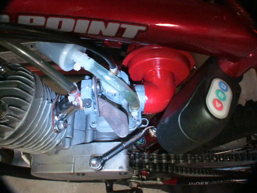

I added a short piece of copper on to my stock arm, and swiveled it inward on the splines. It makes the pull much easier.
